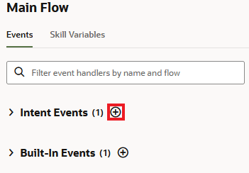

If you have already defined a flow and now need to map an intent to it, here's how you map the intent:
- On the Flows page, in the list of flows, select Main Flow.
- Click
in the Intent Events section.

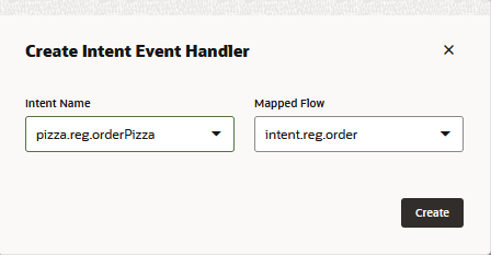

- In the Create Intent Event Handler dialog, select the intent
name and mapped flow, and then click
Create

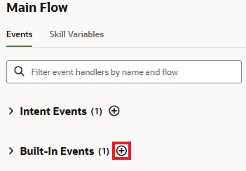

Map a Built-In Event to a Flow
- Select Main Flow.
- Click
in the Built-In Events section.

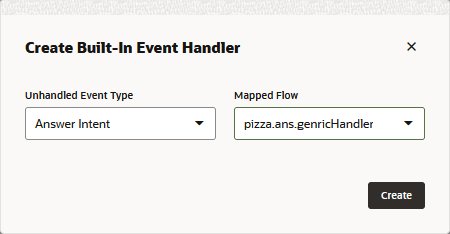

- In the Create Built-In Event Handler dialog, select the event type from
the and mapped flow, and click Create.
