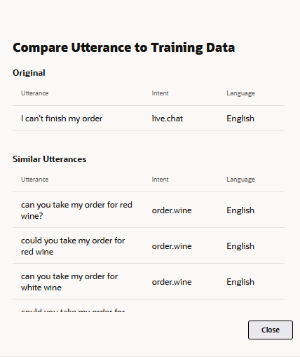

To find out where (or if) an utterance belongs in your training set, click View Similar in the list to view it in the Similar Utterance report.
Description of anomalies_list.png follows
Like the Similar Utterances report used in the Utterance Tester, this report ranks the other utterances in the training set relative to the selected utterance. In this case, however, the utterance isn't a test phrase, but an anomalous utterance that's already in the training set.
Description of similar_utterance_report_anomalies.png follows
Based on the anomaly's relationship to the other utterances in the report, you may find that the utterance is simply misclassified or not pertinent to the skill at all. Other anomalies, however, may only be anomalous to the other utterances in that they are implicit requests – they are asking the same questions as the other training data, but in a different way. For example, "I can't log into my account" might be evaluated as an anomaly for an agent transfer intent whose training utterances cluster around more straightforward requests like "I need to talk to a live agent." Adding similar utterances will add depth to the model.
