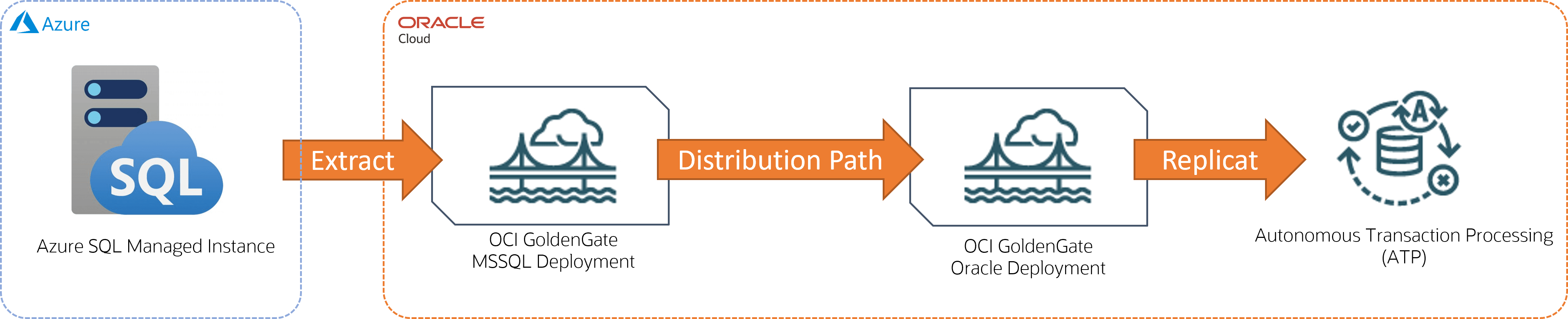

Example: Azure SQL Managed Instance to Autonomous AI Transaction Processing
In this example, Azure SQL Managed Instance is the source technology and Autonomous AI Transaction Processing (ATP) is the target.
Description of azure-atp.png follows
For this replication scenario, you need:
  • Two deployments:
    • A Microsoft SQL Server deployment for the source database
    • An Oracle deployment for the target database
  • Connections:
    • A connection to Azure SQL Managed Instance, and then assigned to the Microsoft SQL Server deployment
    • A connection to Autonomous AI Transaction Processing, and then assigned to the Oracle deployment
    • If your target deployment doesn't have a public endpoint, create an Oracle GoldenGate connection and then assign it to the source deployment.
  • Processes:
    • An Extract process created in the source deployment
    • A Distribution Path created in the source deployment
    • A Replicat created in the target deployment
This replication scenario is available as quickstart.

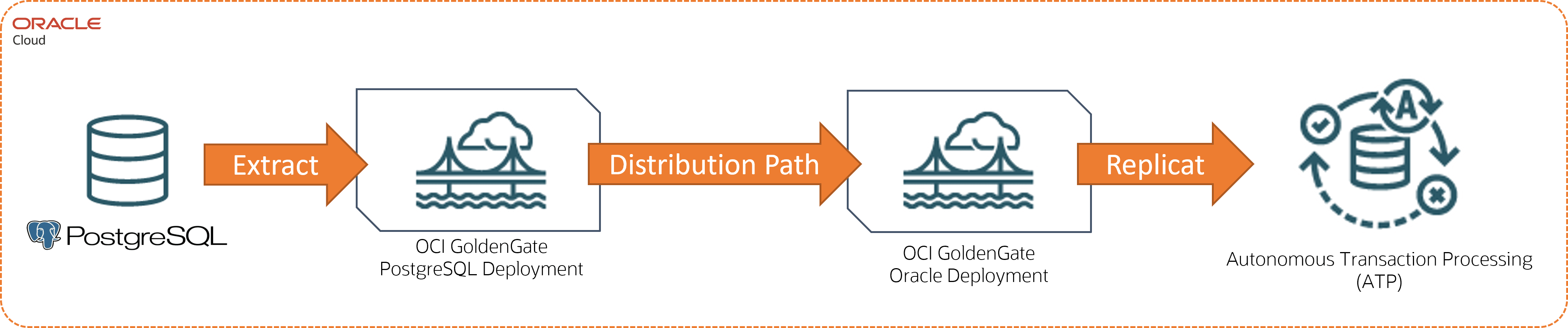

Example: PostgreSQL to Autonomous AI Transaction Processing
In this example, PostgreSQL is the source technology and Autonomous AI Transaction Processing (ATP) is the target.
Description of postgres-atp.png follows
  • Two deployments:
    • A PostgresSQL deployment for the source database
    • An Oracle deployment for the target technology
  • Connections:
    • A connection to PostgreSQL, and then assigned to the PostgreSQL deployment
  • Processes:
This replication scenario is available as a quickstart.
