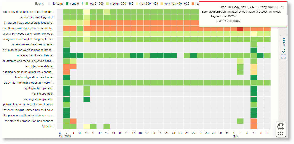

Time is plotted along the y-axis of the chart. Along x-axis, the field which is the input to the
timestats
command is plotted, for example, Log Source. Each rectangle along a row represents the count of log records for a slot of time. The color of the rectangle represents the range in which the count belongs. The ranges are displayed at the top of the chart. Hover your cursor over the rectangles to view the values corresponding to them. To drill down further on s specific set of log records represented by a rectangle, click on it. The number of rectangles in a row is determined by the time range selected for the analysis. For example, if the selected time range is Last 60 Minutes, then each row has 60 rectangles corresponding to each minute of the time range.Additionally, a time series table is also displayed below the heat map chart. Each row of the table corresponds to a rectangle in a row in the chart.
You can change the colors displayed in the chart by clicking the Color under Display Options. Select the color palette that best suits the requirement. For example, if the higher ranges indicate warnings and errors as in case of Severity or Problem Priority, then use the palette that has red for the higher ranges. On the other hand, if the lower values are of concern as in case of Memory Available, then use the palette that has red for the lower ranges.
In the following heat map, the one red rectangle which represents the highest range clearly indicates that the occurrence of events are more than usual in a specific time slot:
