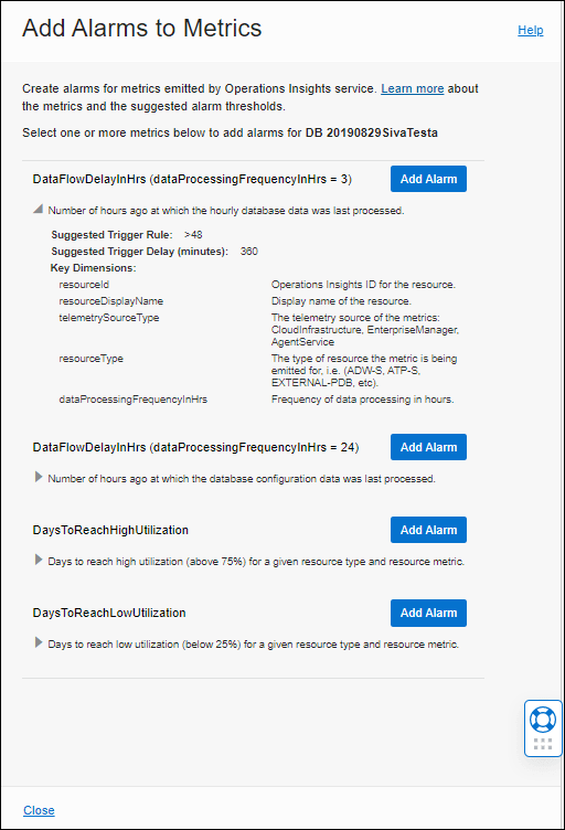

Ops Insights provides convenient access to Monitoring service's alarm creation functionality directly from any fleet resource page.
- From the left pane, click Administration.
- Click on a fleet resource. (Database Fleet, Host Fleet, Exadata Fleet, Ops Insights Warehouse).
- Click on the Action menu (vertical ellipses) for a specific resource and select Add Alarms. The Add Alarms to Metrics region displays. Expand the description region below each metric to view suggested trigger parameters as well as key dimensions.
- Click Add Alarm. You'll be taken to the Monitoring service Create Alarm page with the required metric details already populated.

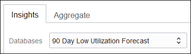

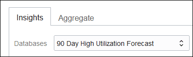

The forecast metrics are generated using at most 100 days of history data and forecast window of 90 days. You can verify the forecast from Ops Insights console by selecting 1 year in the Time Range Filter and High or Low utilization for 90 days, as shown below.
![Time range selector Time range selector](img/opsi_time_range.png)
![90 day high utilization 90 day high utilization](img/opsi_util1.png)
![90 day low utilization 90 day low utilization](img/opsi_util2.png)
