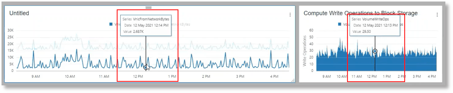

    • Legend: You can specify the location of the legend as Top, Bottom, Left, Right, or None. If you have multiple metrics in the visualization, then you can hover on the legend of a specific metric to emphasize that data in the combined chart.
    • Correlated tooltips: If you want to correlate the tooltips across all your metric widgets in the dashboard, then check this box.
    • Stacked: If you have multiple metrics in the visualization, and you want to stack the two charts for better viewing, then check this box.
