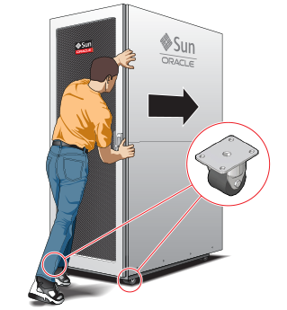

  3. Push the system from the back of the rack to the installation site.
    Attention
    Never attempt to move the rack by pushing on the rack side panels. Pushing on the rack side panels can tip over the rack. This action can cause serious personal injury or death, as well as damage to the equipment.
    The front casters of the rack are fixed; they do not pivot. When moving the appliance rack to the installation site, you must steer the unit using the rear casters. You can safely maneuver the system by carefully pushing it from behind.
    Figure showing the appliance rack being pushed from the back.
    It is preferred that at least three people push and guide the rack: one person in front and two persons in back to help guide the rack and keep people out of the path of the moving rack. When transporting configured racks from one location to another, take care to move them slowly, 0.65 meters per second (2.13 feet per second) or slower.

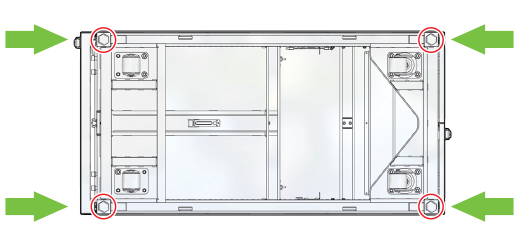

  1. Locate the four leveling feet at the bottom four corners of the rack.
    This figure shows the location of the leveling feet on the rack.

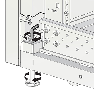

  2. Using a 6mm hex wrench, lower the leveling feet to the floor.
    This figure shows the leveling feet being lowered with a hex wrench.

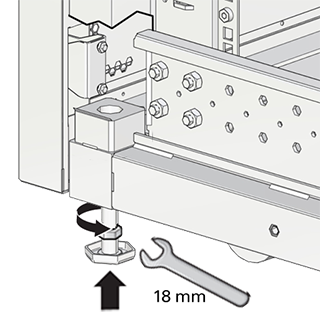

  3. Lock the four leveling feet using an 18mm open wrench.
    This figure shows the leveling feet being locked in place with an open wrench.

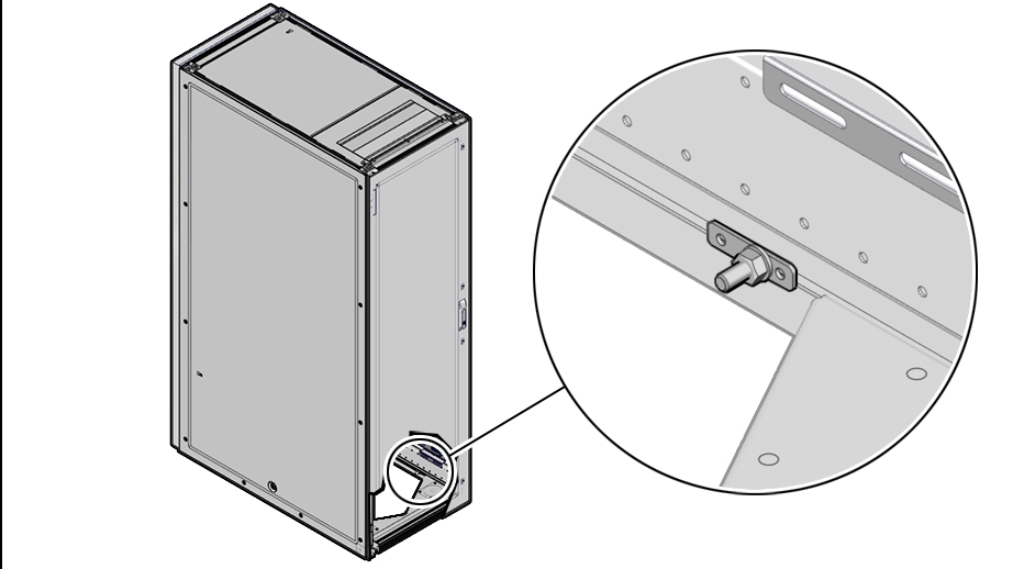

  4. Attach the ground cable to one of the attachment points located at the bottom rear of the system frame. The attachment point is an adjustable bolt that is inside the rear of the system cabinet on the right side.
    Figure showing the earth ground attachment location on the rack.
