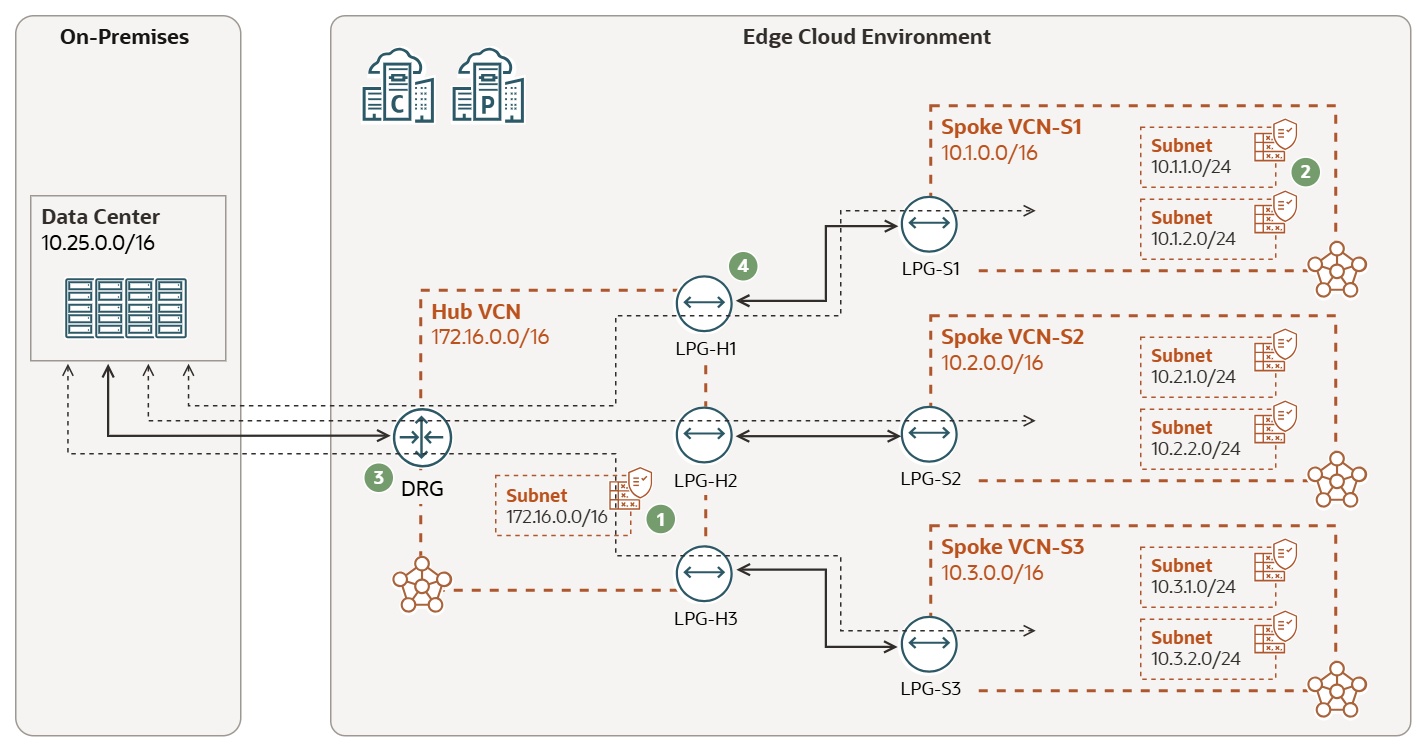

Routing Paths in Detail
To further illustrate how transit routing takes place, the different paths of traffic are displayed in the diagram, and described in detail below.
Figure showing transit routing in a hub and spoke VCN topology. Callouts indicate where route tables are added.
The callouts in the diagram indicate the route tables to be added for this configuration. The route rules required in this example are listed in the table that follows.

Traffic from the on-premises network to the spoke VCN
  1. Traffic leaves the on-premises network and reaches the DRG. The traffic's destination is in Subnet-1 of VCN-S1, for example: 10.1.1.5.
  2. The DRG attachment's associated route table has a rule for 10.1.0.0/16. It matches the destination and sends the traffic to the route target: LPG-H1.
  3. LPG-H1 receives the traffic.
    Egress traffic leaving a VCN through an LPG is automatically routed to the LPG's peered LPG, which is LPG-S1 in this situation. That routing occurs automatically because of the peering connection between the two LPGs.
  4. LPG-S1 receives the traffic.
    Traffic coming in to a VCN through the LPG is automatically routed to the destination within the VCN because of VCN local routing. No explicit route rules are required.
Traffic from the spoke VCN to the on-premises network
  1. Traffic comes from an instance in Subnet-1 of spoke VCN-S1. The traffic's destination is in the on-premises network, for example: 10.25.112.17.
  2. Subnet-1's associated route table has a rule for 10.25.0.0/16. It matches the destination and sends the traffic to the route target: LPG-S1.
  3. LPG-S1 receives the traffic.
    Egress traffic leaving a VCN through an LPG is automatically routed to the LPG's peered LPG, which is LPG-H1 in this situation. That routing occurs automatically because of the peering connection between the two LPGs.
  4. LPG-H1 receives the traffic.
    LPG-H1's associated route table has a rule for 10.25.0.0/16. It matches the destination and sends the traffic to the route target: the hub VCN's DRG.
  5. The DRG receives the traffic.
    Egress traffic leaving a VCN through the DRG is automatically routed to the destination in the connected on-premises network. No explicit route rules in the DRG attachment's route table are required.
Subnet-1 in the spoke VCN and LPG-H1 both have route rules with 10.25.0.0/16 as the destination CIDR. Those rules are not required to use the exact same CIDR block, but you must ensure that both rules cover the traffic you want to route from the spoke to the on-premises network. The rule in Subnet-1's route table controls which traffic is routed from Subnet-1 to LPG-H1. The rule in LPG-H1's route table controls which traffic is routed from the spoke VCN to the on-premises network. If LPG-H1's route rule is more restrictive than Subnet-1's route rule, some traffic leaving the subnet could be dropped and not reach the DRG.
Traffic from the spoke VCN to a subnet in the hub VCN
Depending on your situation, you might want to enable traffic between instances in the hub VCN and a spoke VCN, in addition to the traffic between the on-premises network and a spoke VCN. This is possible as long as routing only occurs directly between gateways, and not through a private IP in the hub VCN.
This is how traffic would flow from the spoke VCN to a destination with an address in the hub VCN:
  1. Traffic comes from an instance in Subnet-1 of spoke VCN-S1. The traffic's destination is in HubSubnet-A of the hub VCN, for example: 172.16.2.85.
  2. Subnet-1's associated route table has a rule for 172.16.0.0/16. It matches the destination and sends the traffic to the route target: LPG-S1.
A similar series of routing steps occurs for traffic going from HubSubnet-A to Subnet-1, but in the reverse direction. HubSubnet-A's route table has a rule that matches the spoke VCN's CIDR (10.1.0.0/16) and sends the traffic to LPG-H1, which forwards it on to LPG-S1.
