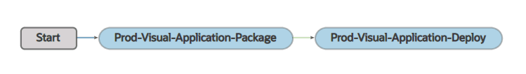

Create and Configure a Pipeline
To ensure the production deployment job runs automatically after the production packaging job, create a pipeline and set the dependency.
Run the Pipeline
When you're ready to deploy the visual application to the production instance, run the production pipeline.
