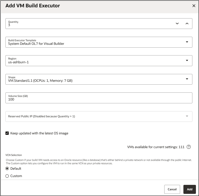

- When you add a VM executor manually, you must specify the executor template, choose an OCI region from the connected OCI account's subscribed regions, specify the OCI Compute VM's shape, and select the VCN (optional).
- Your OCI account may have some Compute instance limits set. When you
add a VM executor, VB Studio looks into the specified OCI region's Availability Domains, finds available OCPUs
with the specified shape, calculates the number of Compute instances, and displays
the number of Compute VM instances you can add from your OCI account's set limit.
Here's an example of the VB Studio's Add VM Build Executors dialog box that displays the number of VM executors you can add with the VM.Standard.1.1 shape:
- When you add a VM executor, it is added in the Pending state and doesn't cost you
anything. You can add more VM executors than the number of available Compute VM instances.
Remember, VB Studio creates a Compute VM instance when a VM executor starts, not when you add it.
