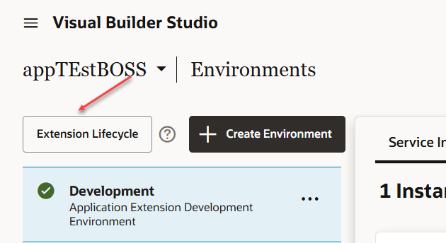

- Define a new environment. The easiest way is to go to the
Environments tab in the VB Studio left navigator, then click
Extension Lifecycle:

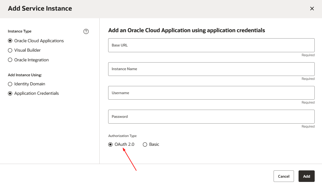

If you use the + Create Environment button instead, be sure to select OAuth 2.0 under Authorization Type:
Regardless of the method you choose, enter the base URL, the name by which you want to refer to the instance, and the credentials of a user authorized to deploy to the instance. These credentials must be those of a local user, not a federated identity, and must not require multi-factor authentication. Once the instance is connected, these credentials are discarded; they're needed only to set up the initial OAuth-based connection. - Back in the Designer, press the Publish button to commit the changes you made in the extension to the Git repository in VB Studio.
