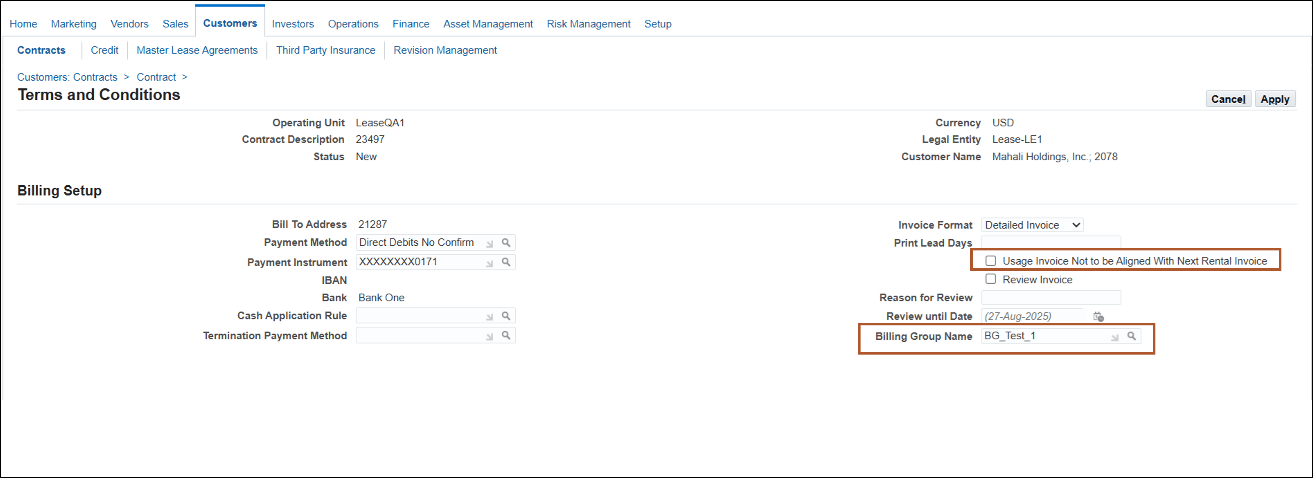

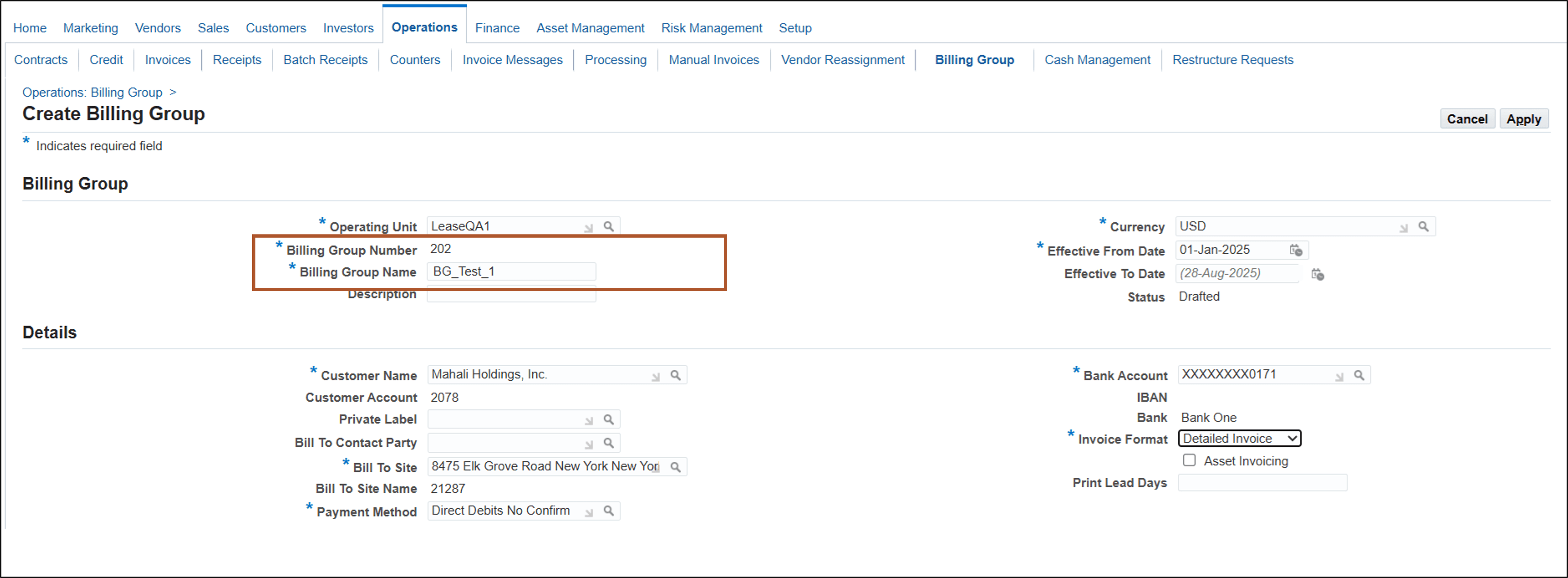

  1. Create and activate a Billing Group for a customer.
  2. Create a lease contract for the customer and add assets and usage.
  3. Assign Billing Group Name to the contract or asset billing setup terms and conditions.
  4. Ensure that Usage Invoice Not to be Aligned with Next Rental Invoice is not selected.

Create Billing Group
Assign Billing Group to Contract

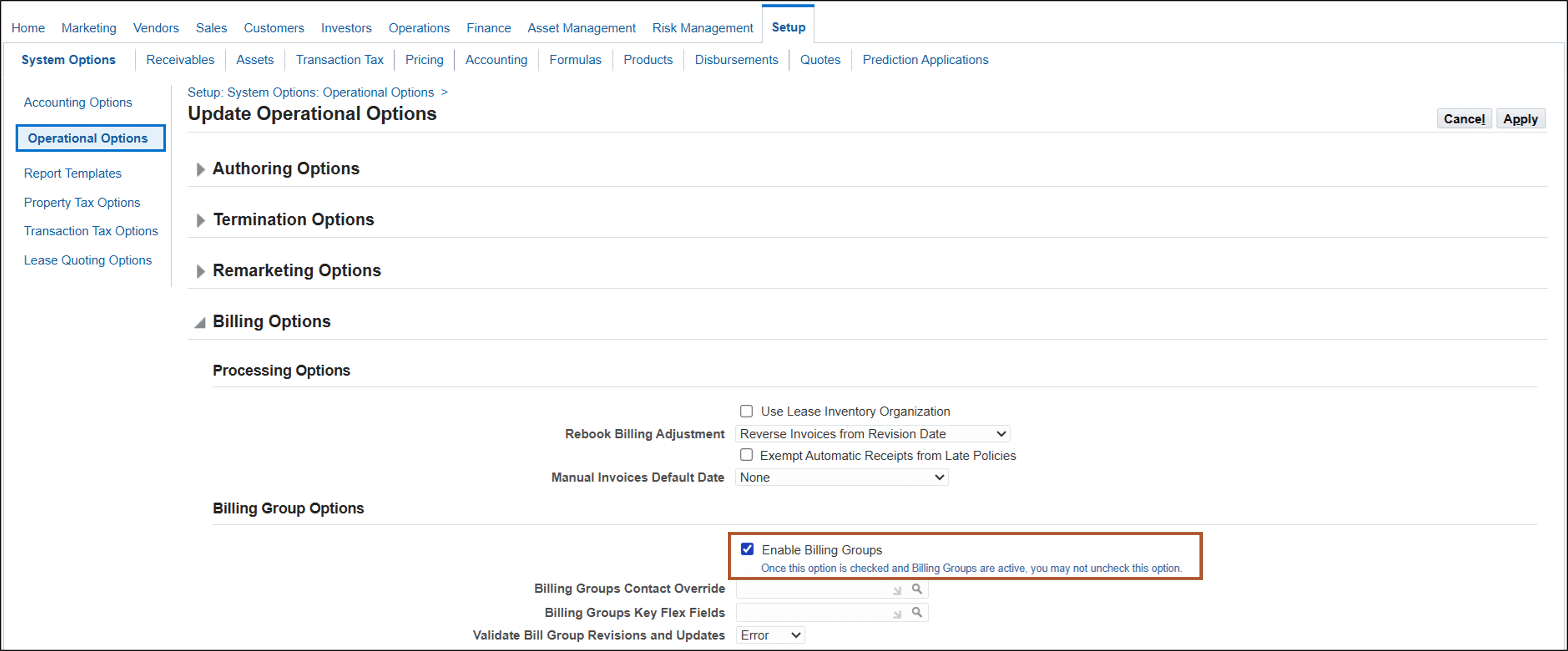

Steps to enable and configure
To enable Billing Groups:
  1. Navigate to Setup > System Options > Operational Options
    • Enable Billing Groups system option.
