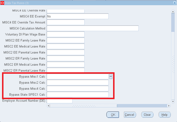

You may configure the following new fields at GRE level in the State Tax Rules (3) descriptive flexfield (DFF) for the applicable state to prevent unwanted miscellaneous type tax calculation and wage accumulation. Using the applicable HRMS Manager responsibility, navigate to Work Structures > Organization > Description > query the applicable organization (GRE) > click in GRE/Legal Entity > Others > State Tax Rules (3) > Select the applicable state and then optionally update the following new fields:
  • Use “Bypass Misc1 Calc” for State MISC1 wages (Oregon STT and Vermont CCC tax)
  • Use “Bypass Misc2 Calc” for State MISC2 (PFML)  tax
  • Use “Bypass Misc4 Calc” for State MISC4 (WA Cares) tax
  • Use ‘Bypass State SPEC1 Calc” for State SPEC1 (Portland Metro SHS) tax
State Tax Rules (3) DFF at GRE level showing new Bypass fields

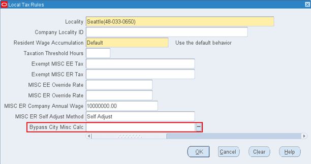

Additionally, you may configure new field Bypass City Misc Calc at GRE level.  Using the applicable HRMS Manager responsibility, navigate to Work Structures > Organization > Description > query the applicable organization (GRE) > click in GRE/Legal Entity > Others > Local Tax Rules > Select the applicable locality (currently this is only applicable to Eugene, Oregon and Seattle, Washington).
Local Tax Rules DFF at GRE level showing new Bypass City Misc field

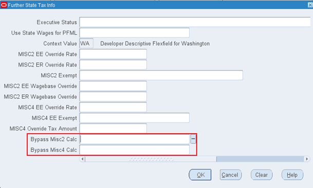

You may also configure the following new fields at employee assignment level to prevent unwanted State miscellaneous wage accumulation by navigating to People > Enter and Maintain > query the applicable employee > Assignment > Tax Info > select the applicable state > Click in the Further State Tax Info DF ellipsis. (Note that the available fields may differ depending on the state selected. In this case, the state of Washington has been selected.)
  • Use “Bypass Misc2 Calc” for State MISC2 (PFML) wages
Bypass Fields in Employee Assignment > State Tax Info > Further State Tax Info DFF

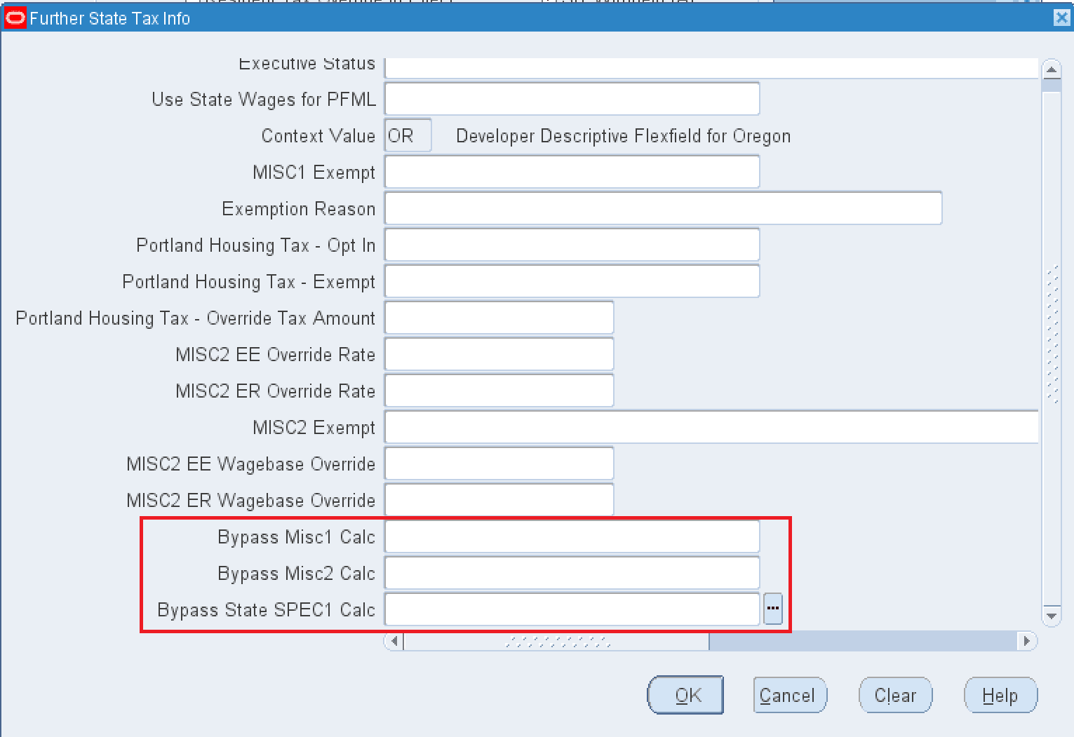

Additional bypass fields are also available at the employee assignment level if the state of Oregon is selected. Navigate to People > Enter and Maintain > query the applicable employee > Assignment > Tax Info > select the applicable state (in this example Oregon) > Click in the Further State Tax Info DF ellipsis.
  • Bypass Misc1 Calc for either Oregon Statewide Transit Tax (STT) (or Vermont Child Care Contribution (CCC) tax)
  • Bypass Misc2 Calc for State MISC2 (PFML) wages
  • Bypass State SPEC1 Calc for Portland Metro Supportive Housing Services (SHS) tax
Bypass fields available in Further State Tax Info DFF at assignment level for the State of Oregon

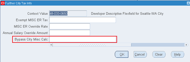

You may also configure the following new field at employee assignment level to prevent unwanted City miscellaneous wage accumulation by navigating to People > Enter and Maintain > query the applicable employee > Assignment > Tax Info > select the applicable state > select the applicable county > select the applicable city > Click in the Further City Tax Info DF ellipsis:
  • Use “Bypass City Misc Calc” field
Bypass City Misc field in Local Tax Rules at Employee Assignment level

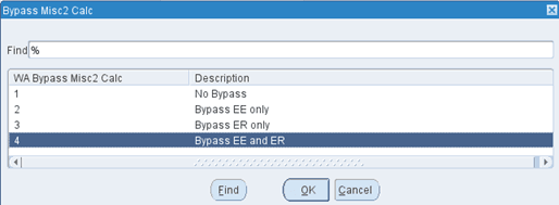

For each the above fields, you may select from the following options. (Note that not all of these options may apply to every Bypass field at either level.)
  1. No Bypass: This is the default option. The applicable Miscellaneous state or city tax will be processed as normal with no bypass occurring.
  2. Bypass EE Only: Select this option to only bypass the calculation of the employee component of the applicable miscellaneous tax, and no employee miscellaneous wages for the applicable tax type will accumulate. The employer tax component will still be processed (where applicable), and the employer-level wages will still be accumulated (where applicable).
  3. Bypass ER Only: Select this option to only bypass the calculation of the employer component of the applicable miscellaneous tax, and no employer miscellaneous wages for the applicable tax type will accumulate. The employee tax component will still be processed (where applicable), and the employee-level wages will still be accumulated (where applicable).
  4. Bypass EE and ER: Select this option to bypass calculation/processing of BOTH employee and employer miscellaneous tax components. NO miscellaneous wages for the applicable tax type will be accumulated for employee or employer.
Bypass Field Selection Options
