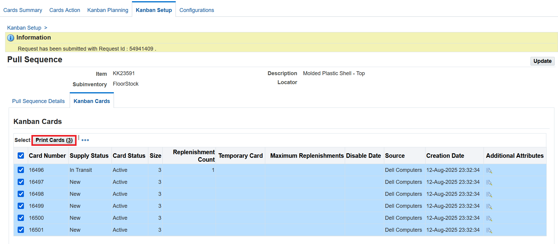

In the Kanban Setup page, you can view the Pull Sequence. You can navigate to the Kanban Cards tab and click on Print Cards to print Kanban cards.
Kanban Setup page > View Pull Sequence > Kanban Cards tab - Click Print Cards button
Kanban Setup page - Kanban Cards

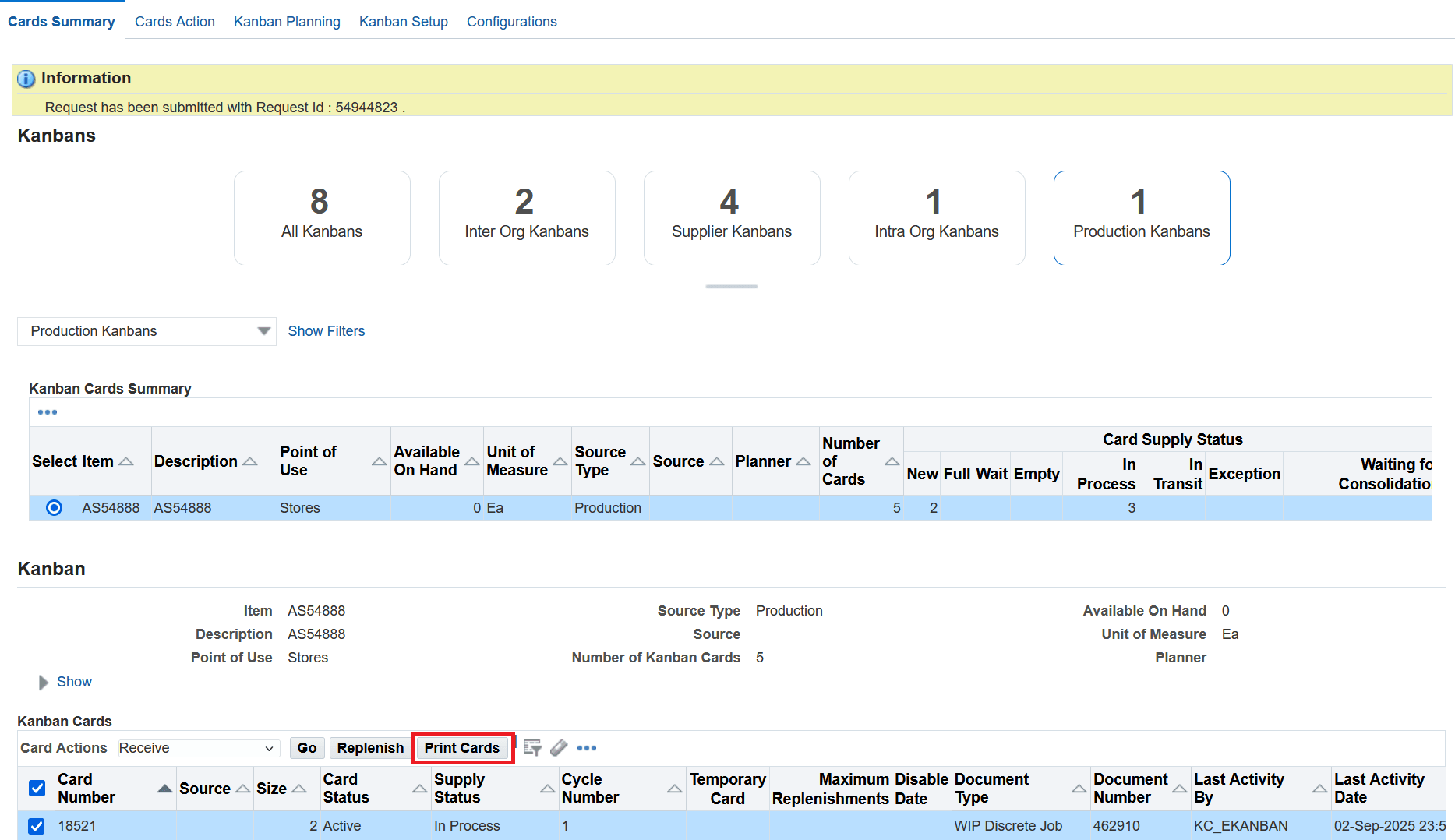

In the Cards Summary page, click Print Cards.
Cards Summary page - Click Print Cards button
Cards Summary
