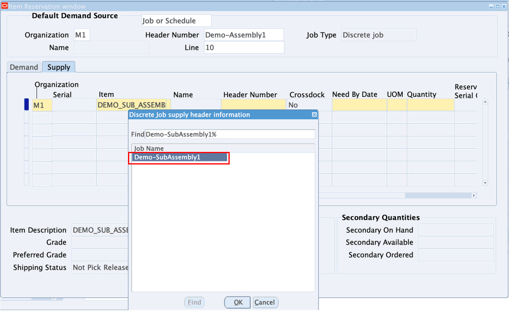

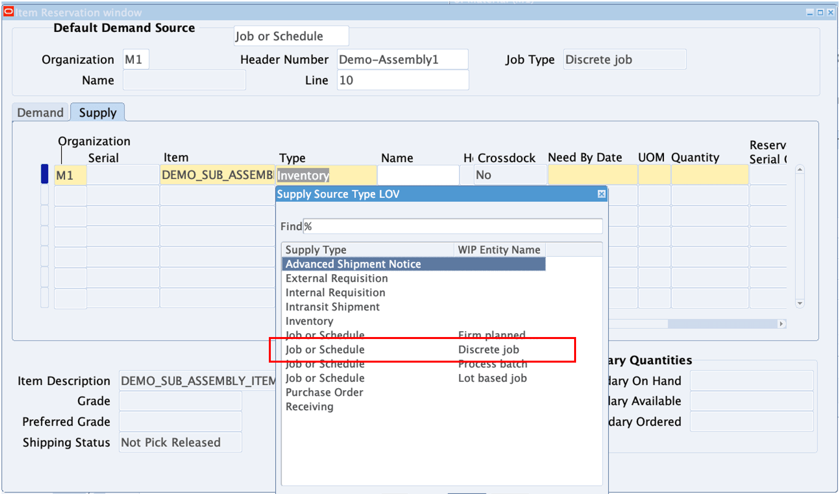

Discrete jobs can be referenced as supply, as shown in the screenshot above.  You can also search for specific discrete job as displayed in the screenshot below.

A validation been added to verify the available quantity on the Sub Assembly Job and allow reservations to be created for the maximum of the available quantity.
