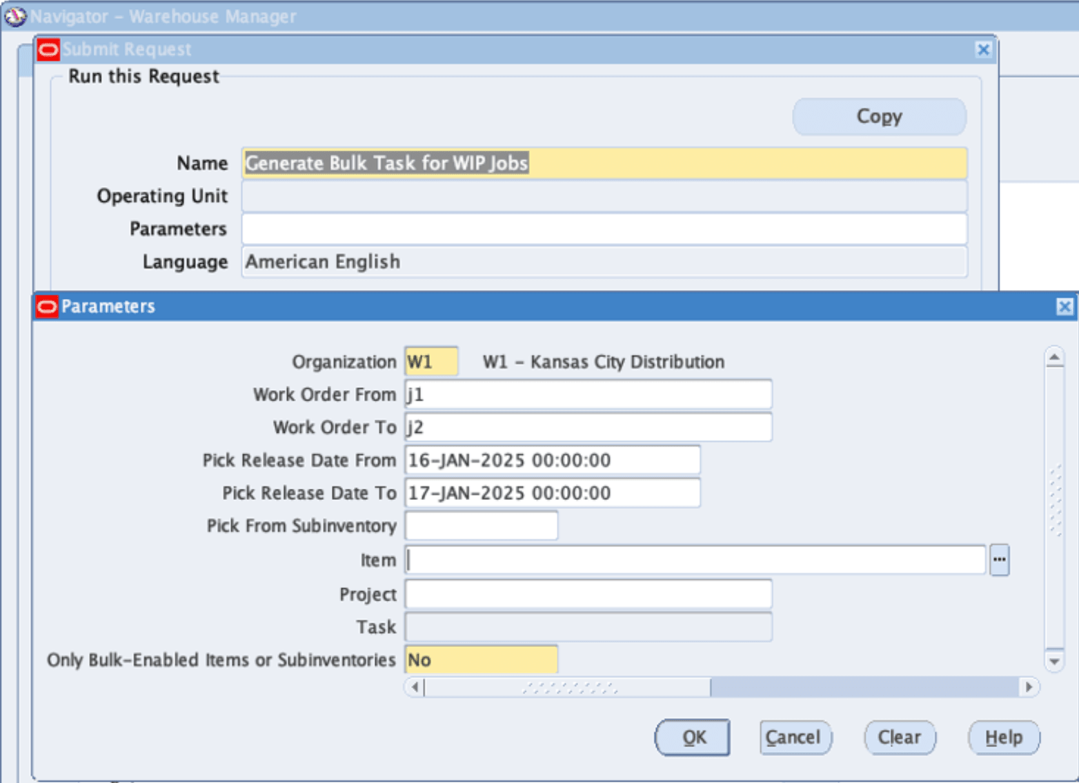

Generate Bulk Tasks for WIP Jobs
You can use the concurrent program Generate Bulk Task for WIP Jobs to create bulk tasks for discrete WIP work orders. The application groups all lines that are allocated the same component from the same location into a single large task, so that the operator can pick multiple WIP Jobs in a single step and then deconsolidate them while dropping the tasks. This concurrent program can create bulk tasks for both the PJM-enabled and non PJM-enabled organizations.
