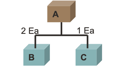

Outsourced Assembly BOM Structure
Current costs in the OEM Organization
Subcontracting Component B: $2
Subcontracting Component C: $3
Subcontracting Assembly A: Will be calculated at PO Receipt

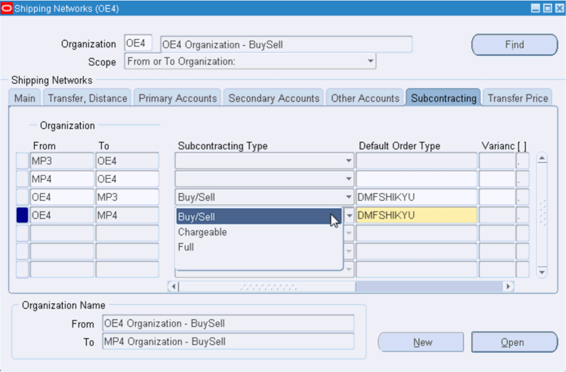

Steps to enable and configure
- Set up the MP organization to not allow negative balances.
- Define a shipping network to enable material flow from the OEM to the MP, by selecting Full as the Subcontracting Type.
- Select a Variance account to serve as the Subcontracting Intransit account for Full Outsourcing
- Select an Offset account that is used for reducing the outsourced assembly on-hand quantity by miscellaneous issues, and is part of simulation.
Setup Shipping Network for Full Outsourcing
