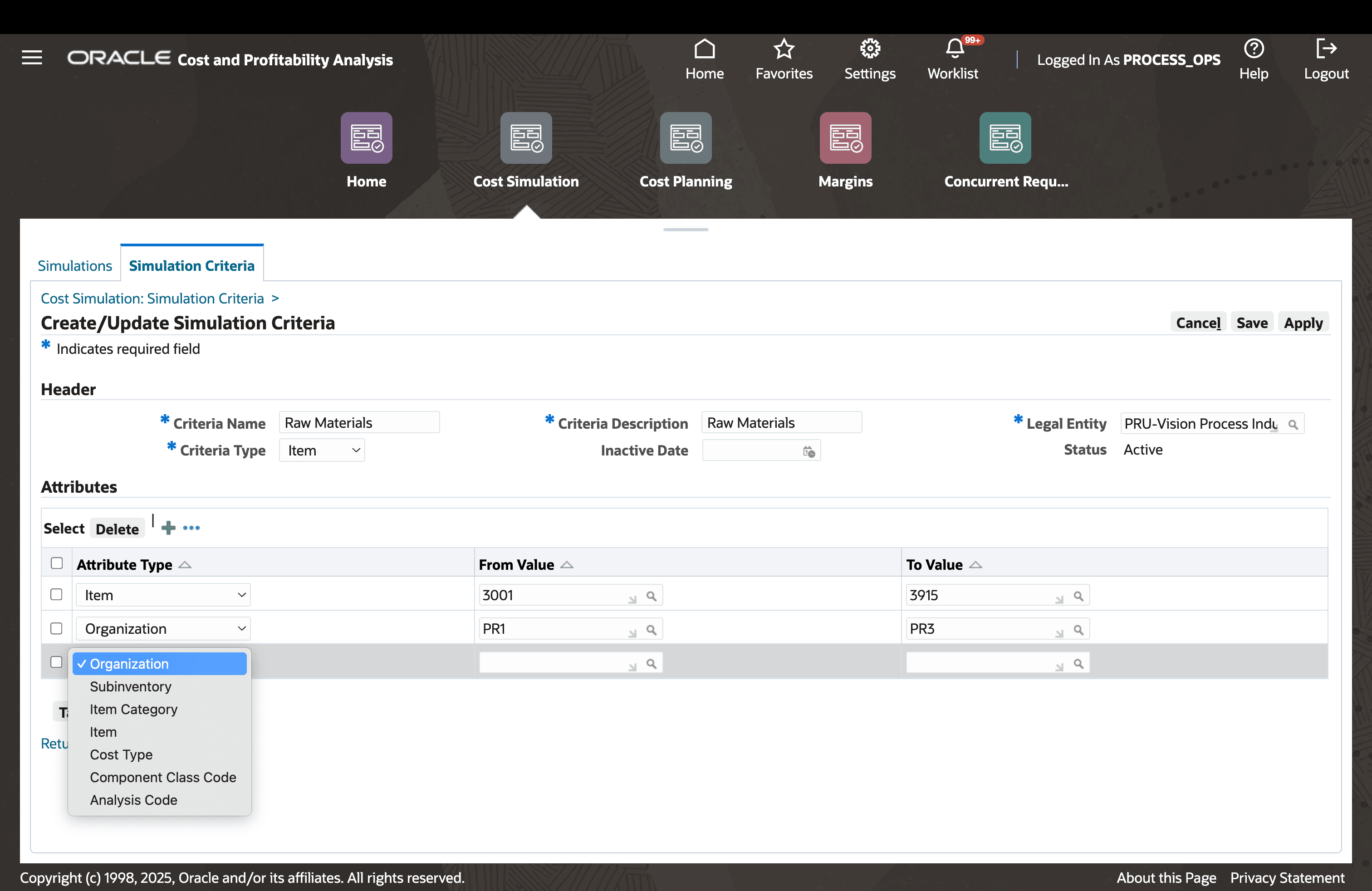

  1. Metadata setup — create reusable Simulation Criteria. In the metadata configuration, users define named Simulation Criteria (a group of items, resources within one or more inventory organizations). These are reusable sets used for recurring simulations. Examples:
    • All raw materials whose costs are renegotiated together
    • Imported goods sensitive to exchange rates
    • Items subject to similar tax/duty provisions
    • Commodity inputs whose prices fluctuate or are determined post-consumption (e.g., metals)
Create a Simulation Criteria

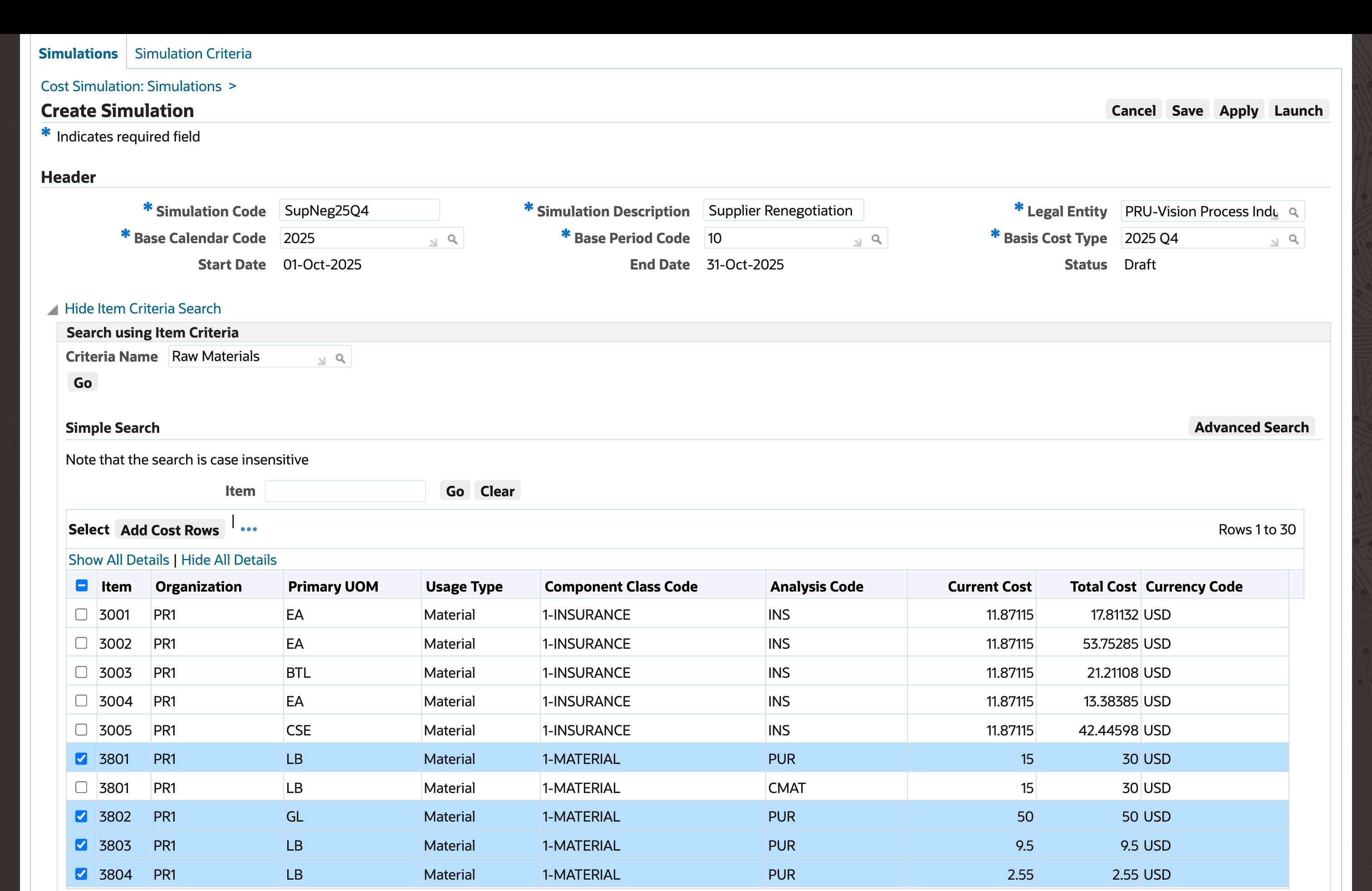

  1. Create a simulation — pick or define criteria.
    • When creating a simulation, users may select a predefined Simulation Criteria for recurring activities, or build a one-off criteria directly on the simulation screen (a manual list of items/resources to change).
Create a Simulation using a Simulation Criteria

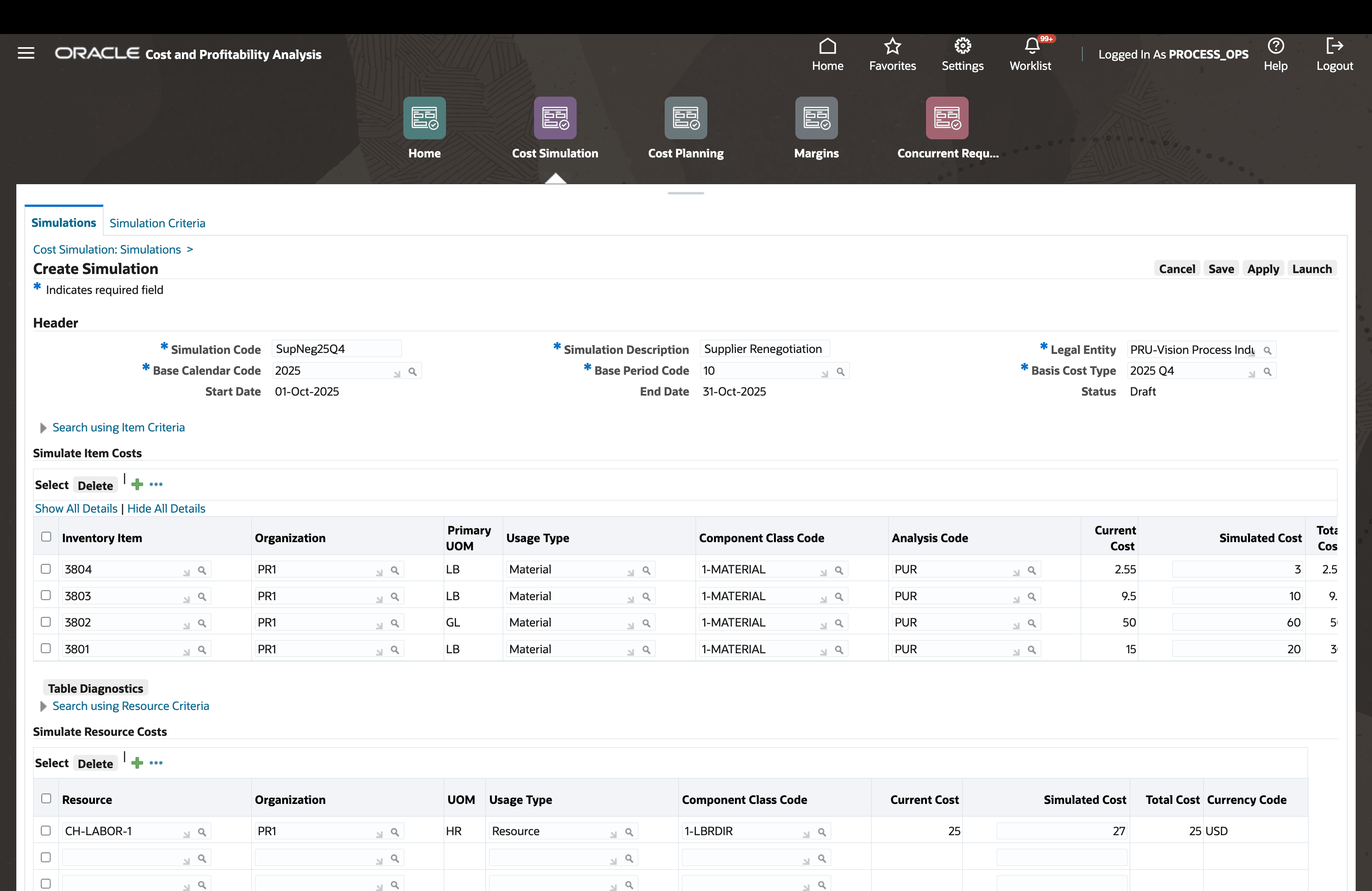

  1. Provide change inputs and launch
    • Provide the list of entities, the cost change(s) (absolute or percentage), and the selected roll-up option, then launch the simulation.
Create a Simulation for Changes in Item, Resource and Overhead Rates

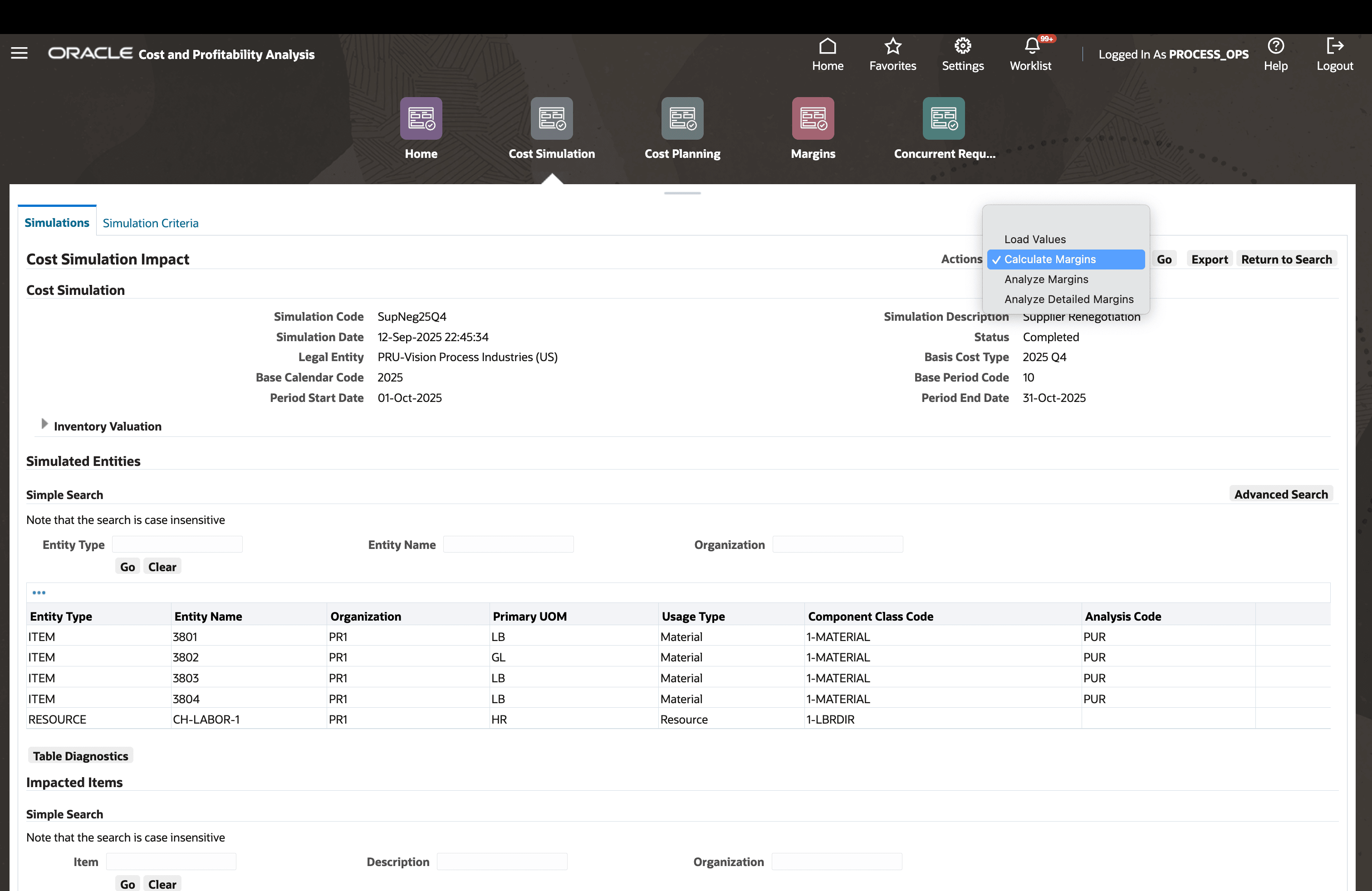

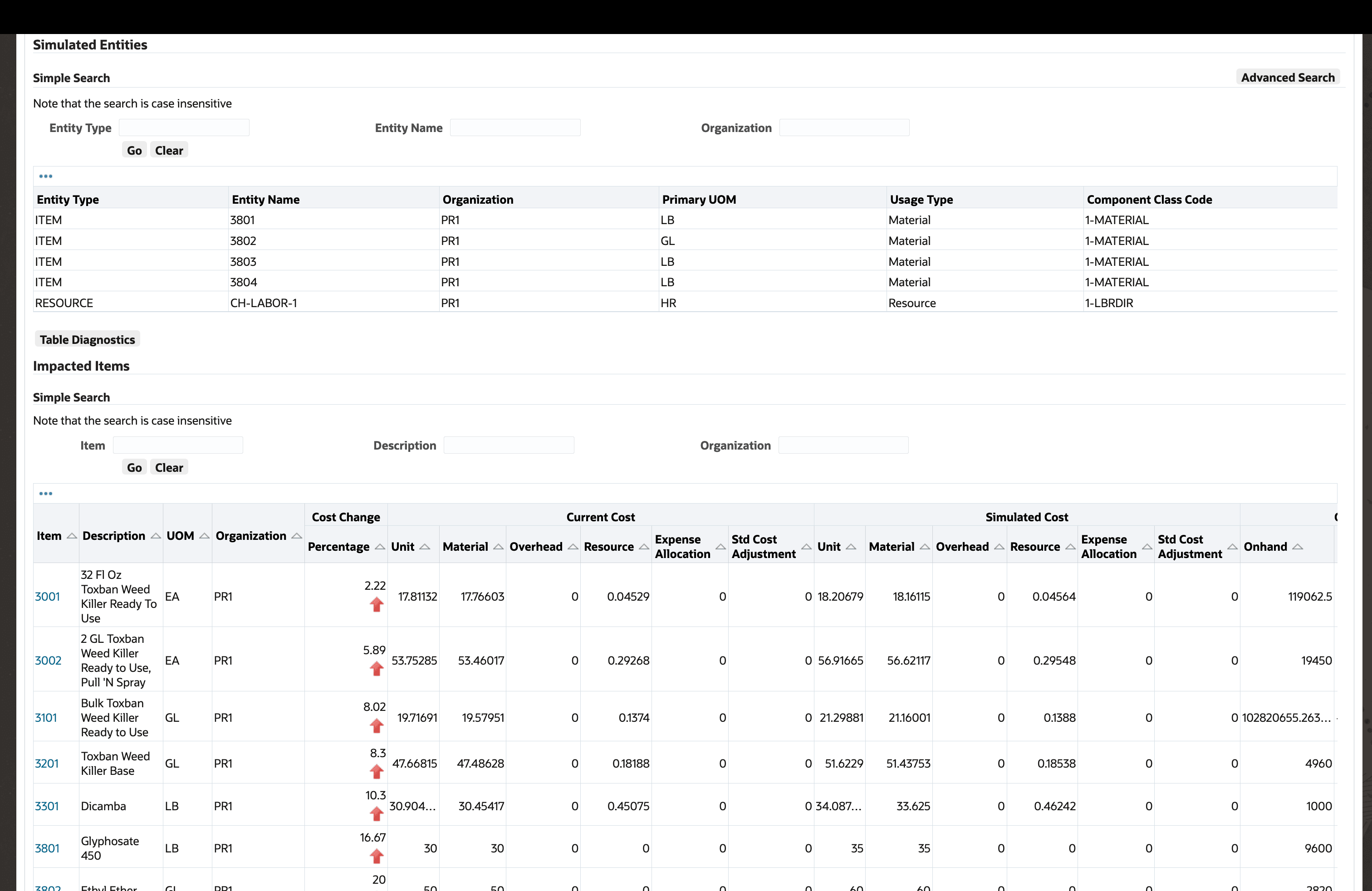

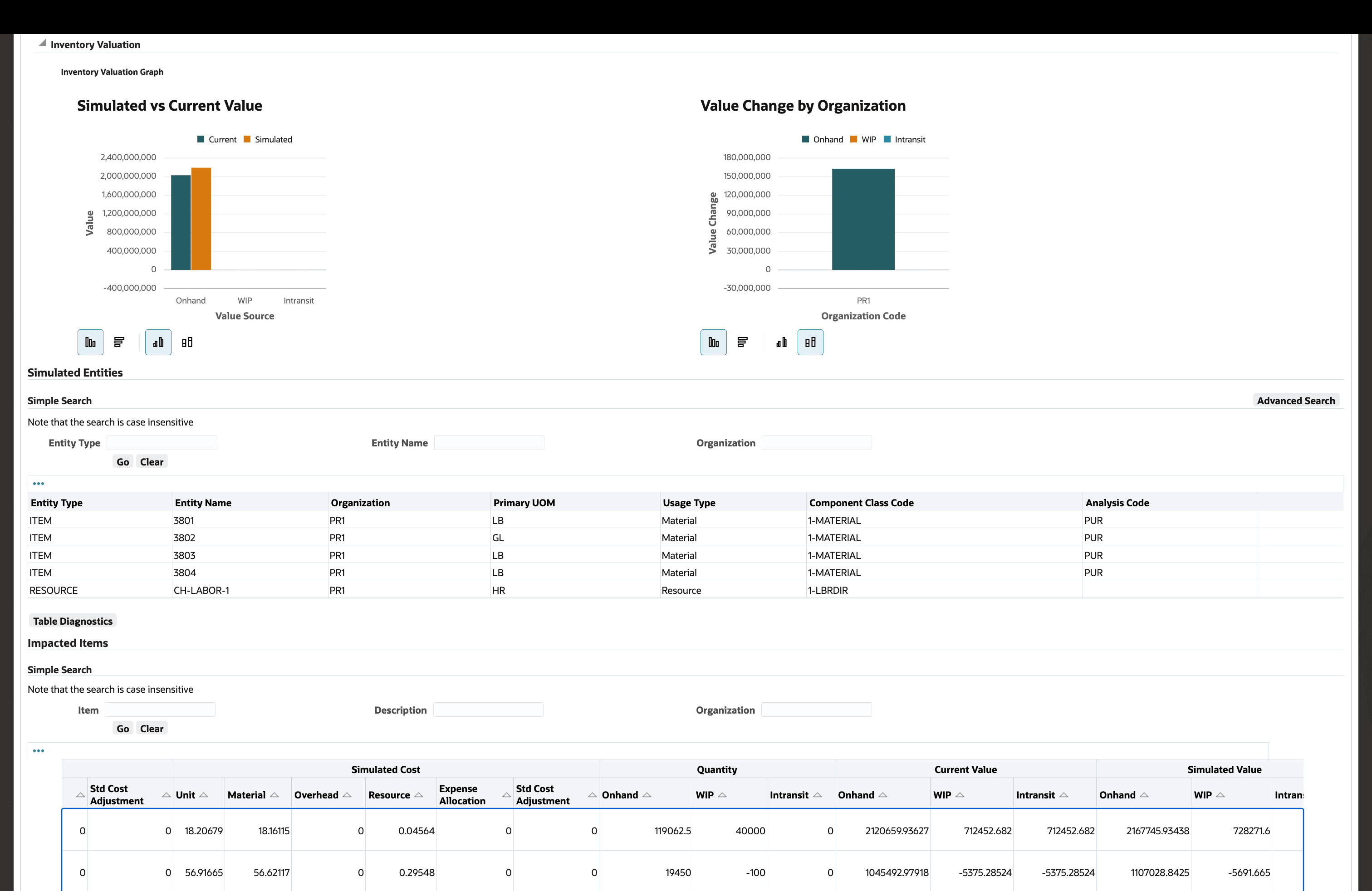

  1. Review impacted product list & valuation deltas
    • The simulation returns all products directly or indirectly affected by the change, showing percentage change in their product costs and quantified impacts to inventory, WIP and in-transit valuations that would result from implementing the change.
Review Impacted List of Items

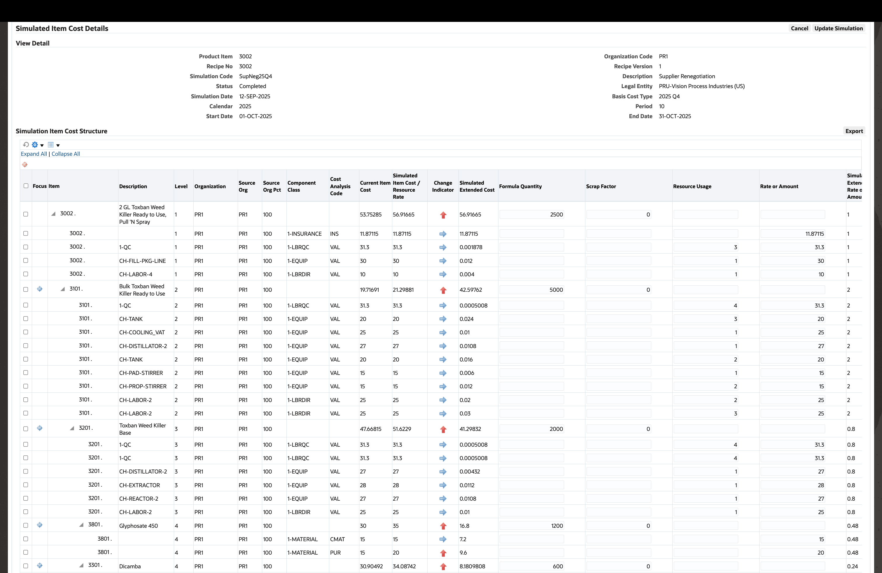

  1. Drill down to detailed multi-level cost views
    • Drill into any impacted product to view an indented, multi-level cost structure. The drilldown clearly highlights cost elements that have changed and identifies one or more sources of change introduced by the simulation, making it easy to identify root causes.
Drill down through a Multi-Level Product Cost Structure and Trace the Cost Impacts Across Levels
  1. Review impact to Valuation
    • The Current vs Simulated graphs and tables illustrate the projected impact on valuation if the simulated costs were used as current costs.
Review Impact to Inventory, Intransit and WIP Valuation

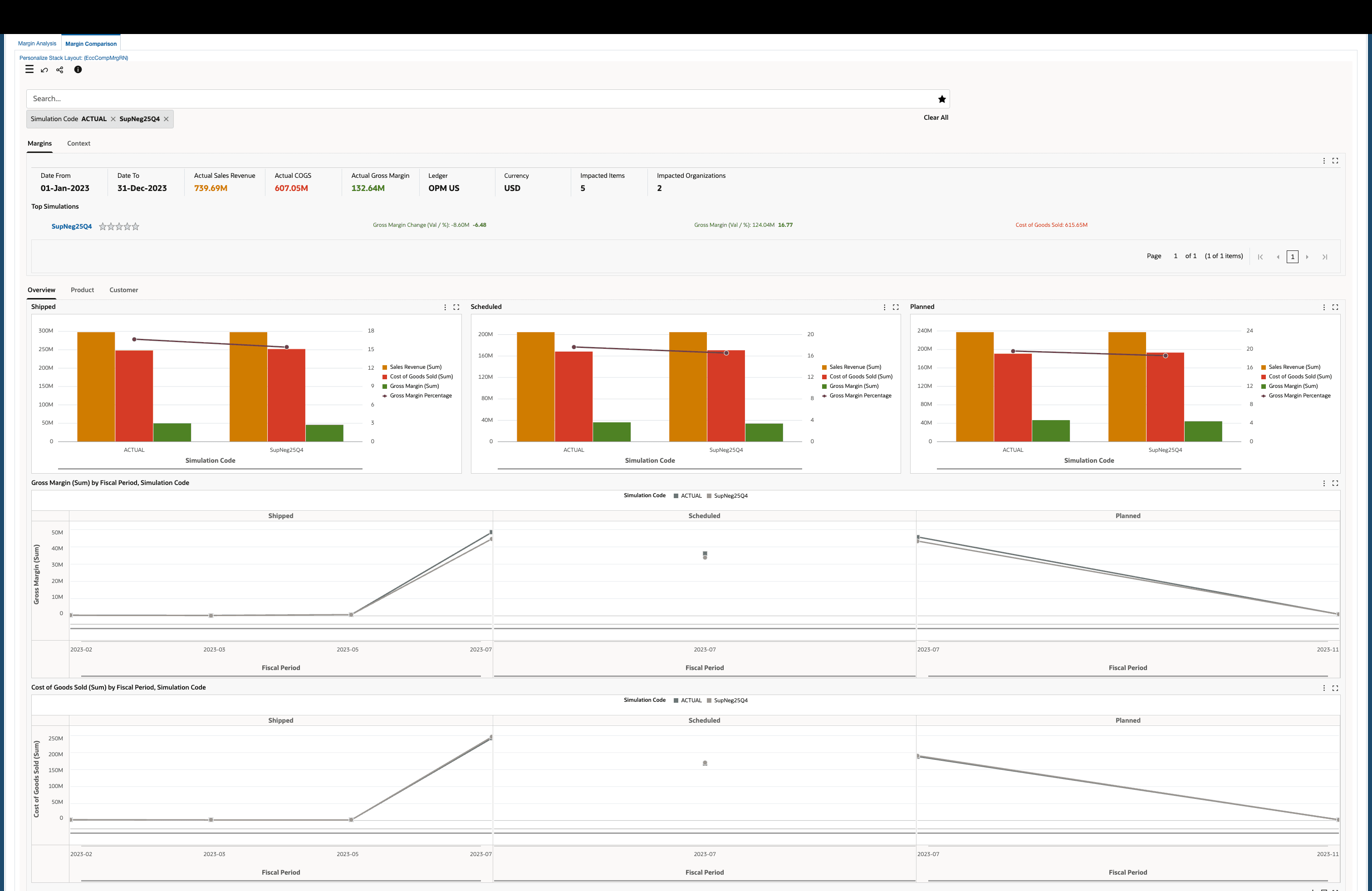

  1. Run margin analysis
    • From a simulation, run integrated margin analysis to see how cost changes affect product margins and profitability metrics.
Review Impact to Gross Margin
Analyze Impact to Gross Margins using Margin Comparison Dashboard
  1. Iterate, compare and choose the optimal scenario
    • Create unlimited simulation runs and use the Compare Margins dashboard to evaluate margin impacts across scenarios. Rank and refine simulations to identify the most cost-effective strategy for your business.
