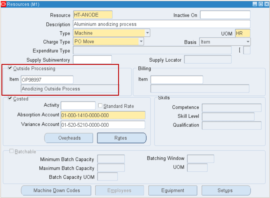

  • Define the OSP Resource
Define OSP Resource

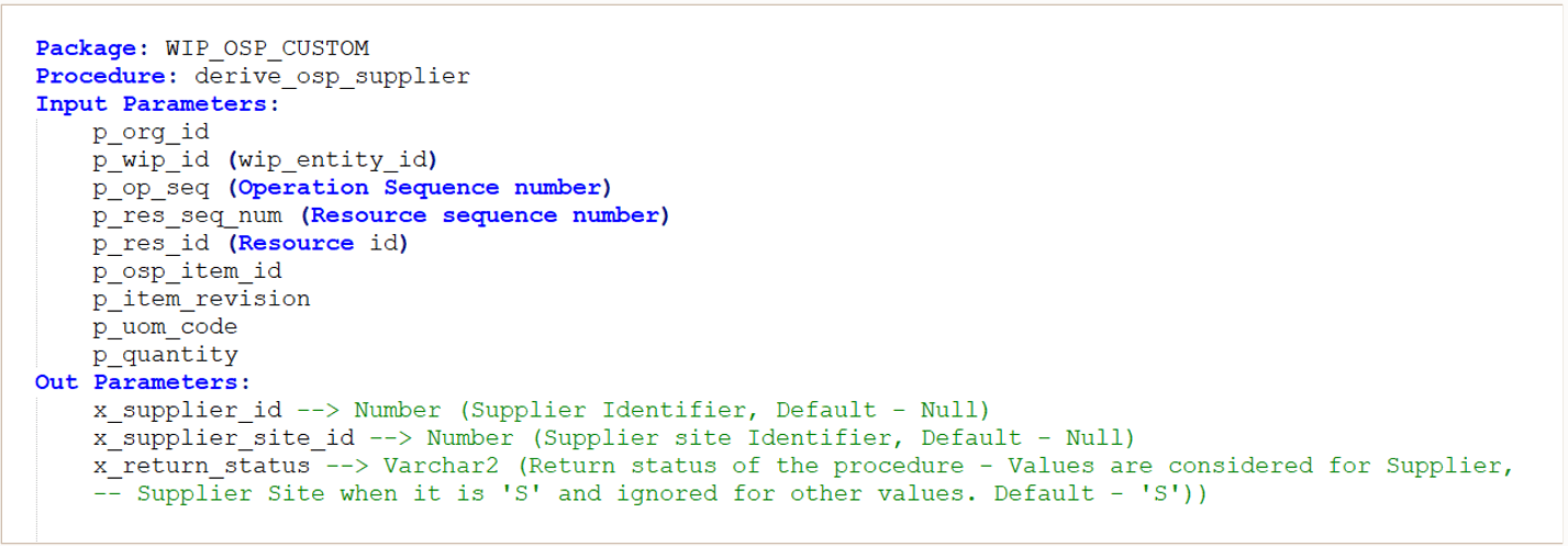

  • Use the Custom Extension
Custom Extension
Tips and considerations
  • Specify a supplier and supplier site different from default supplier and supplier site in purchase requisition.
  • Select a different supplier and supplier site based on the following:
    • A value in a descriptive flexfield.
    • A week of a month.
    • A day of a week,
