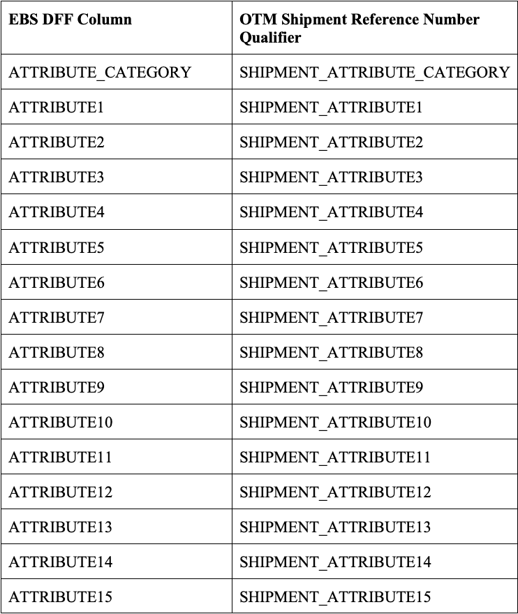

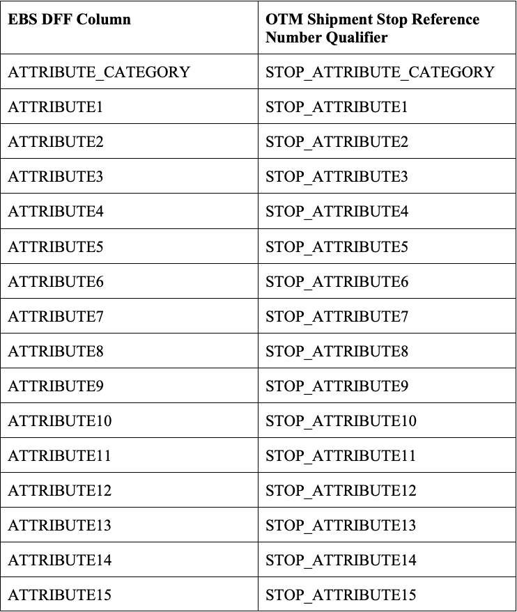

This enhancement is applicable to both Delivery and Batch based integrations with OTM.  Values from OTM are found in the following objects:  DB Objects WSH_OTM_TRIP_OBJ and WSH_OTM_STOP_OBJ.  The values passed in these attributes are mapped to corresponding DFFs for Trip and Trip Stop.  As an ready-to-use solution, we use the following mapping.
Mapping for Trips
Mapping for Trips
Mapping for Stops
Mapping for Trip Stops

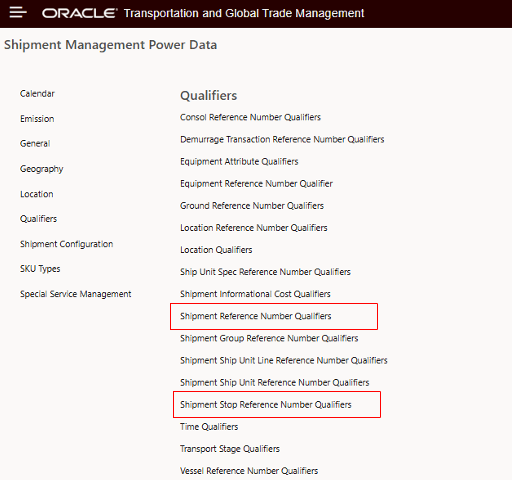

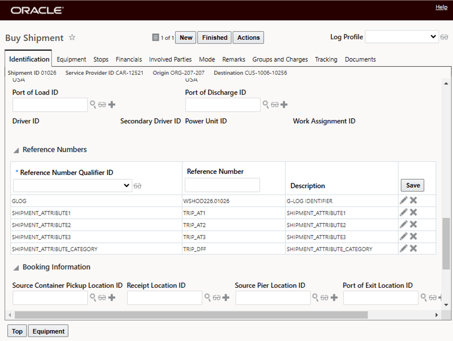

Use the following navigation to create the Shipment and Stop reference number qualifiers in OTM.
  • Shipment Management => Power Data => Qualifiers => Shipment Reference Number Qualifiers
  • Shipment Management => Power Data => Qualifiers => Shipment Stop Reference Number Qualifiers
Shipment Management Power Data

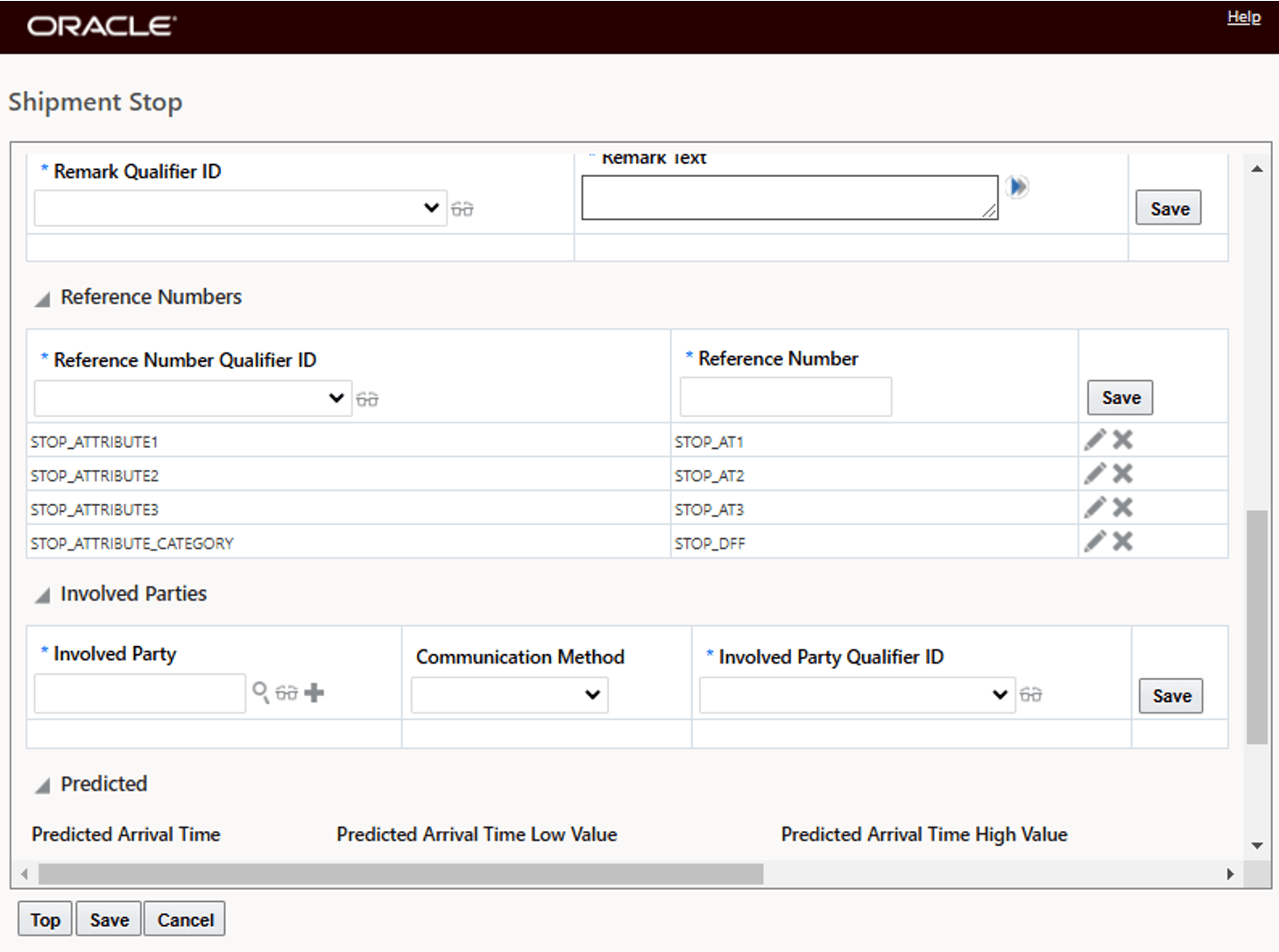

Enter the Shipment (Trip) and Shipment (Trip) Stop reference number qualifiers in OTM. You can do this manually or by using automation agents.
Shipment Reference Numbers
Shipment Stop Reference Numbers

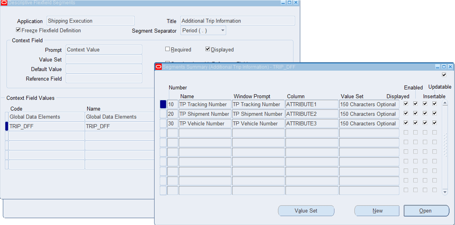

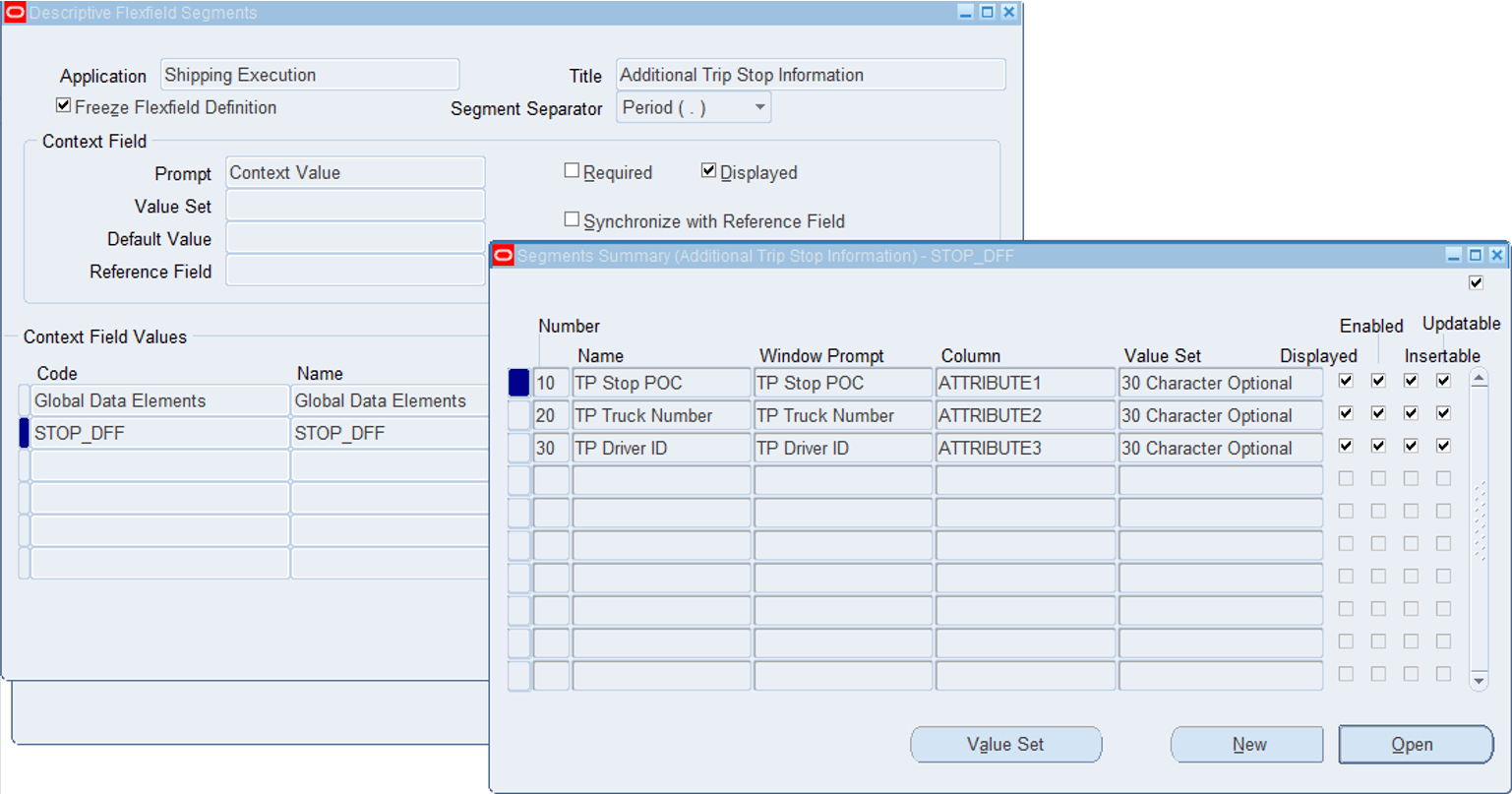

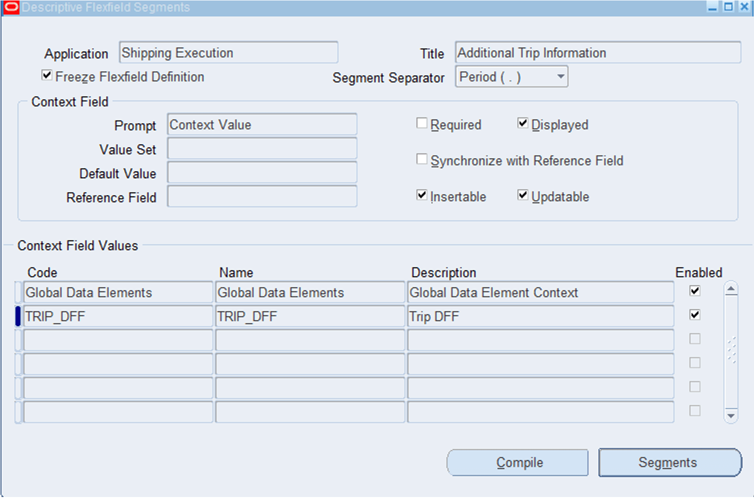

You must set up the DFFs for additional trip information and additional trip stop information.  The following four screenshots are for the purpose of illustration.  You will need to create your own setup.
DFF Segments for Additional Trip Information
DFF Setup for Additional Trip Information
DFFs Segments for Additional Trip Stop Information
DFF Setup for Additional Trip Stop Information

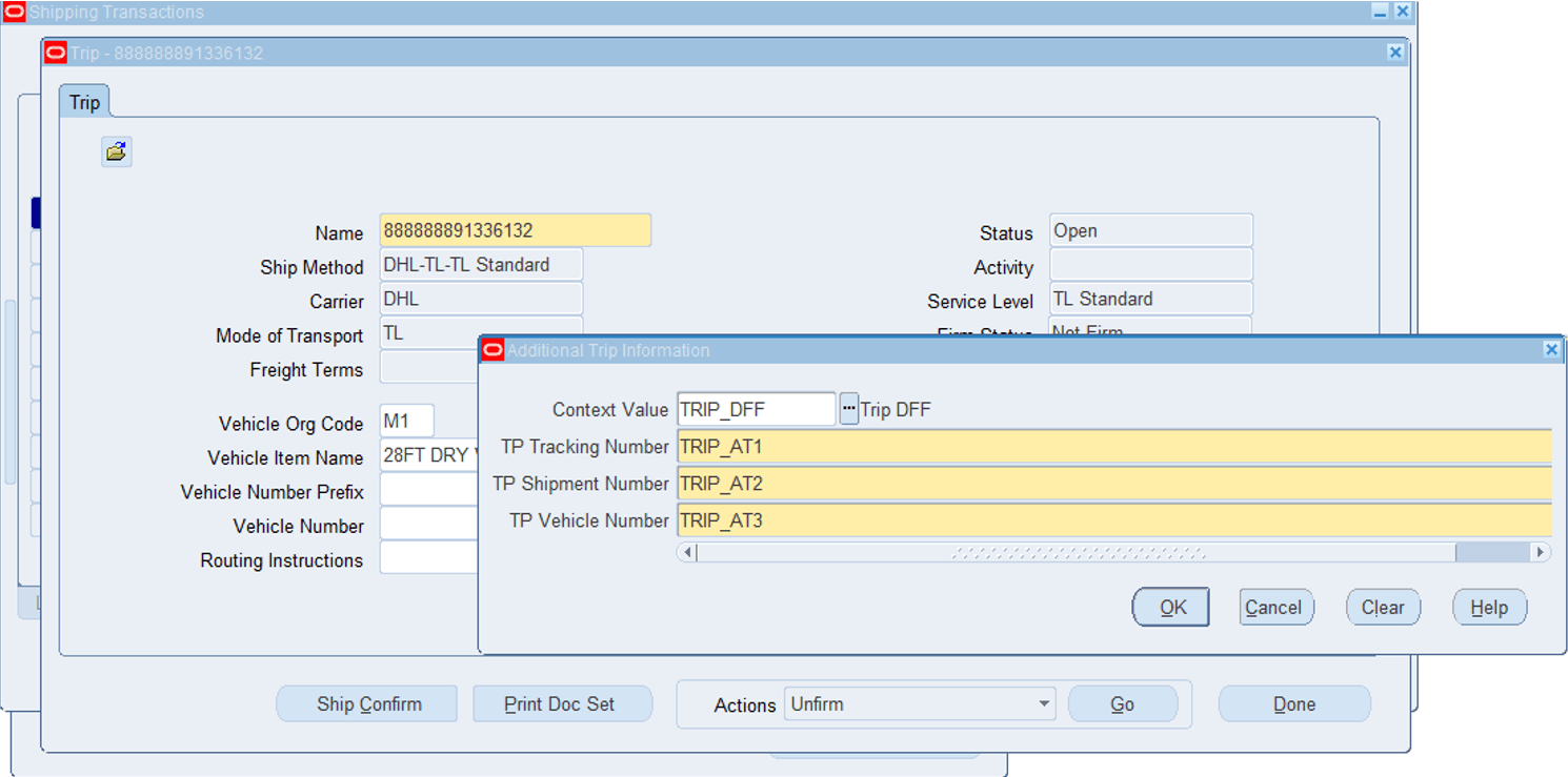

Shipping Transaction Form - Additional Trip Information
Shipping Transaction window - Additional Trip Information

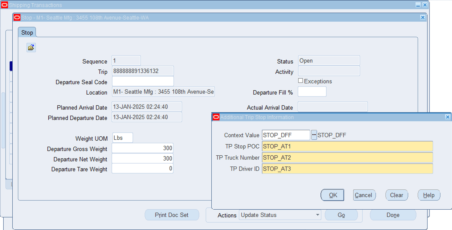

Shipping Transaction Form - Additional Trip Stop Information
Shipping Transaction window - Additional Trip Stop Information
