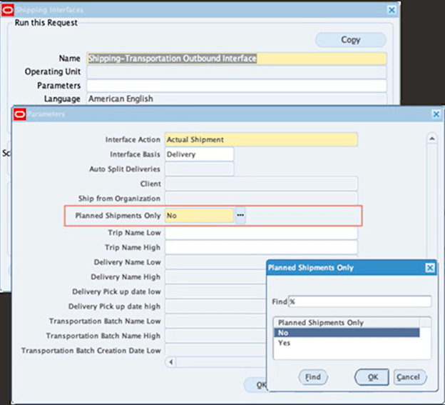

1. Run the Shipping-Transportation Outbound Interface program.
2. Use the Planned Shipments Only parameter when the Interface Action is Actual Shipment.
3. Validate that records marked Ignore for Planning are excluded from the shipments sent to OTM.
Shipping Transportation Outbound Interface Concurrent Program

- The Planned Shipments Only parameter is applicable only when Interface Action is Actual Shipment.
- Confirm that lines intended to be excluded are marked Ignore for Planning before running the outbound interface.
