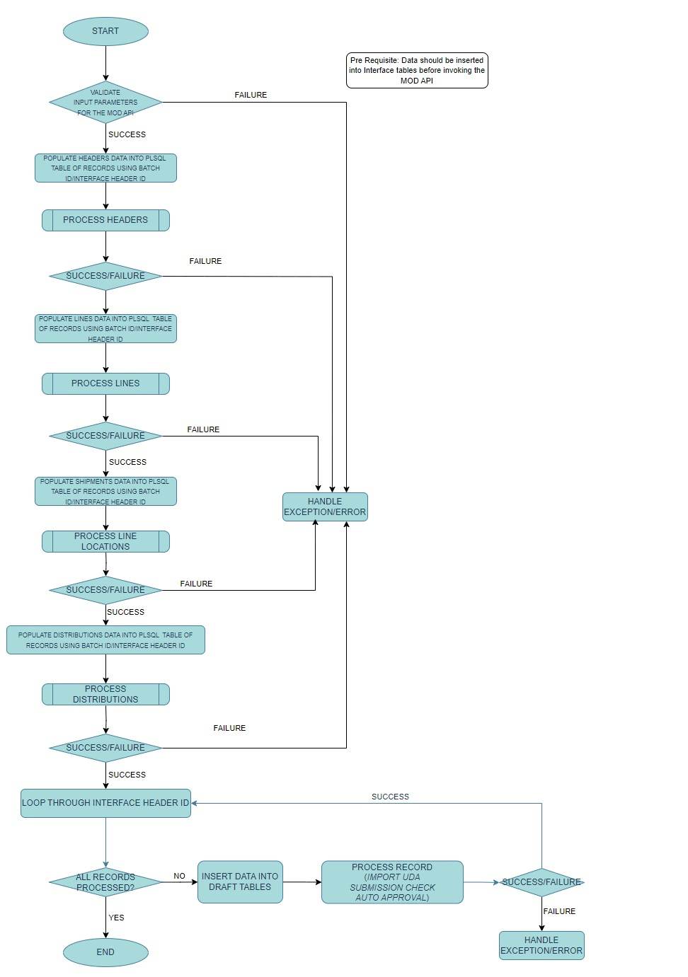

Process flow in the API:
To create modifications, the PO_PDOI_MOD_PVT.create_award_mod API uses the following process:
MOD API Flow Chart
MOD API Flow Chart
The MOD API performs the following tasks:
  • Retrieves data from the interface tables using the provided BATCH_ID as an input.
  • Processes all header interface records related to the BATCH_ID, and adds all successful records to a collection variable.
  • Processes all line interface records for the BATCH_ID that correspond to the successful header records, and adds all successful records to a separate collection variable.
  • Processes all line location interface records for the BATCH_ID that correspond to the successful header and line records, and adds all successful results to a collection variable.
  • Processes all distribution interface records for the BATCH_ID that relate to successful header, line, and line location records, collecting all successful entries into a collection variable.
  • Processes at each entity level, which involves pre-validation, deriving additional data based on the available data at the interface level, defaulting any required data from system parameters, and performing data validation.
  • After completing processing at each entity level for the specified BATCH_ID, inserts the data into the appropriate draft tables by iterating through each interface header ID to handle each modification individually.
  • Generates the modification number.
  • Imports and copies the UDAs.
  • Performs submission checks.
  • Initiates the workflow for modification approval.
