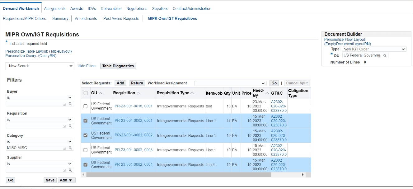

When there are several requisition lines with similar information, the requisition lines are grouped to create one order line with multiple schedules in order to simplify the intragovernmental order. This enhancement simplifies intragovernmental order creation by automatically grouping requisition lines with similar attributes into a single order line containing multiple schedules. Requisition lines are grouped when the following attributes have identical values: Description, Category ID, Order Type Lookup Code, Purchase Basis, Matching Basis, Unit of Measurement, and Source Document ID. By reducing the number of order lines, the resulting intragovernmental order is easier to manage and execute between trading partners.

The feature improves the requisition-to-order conversion process for agencies that receive multiple related IGT request lines. Instead of creating one order line for every requisition line, buyers can use the document builder process to create a cleaner order structure while preserving traceability to the original requests.

- Create or import requisition lines with matching grouping attributes.
- Generate the intragovernmental order and verify that qualifying requisition lines are consolidated into a single order line with multiple schedules.
