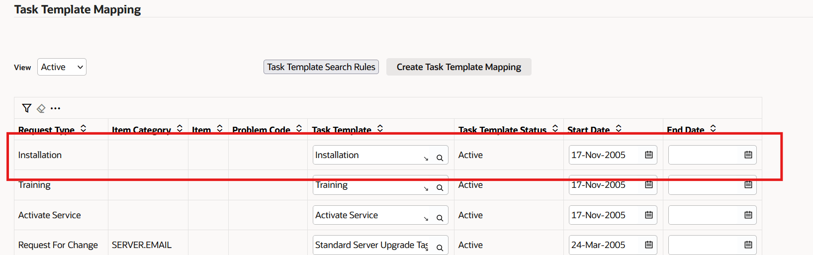

To set up the Automatic Task Generation process, first define the Task Template mapping as shown in the following screenshot. This screenshot shows the Task Template Mapping setup. This example uses the “Installation” service request type to which the “Installation” task template is mapped.
Auto Task Setup

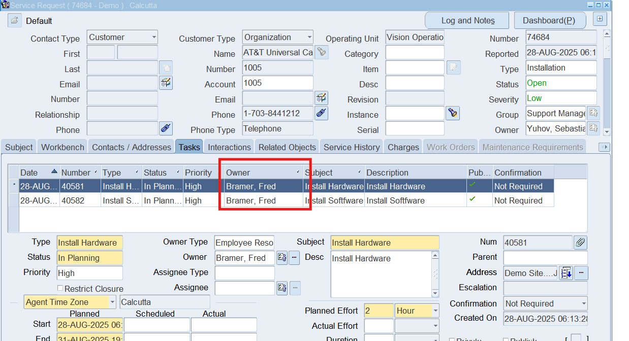

When you create a service request with the Request Type as Installation and save, the Automatic Tasks Generation process is initiated, and the process creates two tasks. Go to the Tasks tab in the Service Request window that shows two tasks that are created, and both the tasks are assigned to Bramer, Fred according to the setup.
Service Creation and Task Details
SR Creation and Task Deails
