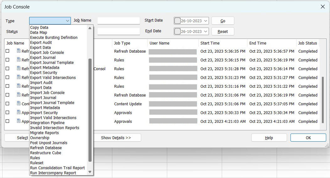

In the Smart View Panel, right-click the
application name and select Job Console from the context
menu.
Alternatively, select the application name, and in the Action Panel, select More, and then Job Console.
The Job Console is displayed.
By default, all job types and statuses are displayed in the Job Console.
For ongoing jobs, the job status and substatus are displayed in the Job Status column.
To filter the list of jobs in the Job Console, from the
filter criteria area at the top of the dialog, use any of the following job
criteria:
Type—From the drop-down menu, select a job type. For example, some job types are:
Clear Cell Details
Copy Data
Refresh Database
Rules
Smart Push
This is a partial list of job types. Your administrator configures the job types available to you. Administrators can view all job types.
