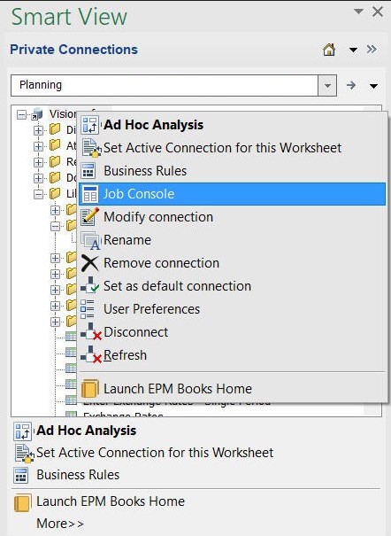

To check the execution status of jobs:
In the Smart View Panel, right-click the
application name and select Job Console from the context
menu.
Alternatively, select the application name, and in the Action Panel, select More, and then Job Console.
The Job Console is displayed.

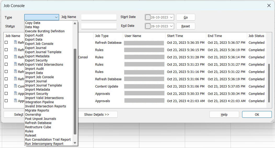

To filter the list of jobs in the Job Console, from the
filter criteria area at the top of the dialog, use any of the following job
criteria:
Type—From the drop-down menu, select a job type. For example, some job types are:
Clear Cell Details
Copy Data
Refresh Database
Rules
Smart Push
This is a partial list of job types. Your administrator configures the job types available to you. Administrators can view all job types.
Status—From the drop-down menu, select a job status. For example, some job statuses are:
Completed
Completed with Errors
Error
Processing
This is a partial list of job statuses. Your administrator configures the job statuses available to you. Administrators can view all job statuses.
Job Name—Type a job name.
User Name—Type a user name of the user to whom the job belongs.
Start Date and End Date—The dates are defaulted to yesterday and today to have only a one day difference. Click
and enter a start date and end date range using the
calendar.
Click Go.
The Job Console displays the jobs matching your selection criteria.
