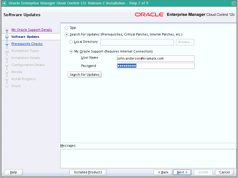

  4. Install Software Updates.
    This image is described in the surrounding text.
    On the Software Updates screen, select one of the following sources from where the software updates can be installed while the installation of the Enterprise Manager system is in progress. If you do not want to apply them now, then select the Skip radio button.
    For instructions to manually download the software updates, refer to Oracle® Enterprise Manager Cloud Control Advanced Installation and Configuration Guide, which is located in the Enterprise Manager Cloud Control Documentation at this link on the Oracle Technology Network:
    http://docs.oracle.com/cd/E24628_01/index.htm
  5. Click the Next button.

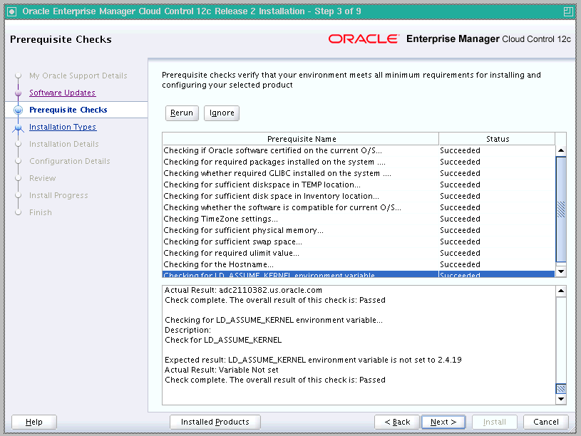

  8. Check Prerequisites.
    On the Prerequisite Checks screen, check the status of the prerequisite checks run by the installation wizard, and verify whether your environment meets all the minimum requirements for a successful installation.
    The installation wizard runs the prerequisite checks automatically when you come to this screen. It checks for the required operating system patches, operating system packages, and so on.
    The status of the prerequisite check can be either Warning, Failed, or Succeeded.
    If some checks result in Warning or Failed status, then investigate and correct the problems before you proceed with the installation. The screen provides details on why the prerequisites failed and how you can resolve them. After you correct the problems, return to this screen and click Rerun to check the prerequisites again.
    You can choose to ignore the checks with Warning status by clicking Ignore. However, all package requirements must be met or fixed before proceeding any further.
  9. Click the Next button.

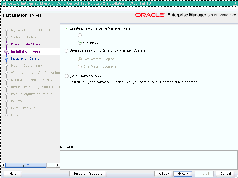

  10. Select Installation Type.
    On the Installation Types screen, select Create a New Enterprise Manager System, then select Advanced.

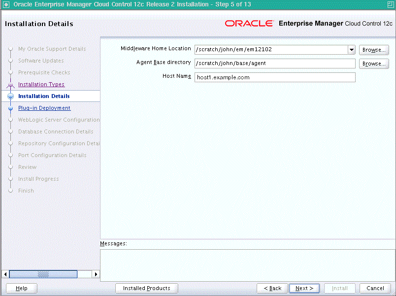

  12. Enter Installation Details.
    On the Installation Details screen, do the following:
    1. Enter or validate the Middleware home where you want to install the OMS and other core components.
      • If you have Oracle WebLogic Server and Java Development Kit already installed, then ensure that they are of the supported releases—Oracle WebLogic Server 11g Release 1 (10.3.5) and JDK 1.6 v24+. If you have the supported releases, the installer automatically detects them and displays the absolute path to the Middleware home where they are installed. In this case, validate the Middleware home. If the location is incorrect, then enter the path to the correct location. Ensure that the Middleware home you select or enter is a Middleware home that does not have any Oracle homes for Oracle Management Service and Oracle Management Agent.
      • ¦If you do not have Oracle WebLogic Server 11g Release 1 (10.3.5) and JDK 1.6 v24+, then the installer automatically installs them for you while installing the Enterprise Manager system. In this case, enter the absolute path to a directory where you want to have them installed. For example, /oracle/software/. Ensure that the directory you enter does not contain any files or subdirectories.
      • If you manually install Oracle WebLogic Server 11g Release 1 (10.3.5), then follow the guidelines outlined in the Before You Begin chapter of in the Enterprise Manager Cloud Control Documentation at this link on the Oracle Technology Network:
    2. Enter the absolute path to the agent base directory, a location outside the Oracle Middleware home where the Management Agent can be installed. For example, /oracle/agent. Ensure that this location is empty and has write permission. Also ensure that it is always maintained outside the Oracle Middleware home.
    3. Validate the name of the host where you want to configure the OMS.
      The host name appears as a fully qualified name. The host name can also appear as a virtual host name if your host is configured with virtual machine.
      You can choose to accept the default host name and proceed with the installation. Alternatively, you can change the name if it is incorrect, or enter another host name for this host. Ensure that the host name you enter is accessible from other hosts in the network (other hosts must be able to ping this host).

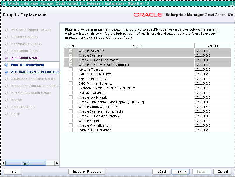

  14. Deploy Plug-Ins.
    On the Plug-In Deployment screen, select the optional plug-ins you want to install from the software kit (DVD, downloaded software) while installing the Enterprise Manager system.
    The pre-selected rows are mandatory plug-ins that will be installed by default. Select the optional ones you want to install.
    During installation, if you want to install a plug-in that is not available in the software kit, then refer to Advanced Installer Options for the point that describes how you can install additional plug-ins.

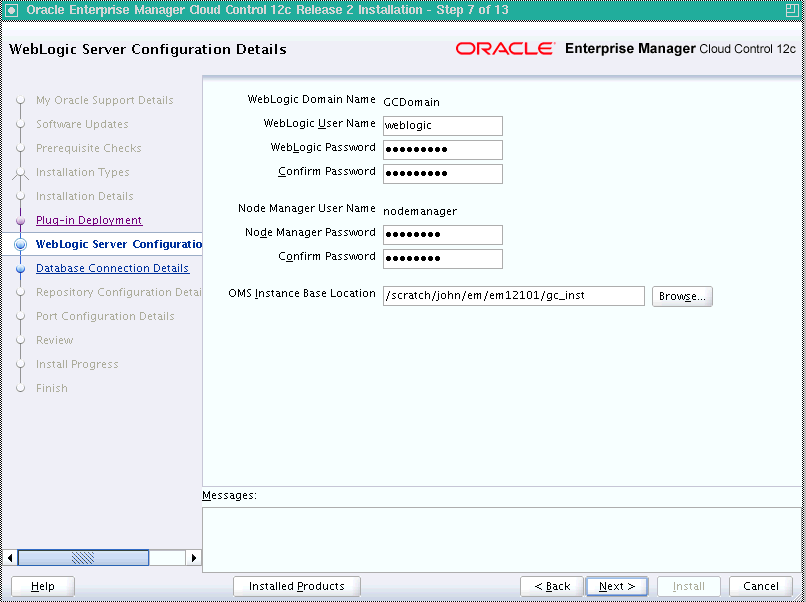

  16. Enter WebLogic Server Configuration Details.
    On the WebLogic Server Configuration Details screen, enter the credentials for the WebLogic Server user account and the Node Manager user account, and validate the path to the Oracle Management Service instance base location.
    Ensure that your password contains at least 8 characters without any spaces, begins with a letter, and includes at least one numeric value.
    By default, the WebLogic Domain name is GCDomain, and the Node Manager name is nodemanager. These are non-editable fields. The installer uses this information for creating Oracle WebLogic Domain and other associated components such as the admin server, the managed server, and the node manager. A Node Manager enables you to start, shut down, or restart an Oracle WebLogic Server instance remotely, and is recommended for applications with high availability requirements.
    If you are installing in an NFS-mounted location, and if you see an error message prompting you not to enter an NFS-mounted location for the OMS instance base location, then click Back repeatedly to reach the Software Updates screen. On the Software Updates screen, select an appropriate option to search and apply the patch 14145094. For more information, click Help on that screen.
    The patch converts the error message to a warning that you can ignore. The installer exits automatically, applies the patch, and invokes itself again for you to proceed with the installation. Once the installation ends, move the lock file location from the NFS-mounted location to a local file system location. Modify the lock file location in the httpd.conf file to map to the location on the local file system. For instructions, refer to the After You Install chapter in the Enterprise Manager Cloud Control Documentation at this link on the Oracle Technology Network:
  17. Click the Next button.

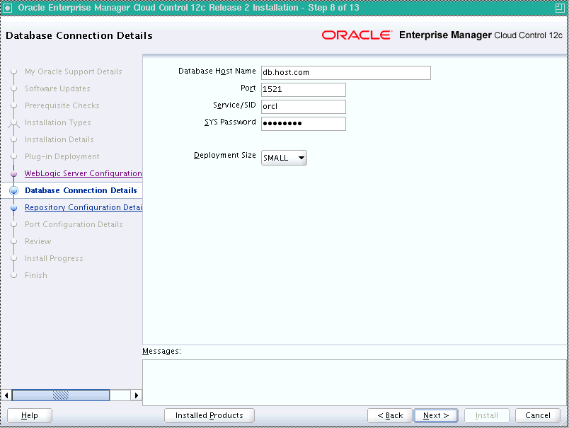

  18. Enter Database Connection Details.
    On the Database Connection Details screen, do the following:
    1. Provide details of the existing, certified database where the Management Repository needs to be created. If you have already created a database instance with a preconfigured Management Repository using the database templates offered by Oracle, then provide details about that database instance.
      The installer uses this information to connect to the existing database for creating the SYSMAN schema and plug-in schemas. If you provide details of a database that already has a preconfigured Management Repository, then the installer only creates plug-in schemas.
      • If you connect to a database instance that was created using the database template offered by Oracle, then note that the password assigned to the user accounts SYSMAN_MDS, SYSMAN_APM, and SYSMAN_OPSS, which were created while preconfiguring the Management Repository, are automatically reset with the SYSMAN password you enter on the Repository Configuration Details screen (as described in Step 20)).
      • Oracle Real Application Cluster (Oracle RAC) nodes are referred to by their virtual IP (vip) names. The service_name parameter is used instead of the system identifier (SID) in connect_data mode, and failover is turned on. For more information, refer to Oracle® Database Net Services Administrator's Guide.
    2. Select the deployment size from the Deployment Size list to indicate the number of targets you plan to monitor, the number Management Agents you plan to have, and the number of concurrent user sessions you plan have. The following table describes each deployment size.
      Deployment Size
      Targets Count
      Management Agents Count
      Concurrent User Session Count
      Small
      Up to 999
      Up to 99
      Up to 10
      Medium
      Between 1000 and 9999
      Between 100 and 999
      Between 10 and 24
      Large
      10,000 or more
      1000 or more
      Between 25 and 50
    For more information on deployment sizes, the prerequisite checks that are run, the database parameters that are set, and how you can modify the deployment size after installation, refer to Oracle® Enterprise Manager Cloud Control Advanced Installation and Configuration Guide.
  19. Click the Next button.
    • If you connect to a database instance that was created using the database template offered by Oracle, then you will be prompted that the database parameters need to be modified to suit the deployment size you selected. This is because the templates are essentially designed for simple installation, and the database parameters are set as required for simple installation. Since it is used for advanced installation, the parameters must be set to different values. You can confirm the message to proceed further. The installation wizard will automatically set the parameters to the required values.
    • If you are connecting to an Oracle RAC database, and if you have specified the virtual IP address of one of its nodes, then the installation wizard prompts you with a Connection String dialog and requests you to update the connection string with information about the other nodes that are part of the cluster. Update the connection string and click OK. If you want to test the connection, click Test Connection.
    • If your Oracle RAC database is configured with Single Client Access Name (SCAN) listener, then you can enter a connection string using the SCAN listener.
    • If you see an error stating that the connection to the database failed with ORA-01017 invalid user name/password, then follow these steps to resolve the issue:
      (1) Verify that SYS password provided is valid.
      (2) Verify that the database initialization parameter REMOTE_LOGIN_PASSWORDFILE is set to Shared or Exclusive.
      (3) Verify that password file with the file name orapw<SID> exists in the <ORACLE_HOME>/dbs directory of the database home. If it does not, create a password file using the ORAPWD command.

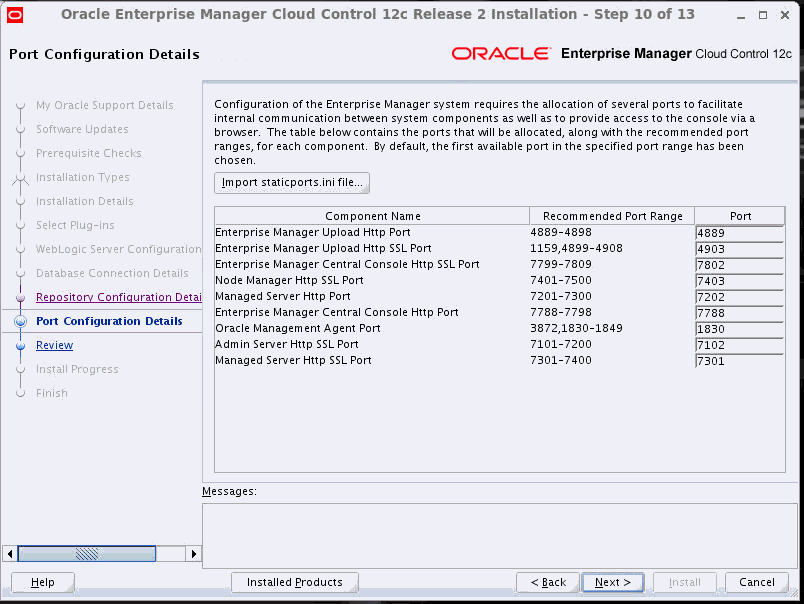

  22. Customize Ports.
    On the Port Configuration Details screen, customize the ports to be used for various components.
    If all the ports on this screen appear as -1, then it indicates that the installer is unable to bind the ports on the host. To resolve this issue, exit the installer, verify the host name and the IP configuration of this host (ensure that the IP address of the host is not being used by another host), restart the installer, and try again.
    You can enter a free custom port that is either within or outside the port range recommended by Oracle.
    To verify if a port is free, run the following command:
    netstat -an | grep <port no>
    However, the custom port must be greater than 1024 and lesser than 65535. Alternatively, if you already have the ports predefined in a staticports.ini file and if you want to use those ports, then click Import staticports.ini File and select the file.
    • If the staticports.ini file is passed during installation, then by default, the ports defined in the staticports.ini file are displayed. Otherwise, the first available port from the recommended range is displayed.
    • The staticports.ini file is available in the following location:
      <Software_Extracted_Location>/response
