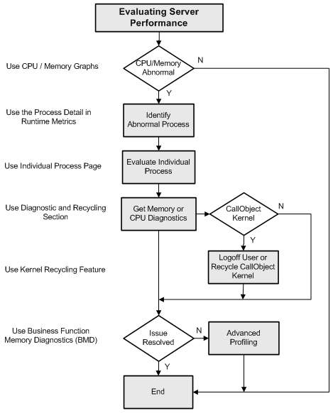

In order to evaluate JD Edwards EnterpriseOne server performance, you will need to follow a process that will isolate the problem. In this process you will:
Determine if the CPU or memory is abnormal
Identify the abnormal process
Evaluate the individual process
Get the memory or CPU diagnostics
Log off or recycle
Use Advanced Profiling
This is a flow chart of the process using KRM to diagnose the root cause of a problem:
