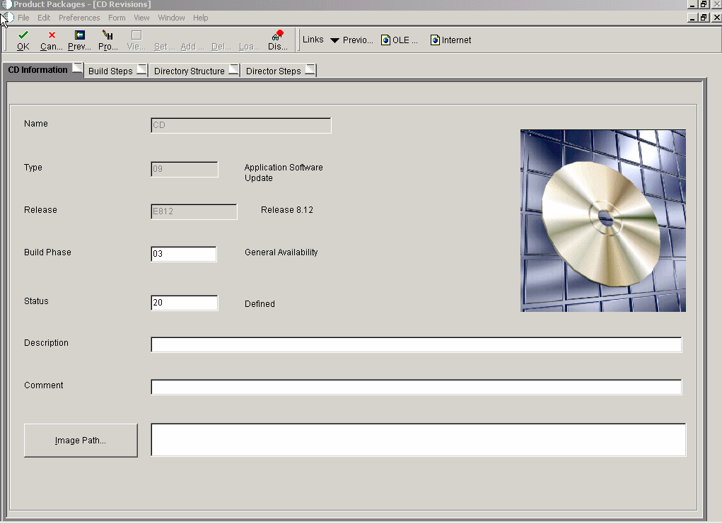

CD Revisions
The CD Information tab lets you set up your CD information, build steps, directory structure, and director steps.
Enter your CD Information.
Status
Displays the status of a build step or directory structure within the mastering process. For example, the build step or directory structure could be at a status of defined, validated, or built. Use the visual-assist button to view a complete list of values for this field.
Comment
Displays short informational comments that are provided by the system about each step of the mastering process. You can enter comments into this field, but the system will overwrite any text that is currently in the field during the next mastering process.
Image Path
Overfills the directory path where you want the software master to reside on the enterprise. The directory that you indicate will be the root directory for the creation of the final software master.
