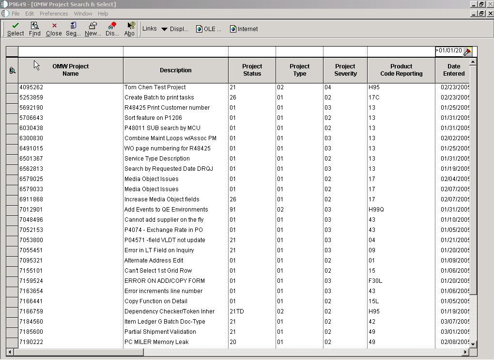

OMW Project Search & Select
The OMW Project Search & Select form is used to display a list of projects to select from when you click on the browse button on the Work with OMW Project Detail form.
![P9649 [OMW Project Search & Select] form.](images/omw_proj_srch_and_sel.gif)
