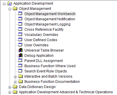

  2. From the Application Development menu (GH902), expand the Object Management folder, select Object Management Workbench application (P98220), or navigate to OMW from Fast Path.
    Description of img1.png follows
    Navigation to Object Management Workbench (P98220)

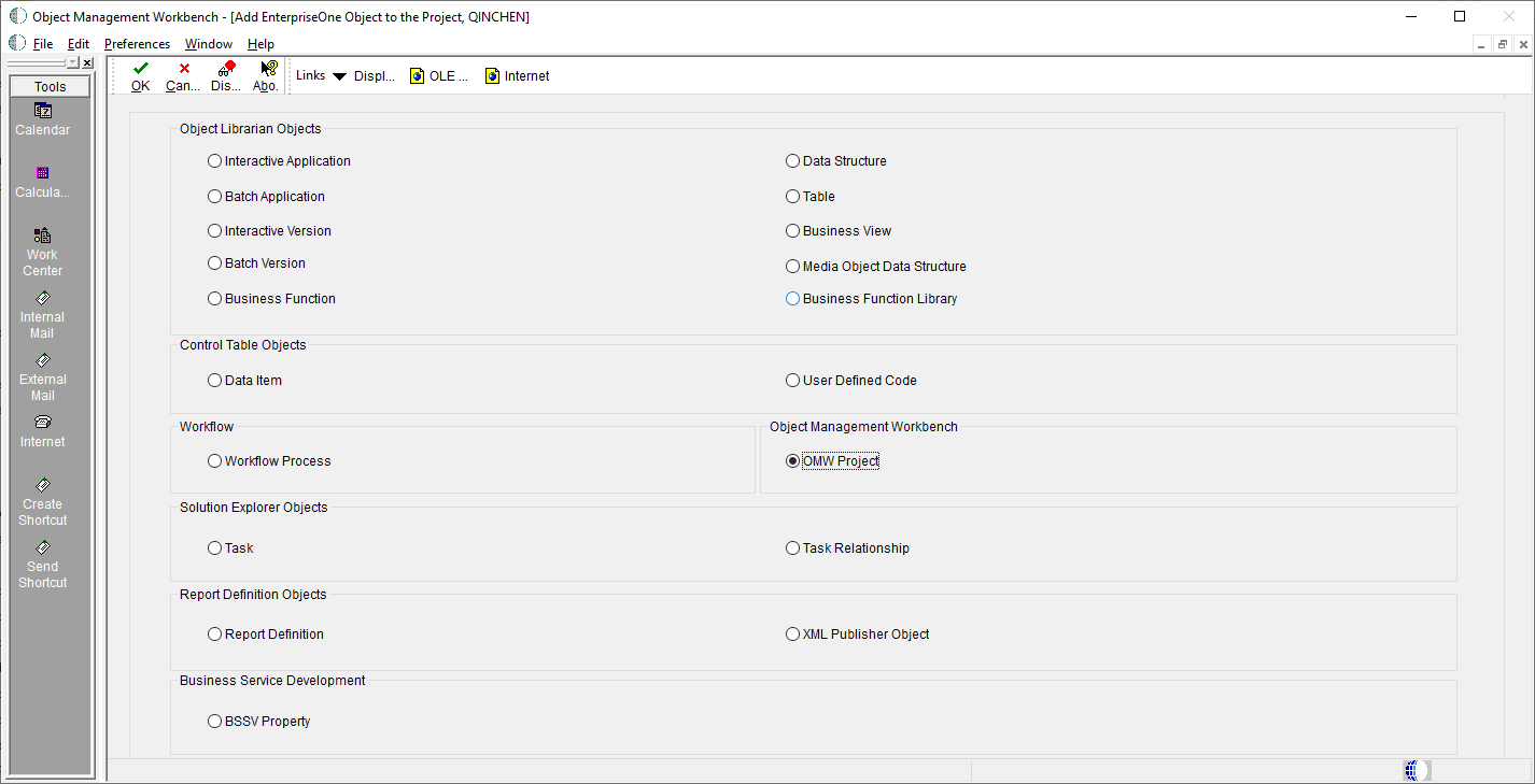

  3. Click Add from the menu.
    Description of img2.png follows
  4. Select OMW Project and click OK.
    Description of img3.png follows
    Object Management Workbench - Add EnterpriseOne Object to the Project

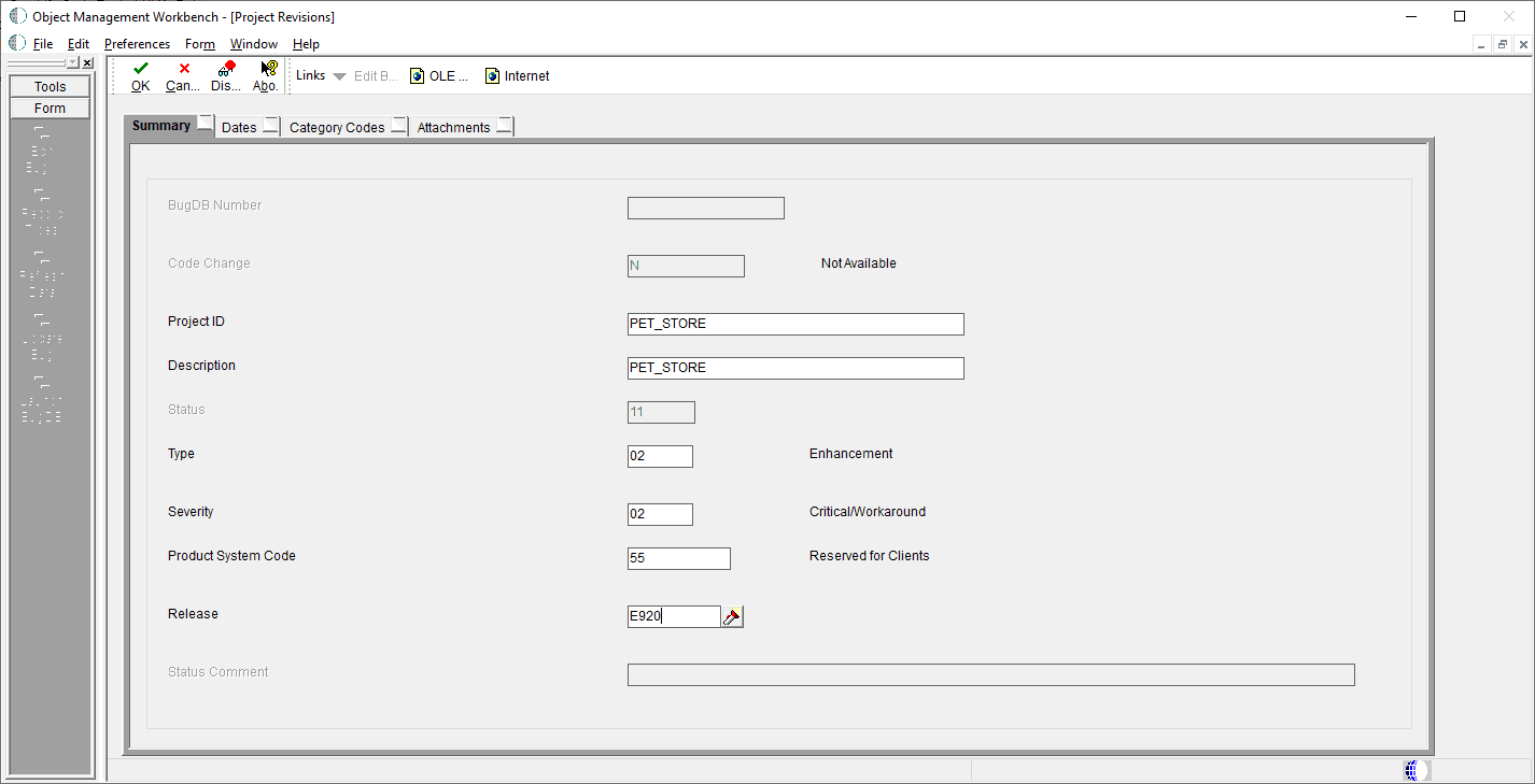

  5. Complete the required fields in the Summary tab and click OK.
    Description of img4.png follows
    Object Management Workbench - Project Revisions

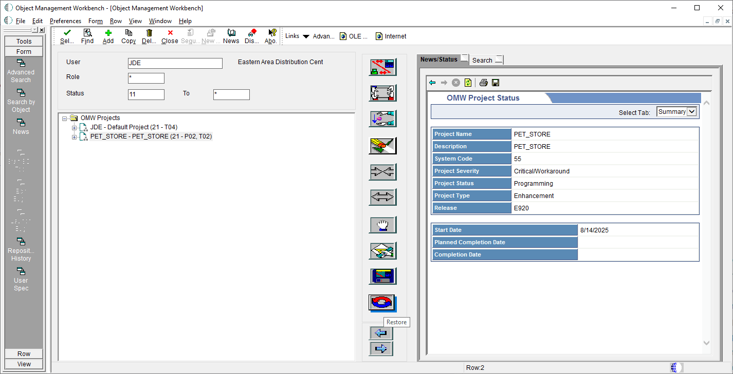

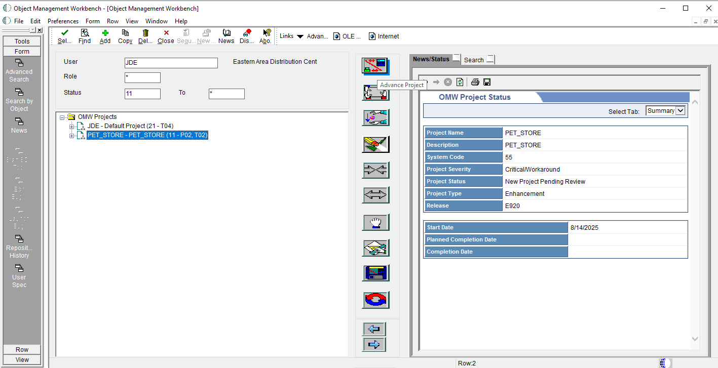

  6. Select the PET_STORE project from the OMW Projects and click Advance Project.
    Description of img5.png follows
    Object Management Workbench - Advance Project

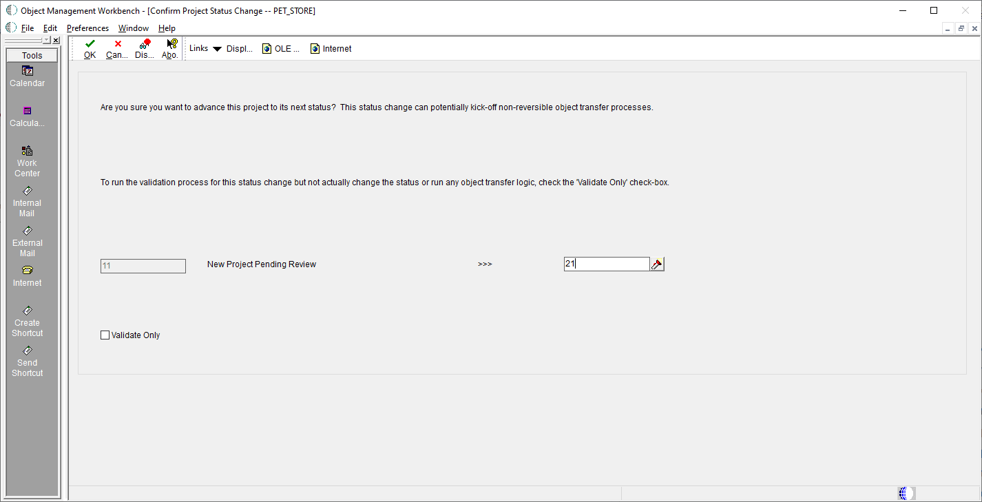

  7. Enter 21 and click OK.
    Description of img6.png follows
    Object Management Workbench - Confirm Project Status Change

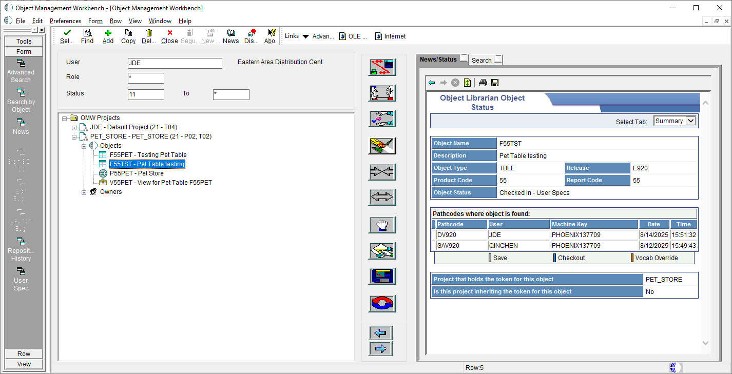

  8. Select the PET_STORE project and click Restore.
    Description of img7.png follows
    Object Management Workbench - Restore
  9. Click Yes to confirm.
    Description of img8.png follows

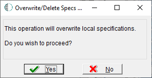

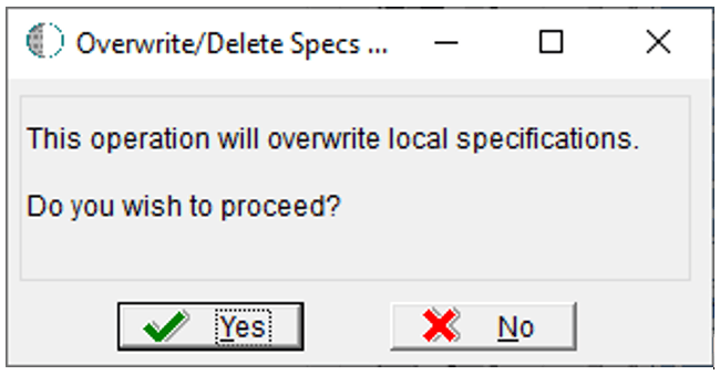

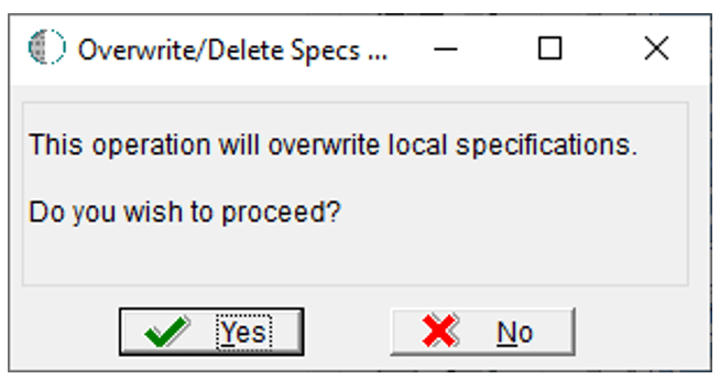

    Overwrite/Delete Specs

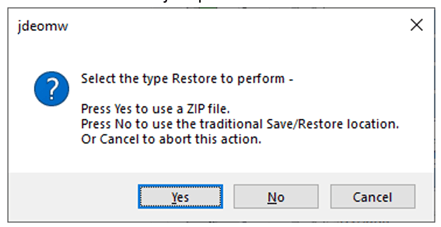

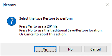

  10. Click Yes to use project par file.
    Description of img9.png follows
    Restore Type
  11. Select PRJ_PET_STORE_60_99.par file and click Open to restore.
  12. Select the PET_STORE project and click Checkout.
    Description of img10.png follows
    Object Management Workbench - Checkout

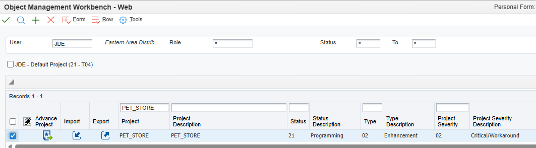

  1. Sign in to EnterpriseOne on the web client.
  2. Navigate to P98220W (Object Management Workbench – Web) from the Fast Path.
  3. In the Object Management Workbench – Web form, enter PET_STORE on Project QBE line and click Find. Select the PET_STORE project.
    Description of img13.png follows
    Object Management Workbench -Web

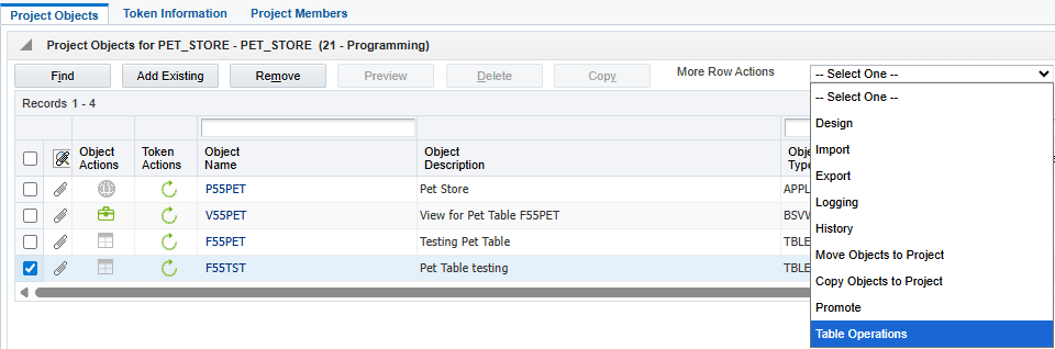

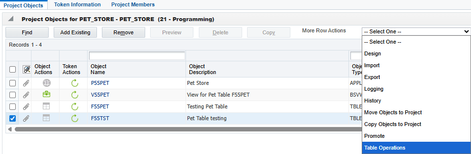

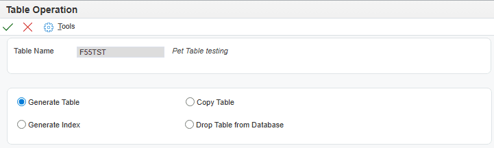

  4. From the Project Objects tab, select F55TST, then click Table Operations from the More Row Actions drop-down list.
    Description of img14.png follows
    Select Table Operations
  5. Select Generate Table and click OK.
    Description of img15.png follows
    Table Operations Window

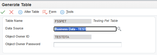

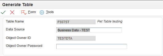

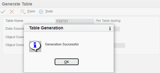

  6. Verify the target Data Source and click OK.
    Description of img16.png follows
    Generate Table
  7. Verify the result and click OK to complete.
    Description of img17.png follows
    Table Generation Result

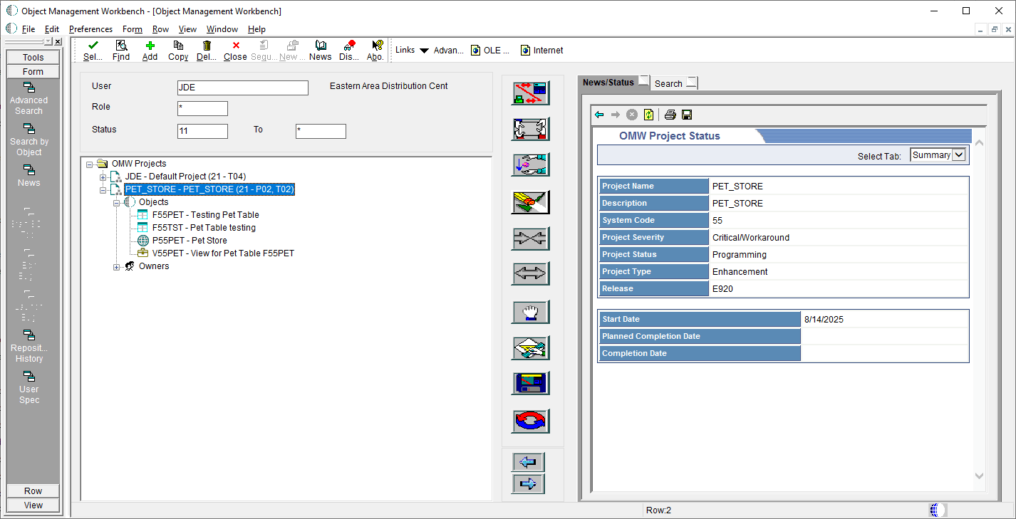

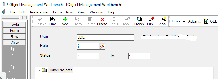

  1. Sign in to EnterpriseOne (DV920) on the development client.
  2. Navigate to OMW (Object Management Workbench) from the Fast Path.
  3. In the Object Management Workbench form, find PET_STORE project.
    Description of img18.png follows

  4. Under PET_STORE, navigate to Objects, select F55TST, then click Restore.

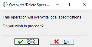

  5. Click Yes to confirm the action in the Overwrite/Delete Specs window.
    Description of img19.png follows
  6. Click Yes to use object par file.
    Description of img20.png follows
    Restore Type
  7. Restore modified TBLE_F55TST_60_99.par file (with Index changes) to test Generate Index.

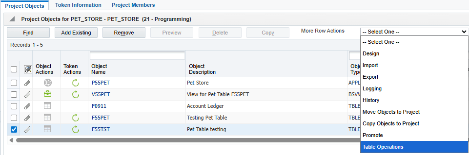

    Description of img22.png follows

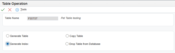

  5. Select Generate Index from Table Operation, click OK.
    Description of img23.png follows
    Table Operations window

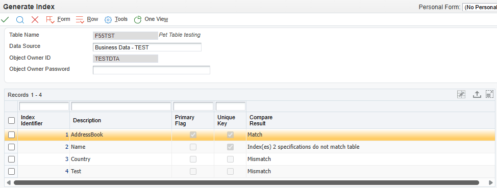

  6. Verify the target Data Source and Compare Result in the Generate Index window.
    Description of img24.png follows
    Generate Index

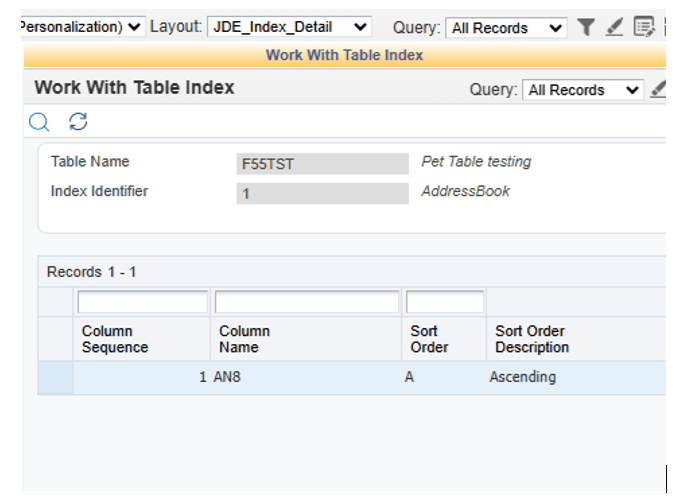

  7. The table index details are displayed using the Layout (JDE_Index_Detail).
    Description of 241.png follows
    Work With Table Index

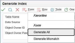

  8. From the Form menu, click Generate All.
    Description of img26.png follows
    Generate All option

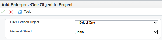

  4. From the Project Objects tab, click Add Existing. In the Add EnterpriseOne Object to Project window, select Table in the General Object field, then click OK.
    Description of img30.png follows

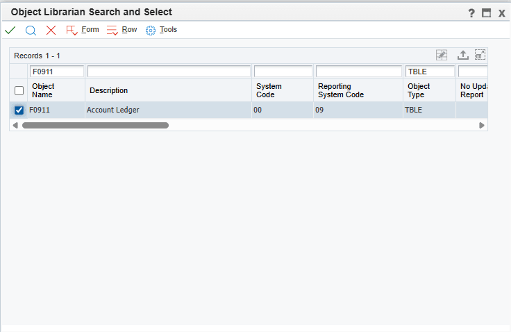

  5. Search for and select an existing table (for example, F0911 – Account Ledger) and click OK.
    Description of img31.png follows
    Object Librarian Search and Select

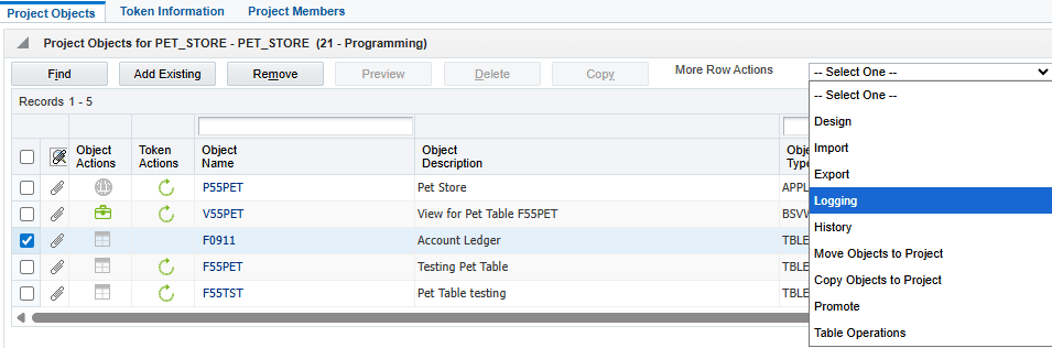

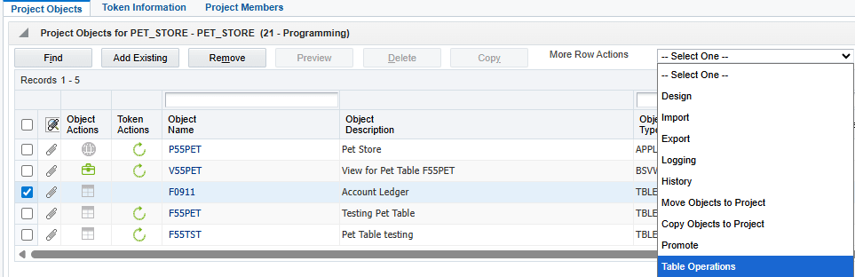

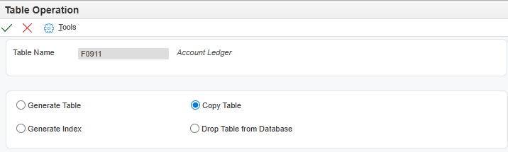

  6. From the Project Objects tab, select F0911, then click Table Operations from More Row Actions drop-down list.
    Description of img32.png follows
    Project Objects
  7. In the Table Operation window, select Copy Table and click OK.
    Description of img33.png follows
    Table Operation

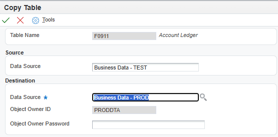

  8. Select and verify the Source and Destination Data Source and click OK.
    Description of img34.png follows
    Copy Table

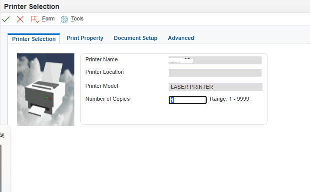

  9. Click OK.
    Description of img35.png follows
    Printer Selection

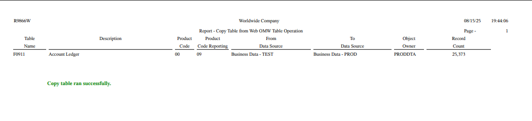

  10. Verify the result and click OK.
    Description of img36.png follows
    Table Copy

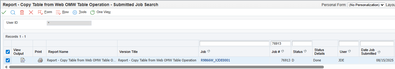

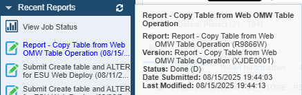

  11. Navigate to View Job Status to verify the results in Report R9866W|XJDE0001.
    Description of img37.png follows
    View Job Status
  12. Click View Output from grid column when the Status changes to ‘D’ (Done).
    Description of img38.png follows
    Report - Copy Table from Web OMW Table Operation - Submitted Job Search
  13. Verify the results.
    Description of img39.png follows
    Copy Table Report

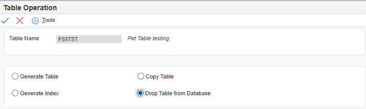

  4. From the Project Objects tab, select  F55TST, then select Table Operations from More Row Actions drop-down list.
    Description of img40.png follows
    Table Operations

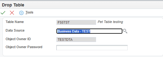

  5. In the Table Operations window, select Drop Table from Database and click OK.
    Description of img41.png follows
  6. Change the target Data Source to Business Data - TEST and click OK.
    Description of img42.png follows
    Drop Table
  7. Verify the results and click OK to complete.
    Description of img43.png follows
    Drop Table Result

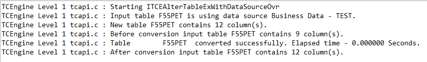

Run the ALTER Table Operation using Web OMW
Prerequisites for ALTER table:
  • Add Column(s) only.
  • Data in existing table (preserve data)
  • Alter Table uses table specifications based on the deployed or active package in the signed in environment (for example, JDV920) to run the *ALTER operation.
  • Use Promote action to update the table specifications from Central Object to the active package if needed.

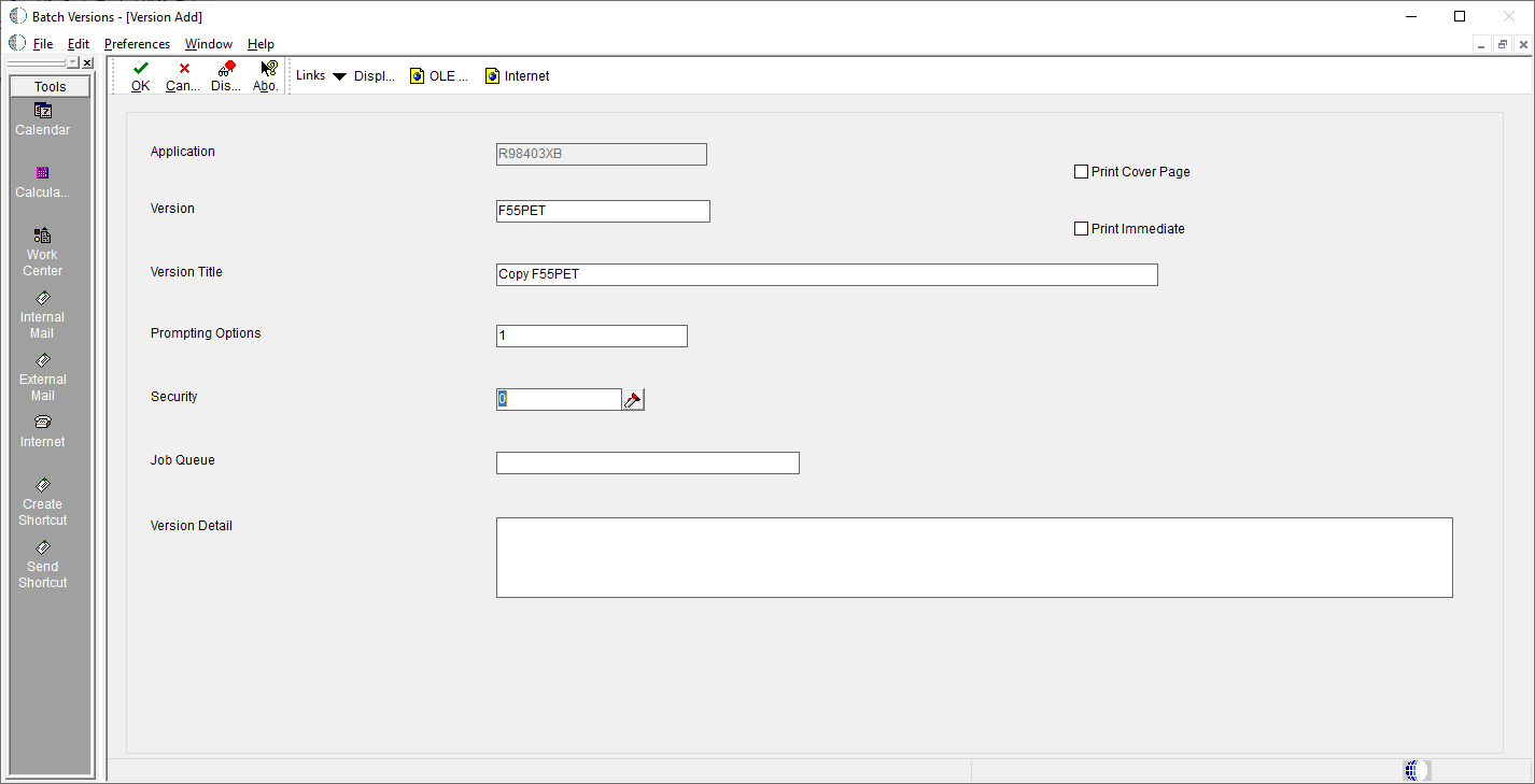

  3. In the Batch Application field, enter R98403XB (Load XML Data to Table) and click Find.
  4. Click Add to add version F55PET (Copy F55PET XML to Table).
    Description of img44.png follows
    Batch Versions

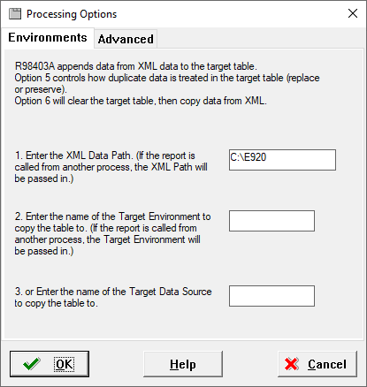

    Note: Copy F55PET.xml saved in C:\E920 (on the development client).

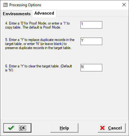

  5. Set the processing Options.
    Description of img45.png follows
    Processing Options - Environment
    Description of img46.png follows
    Processing Option - Advanced

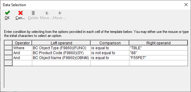

  6. Set the Data Selection.
    Description of img47.png follows
    Data Selection

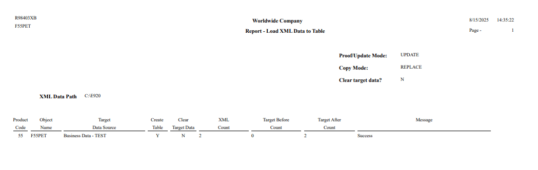

  7. Run/submit UBE R98403XB | F55PET, and verify the result.
    Description of img48.png follows
    Report - Data Table

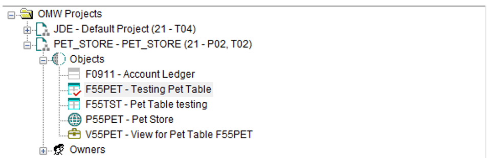

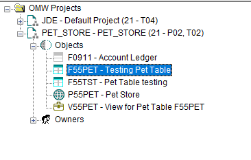

  8. Navigate to OMW (Object Management Workbench) using the Fast Path.
  9. In the Object Management Workbench form, find PET_STORE project.
  10. In the PET_STORE → Objects project, select F55PET and click Checkout.
  11. Click Yes to confirm the action in the Overwrite/Delete Specs window.
    Description of img481.png follows
    Description of img482.png follows
    Project Folder

  13. Click Yes to confirm overwrite, and click Yes again to use the object (.par) file.
    Description of img483.png follows
    Description of img484.png follows
    Restore Type
  14. Restore the modified TBLE_F55PET_60_99.par file that includes the newly added column(s) to test the *ALTER TABLE functionality. You may also navigate to Design, Design Tools, and select Start Table Design Aid to manually add new columns to F55PET.
    Description of img50.png follows
    OMW Projects
  15. Select the F55PET and click Check-in to save changes.
  3. In the OMW – Web form, enter PET_STORE on Project QBE line , click Find, and select the PET_STORE project.

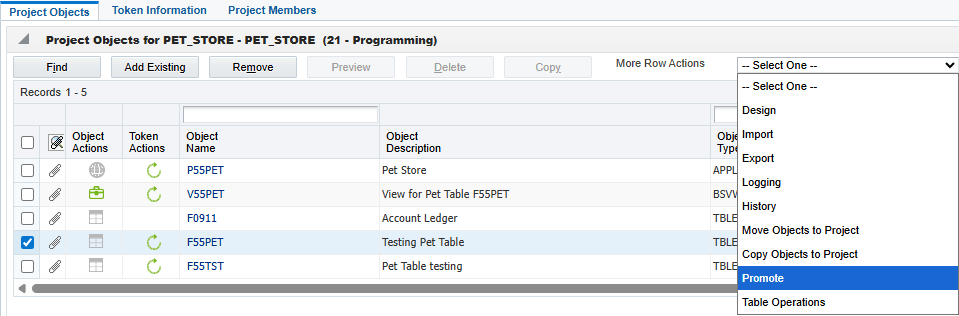

  4. From the Project Objects tab, select F55PET, then click Promote from the More Row Actions drop-down list.
    Description of img51.png follows
    Select Promote

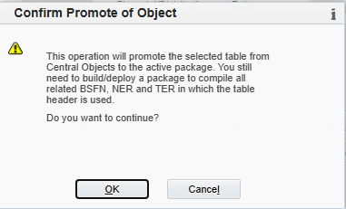

  5. Click OK to confirm the operation in the Confirm Promote of Object dialog box.
    Description of img52.png follows
    Confirm Promote of Objects
  6. From the Project Objects tab, select F55PET again, then select Table Operations from the More Row Actions drop-down list.
    Description of img53.png follows
  7. In the Table Operations window, select Generate Table and click OK.
    Description of img54.png follows
  8. Verify the Target Data Source, then click OK.
      Description of img55.png follows
      Generate Table window

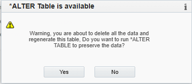

    1. If the *ALTER operation is applicable, the Form Menu automatically displays in Alter Table.
    2. Click OK, you are prompted to choose whether to run *ALTER (Yes) or proceed with a full table generation (No).
    3. Select Alter Table to proceed with the non-destructive *ALTER operation.
  9. In the Alter Table is available confirmation dialog box, click OK.
    Description of img56.png follows
    *ALTER Table

  11. Review the *ALTER TABLE log in the PrintQueue folder on the enterprise server to ensure the operation completed successfully.
    Description of img58.png follows
    *ALTER Table Log

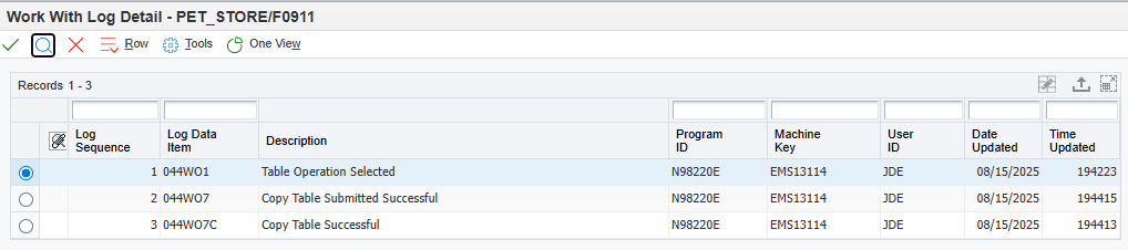

  4. In the Project Objects tab, select F0911, then choose Logging from the More Row Actions drop-down list.
    Description of img60.png follows
    Select Logging Option

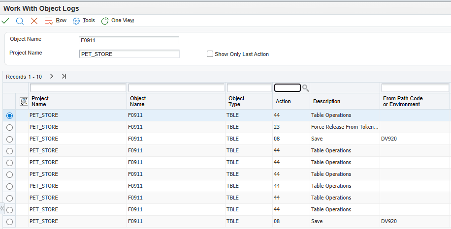

  5. On the Work With Object Logs form, click Find to retrieve the log entries.
  6. Locate and select the entry with Action = 44 (Table Operations), then click Select.
    Description of img61.png follows
  7. Select each line to review the log details and click Select to view more information.
    Description of img62.png follows
    Work With Log Details

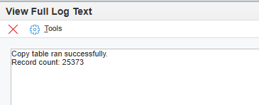

    Description of img65.png follows
    View Full Log Text
