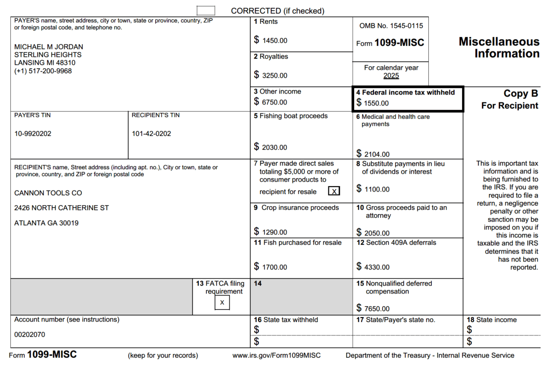

  • The Blank Sheet format for 1099-Misc, 1099-Div, 1099-Int, 1099-G, and 1099-NEC: This template prints two per page on a blank paper for 1099-Misc, 1099-Div, and 1099-Int, and three per page for 1099-G and 1099-NEC. This is a copy of the Copy B that the IRS provides. This template will print the boxes as well as the data that they contain.
    Example of 1099-MISC Blank-Sheet format.
    You can also use this template as an example to customize a template to generate Blank-Sheet format for the other 1099 forms.

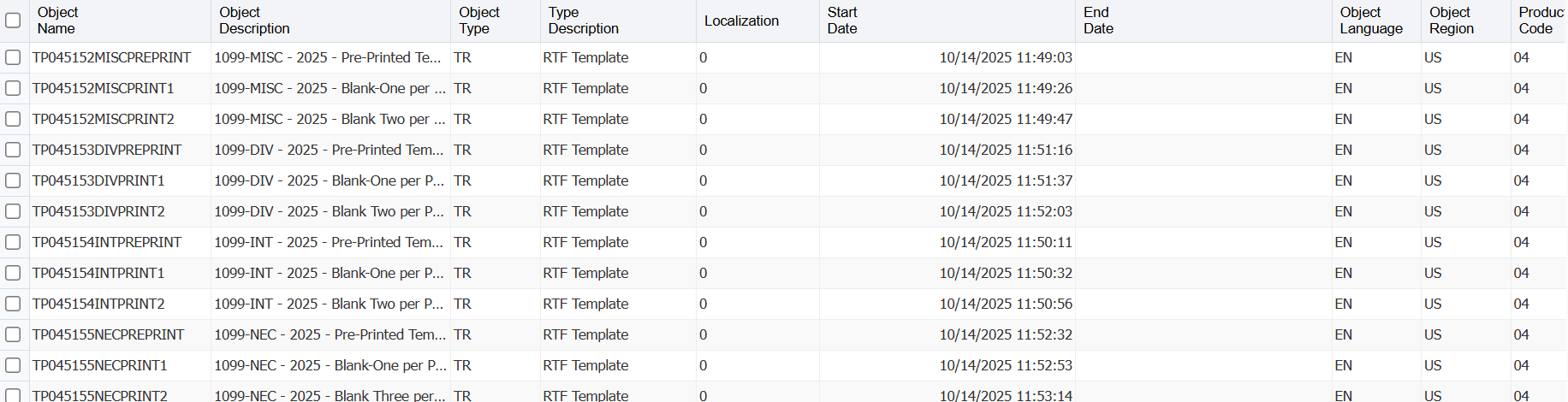

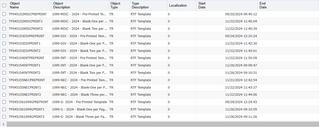

    3. Open the BI Publisher Object Repository (P95600) and in the Object Name QBE field, enter TP045* to view all the templates available for 1099.
    4. Select the RTF Burst template for the type of return you have selected, and download the template from the Row exit.
    5. On the BI Publisher tab, click the Sample XML button to load the source xml that you have downloaded, and then click the PDF icon under the BI Publisher tab to print the final Burst mode (One per page) PDF output.
    BI Publisher Object Repository: List of 1099 Templates.

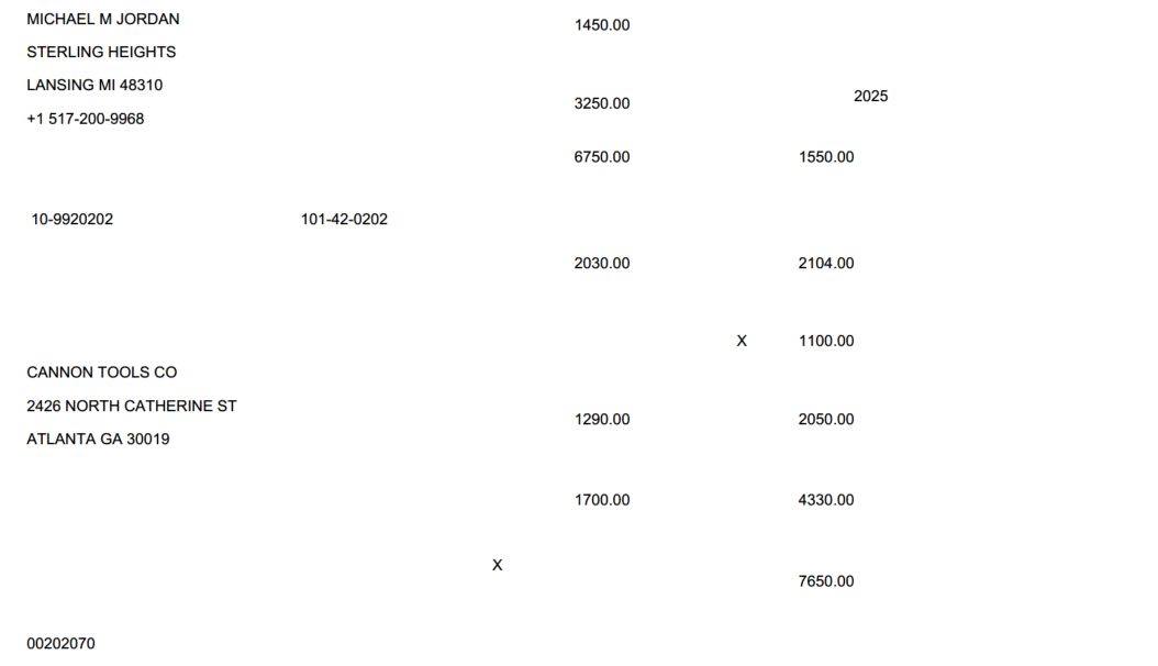

    1099-MISC Pre-Printed format - This template prints two forms on each page (2-UP), without Recipient instructions. This is a copy of the "Copy B" provided by IRS, with just the data printed, without any boxes.
    Example of the 1099-MISC form for 2025- Preprinted Version.
    Note: You can also use this template as an example to customize a template to generate Pre-Printed format for the other 1099 forms.
