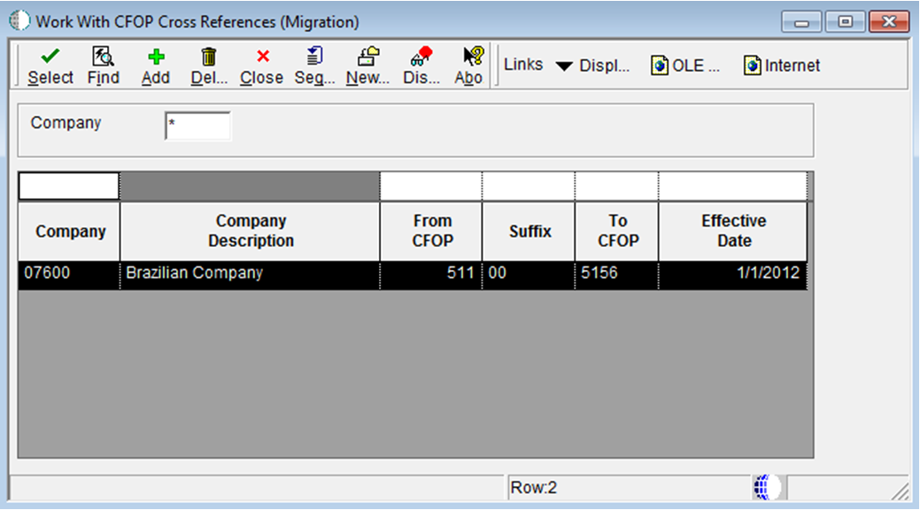

P76B2002 |
When migrating from JD Edwards World A9.2.1, A9.3.1, or A9.4 releases and using Brazil Localization module. |
None. |
Translates the three-digit Transaction Nature Codes and two-digit Transaction Nature Suffixes to four-digit Transaction Nature codes when migrating the F7615B from World to EnterpriseOne. |
The cross reference must be setup prior to running the Table Conversion Workbench. |
