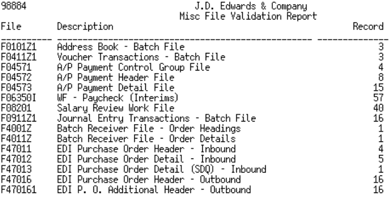

Miscellaneous File Validation (P98884)
This program is run to provide a report that lists work files that need to be validated. These files need to be reviewed before executing the remainder of the migration programs, as it might be a warning that a process should be completed in the JD Edwards World environment. Failure to complete any pending process could cause data corruption in the JD Edwards EnterpriseOne tables. The file that drives this report is the F98884 and is delivered in the Software Update. If all the files registered in the F98884 have a zero record count, the message “All of the files identified contain zero records" prints on the report.
