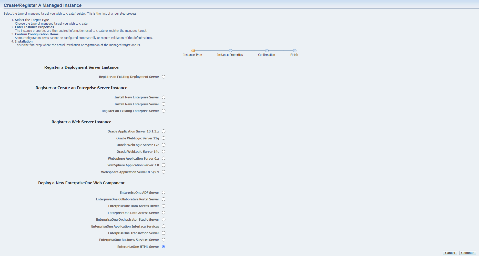

  3. On Create/Register a Managed Instance, Instance Type, select the EnterpriseOne HTML Server radio button.
  4. Creating an EnterpriseOne HTML server
  5. Click Continue.

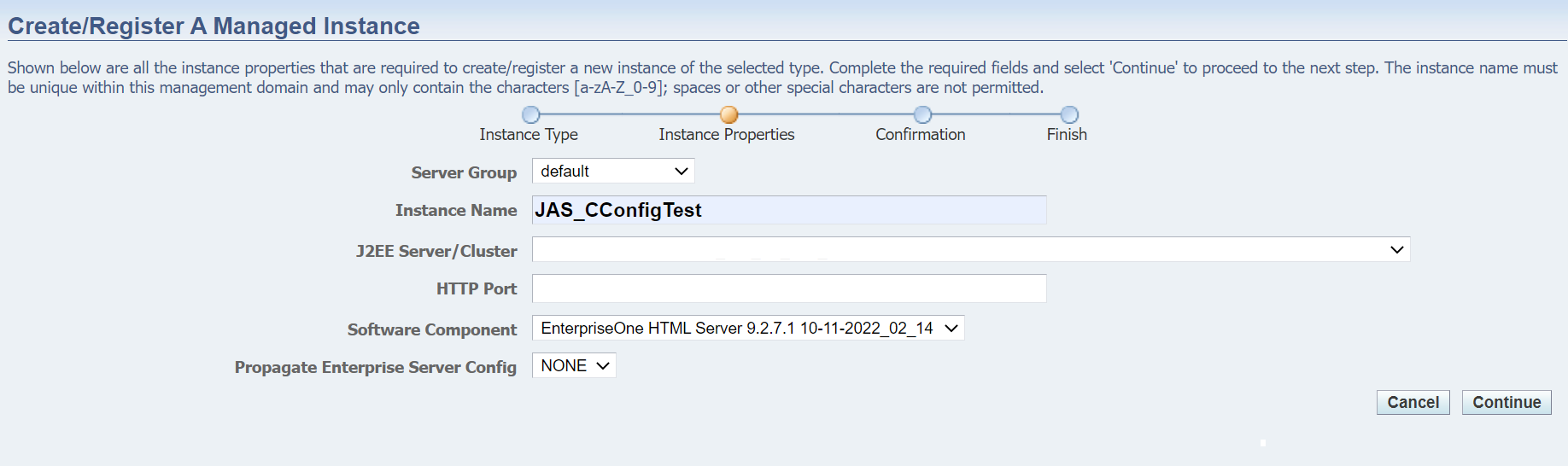

  6. On Create/Register a Managed Instance, Instance Properties, complete these fields:
    Field Value
    Server Group Use the drop-down menu to select the default server group.
    Instance Name Enter JAS_CConfigTest as the instance name.
    J2EE Server Use the dropdown to select a valid J2EE server.
    HTTP Port You must ensure that the port that you specify is available and is not being used by any other application currently installed and running on the server on which the application server is running.
    Software Component Use the dropdown to select the version of this Software Component that you wish to install.
    Propagate Enterprise Server Config By default, the selected item is set to NONE. Selecting NONE signifies that you do not wish to propagate configurations from any available enterprise server. Keep the selection as NONE.
  7. Instance properties of EnterpriseOne HTML server
