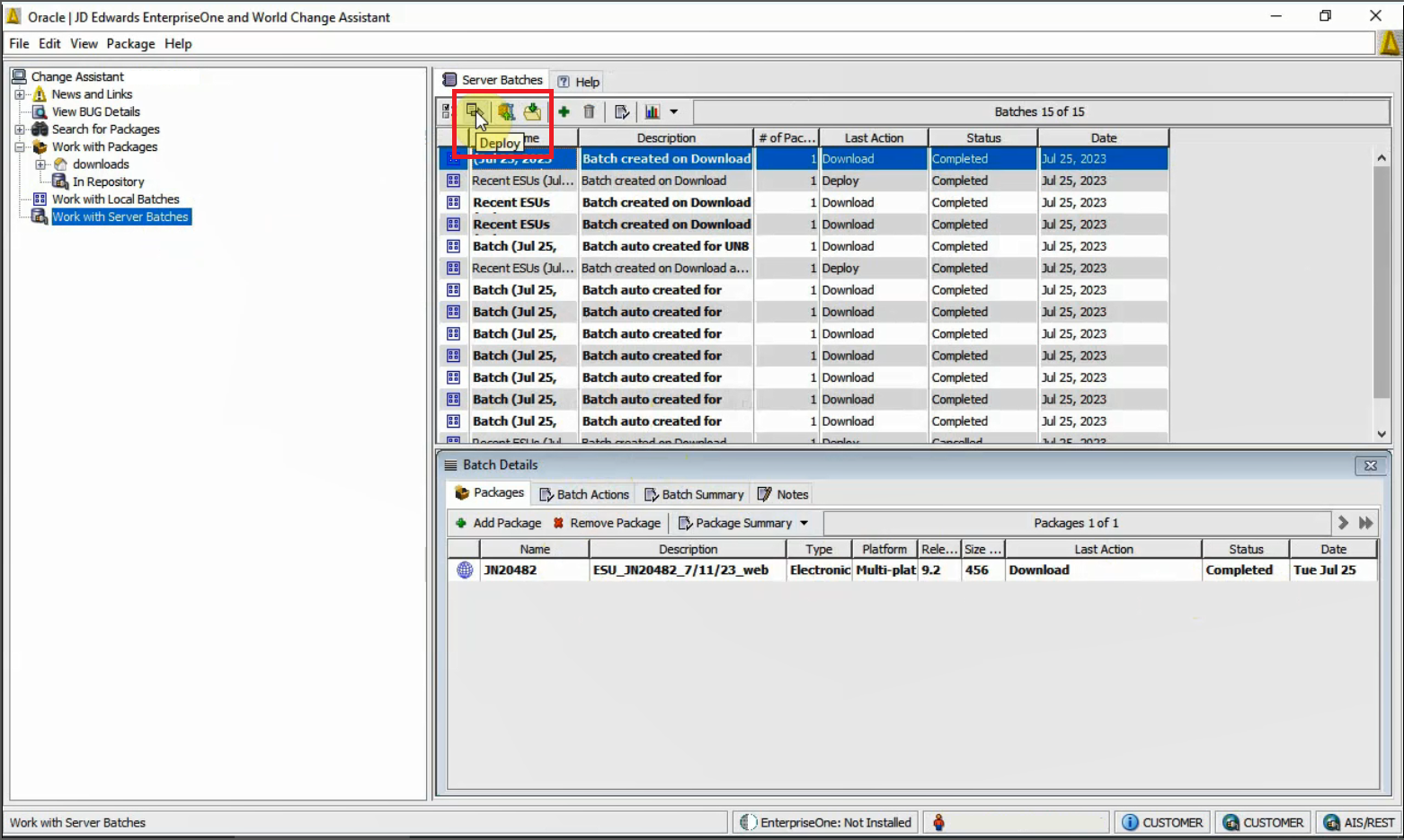

  7. Navigate to the Work with Server Batches directory in the Change Assistant tree structure. Select the batch that you downloaded. A list of packages included in that batch appear in the Batch Details pane. Review the download status of the packages.
    Change Assistant - Advanced Search
    Change Assistant - Work with Server Batches
  8. Select the batch you downloaded, and then click Deploy. The Software Update Environment Selection form appears.
    Work with Server Batches - Deploy Option

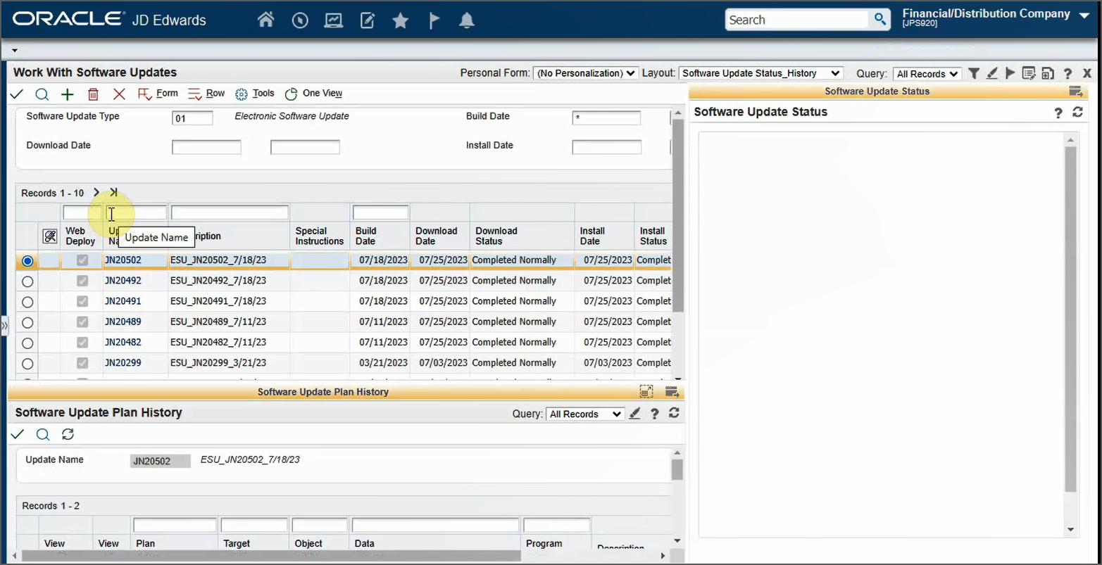

  1. Log in to the HTML Server and access the Work With Software Updates - Web application (P96470W).
    Change Assistant - Search for Packages
  2. Search and select the software package that you deployed. The Software Updates Status pane on the Work with Software Updates form shows the completion status.
    P96470W - Software Updates Status Pane
  3. You can view the list of generated reports in the CafeOne window (Software Update Plan History) of the Work With Software Updates form. Click on the View Ouptut icons in the Software Update Plan History section to view the corresponding reports.
