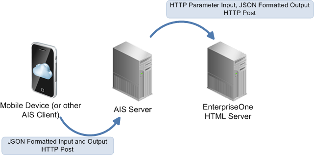

EnterpriseOne Rest Services Interface
The following illustration shows JSON input and output over HTTP Post:
This illustration shows the communication from the client (which can be a mobile device or other AIS client) to the AIS Server and the AIS Server's communication with the EnterpriseOne HTML server, where the EnterpriseOne forms run and the data is gathered. All client communication uses JSON formatted strings.
You can make REST calls directly to the AIS Server without using the JDE Mobile Framework APIs. Use a REST service testing tool to call AIS services directly by sending JSON text to the URL for the service. All services are accessed using URLs with this format: http://<aisserver>:port/jderest/<uri>, where uri is the path to the various types of services such as formservice, file, defaultconfig, and poservice. For a list of all services that are available on the AIS Server, see Working with the EnterpriseOne REST Services Interface in this guide.
