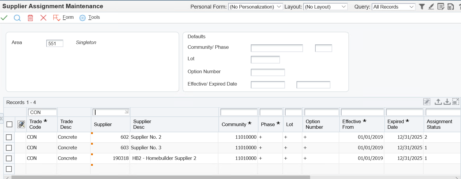

section 0Setting Up the TBD Supplier for Takeoff Contracts
  1. Access the Supplier Assignment Maintenance program (P44H604) and create new records.
  2. Use the information in the table below to add the supplier assignment records.
    Trade Code               Supplier  Community Phase
    Lot
    Option Effective From Expired From Assignment Status
    1 CON 602
    11010000
    01/01/2019
    12/31/2025
    2
    2 CON 603
    11010000
    01/01/2019
    12/31/2025
    1
    3 CON 190318
    11010000
    01/02/2019
    12/31/2025
    1
    Your Supplier Assignment Maintenance records should look like this:
    Description of takeoff2.png follows
    TBD Supplier in the Supplier Assignment Maintenance Report
    Note that Supplier 602 has Assignment Status 2.

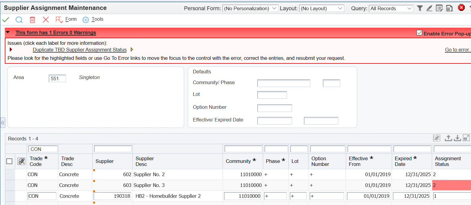

  3. Update the Assignment Status as 2 for the Supplier 603. The system displays this error message:
    Description of takeoff3.png follows
    Supplier Assignment Maintenance - Error Message
    Note: For takeoff contracts, the application enables you to assign a unique supplier as TBD for a given Trade Code and Community.

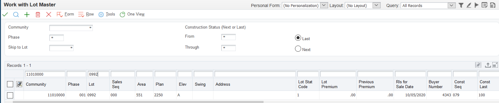

  1. To create a lot using the Lot Master Revisions program:
    Complete these fields in the Lot Master tab:
    • Community: 11010000
    • Phase: 001
    • Lot: 0992
    • Address: Enter the address, city, state, and postal code
    • Cost Code Template: Enter the area code or the community code
    Complete this field in the Construction tab:
    • Commitment Start Date: 01012020
  2. Select the newly created Lot Master record, and from the Row exit, select Release for Sale.
  3. Select the newly created Lot Master record, and from the Row exit, select Sales and Buyer and assign the following:
    • Plan/Elev/Swing: 2250 A
    • Buyer Number: 4343
    The Work with Lot Master form should look like this:
    Description of takeoff4.png follows
    Lot Record in Lot with Work Master Form

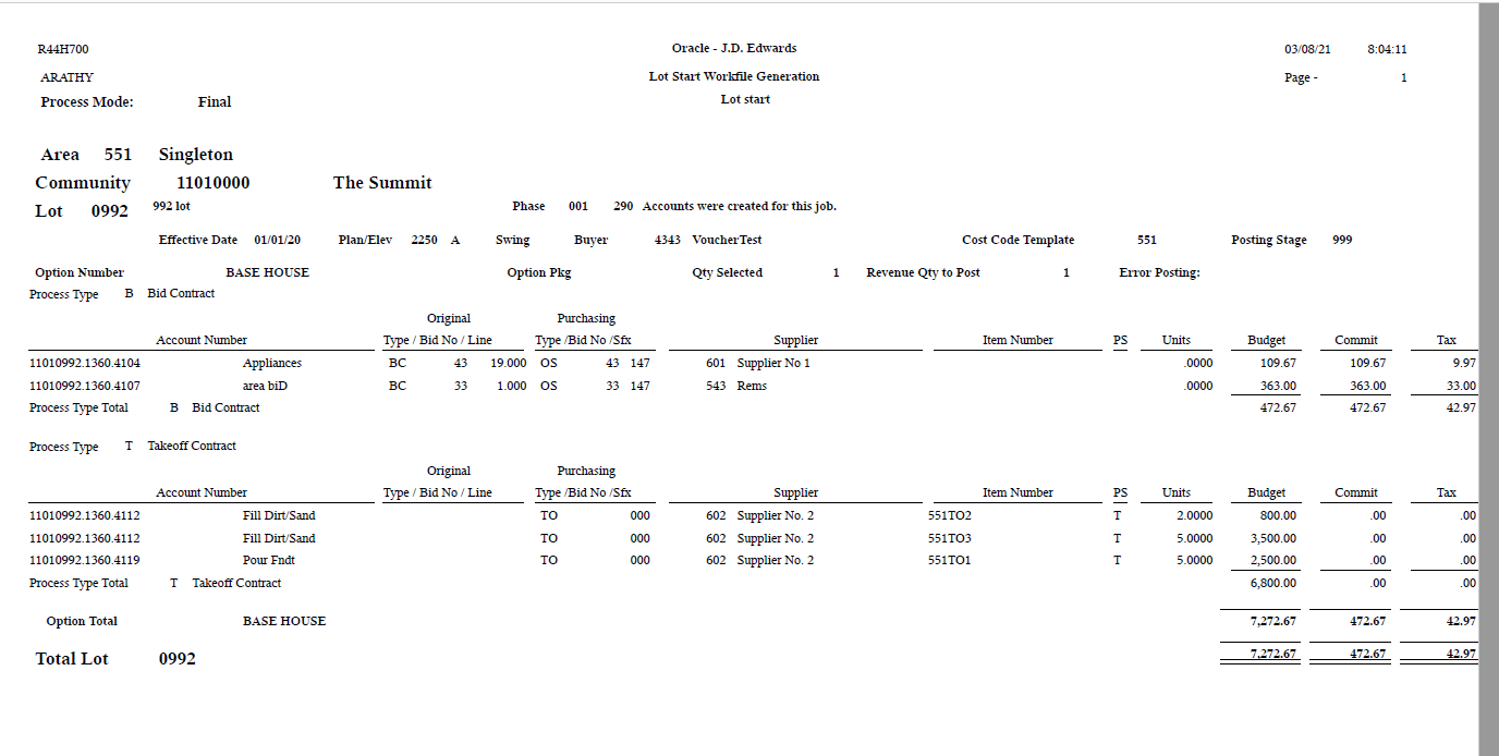

section 3Running Lot Start Workfile Generation (R44H700) for the Lot
  1. Access the Work with Batch Versions program (BV).
  2. Enter R44H700 in the Batch Application field.
  3. Set Community and Lot Number as the data selection criteria.
  4. Set the following processing options with these values:
    • Processing Mode: 2-Final
    • Copy Budget from Cost Code Template: 1- Copy Budgets
    • Create Budgets: 2- Budget entire job (Purchasing)
    • Costing Method: Blank- Process Bids and Takeoffs
  5. Your Lot Start Workfile Generation report should look like this:
    Description of takeoff5.png follows
    Lot Start Workfile Generation Report

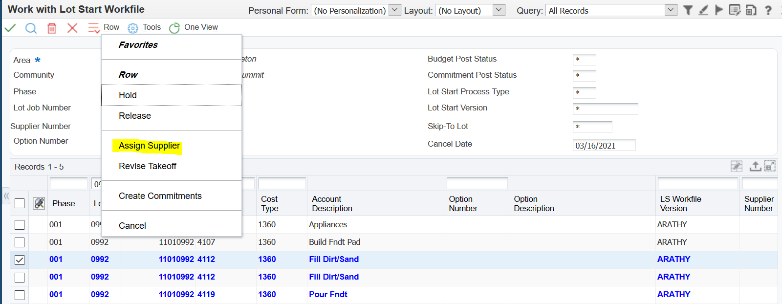

  2. From the Row exit, select Assign Supplier.
    Description of takeoff6.png follows
    Assign Supplier in Row Menu

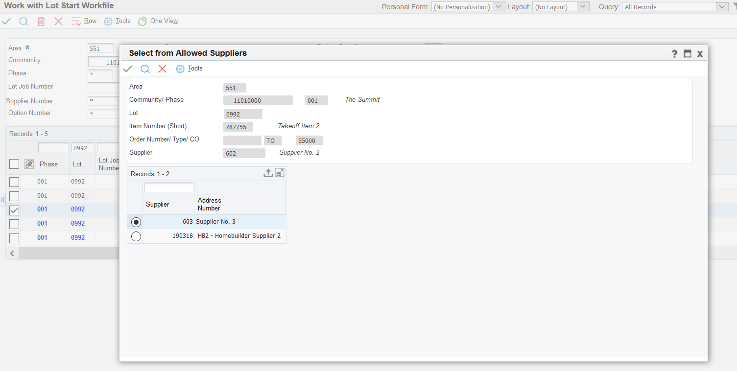

  3. The system displays the Select from Allowed Suppliers window with the list of eligible suppliers, that is, suppliers with Assignment Status 1.
    The Select from Allowed Suppliers window should look like this:
    Description of takeoff7.png follows
    Select from Allowed Suppliers Window
  4. Select the eligible supplier from the list so that the record can be considered for commitments.
    Note: Only the eligible suppliers with Assignment Status 1 are listed for commitment in the Select from Allowed Suppliers form for both takeoffs and bid contracts.

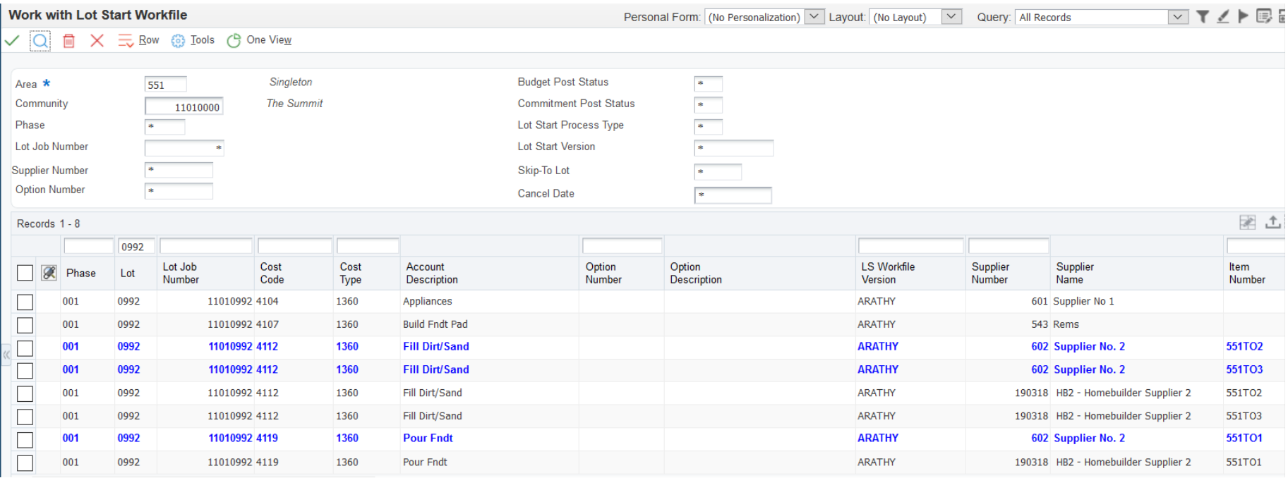

    When the TBD record, that is, the record in blue font, is assigned with an eligible supplier for the takeoff contract, a corresponding new record in black font is generated. These lines are now ready to be processed for creating a commitment.
    Your Work with Lot Start Workfile should look like this:
    Description of takeoff8.png follows
    Eligible Supplier Record in Work with Lot Start Workfile
