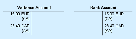

For variance tolerance entries, the calculations are:
CA (F0911) − CA (F0917) = CA difference
2,015.00 − 2,000.00 = 15.00 EUR
AA (F0917) / CA (F0917) = exchange rate
3,120.00 ÷ 2,000.00 = 1.56
CA difference à exchange rate = AA difference
15.00 Ã 1.56 = 23.40 CAD
For gain/loss entries, the calculations are:
AA (F0911) − AA difference = Adjusted AA amount (F0911)
3,125.16 − 23.40 = 3,101.76 CAD
Adjusted AA amount (F0911) − AA (F0917) = gain/loss
3,101.76 − 3,120.00 = –18.24 CAD
