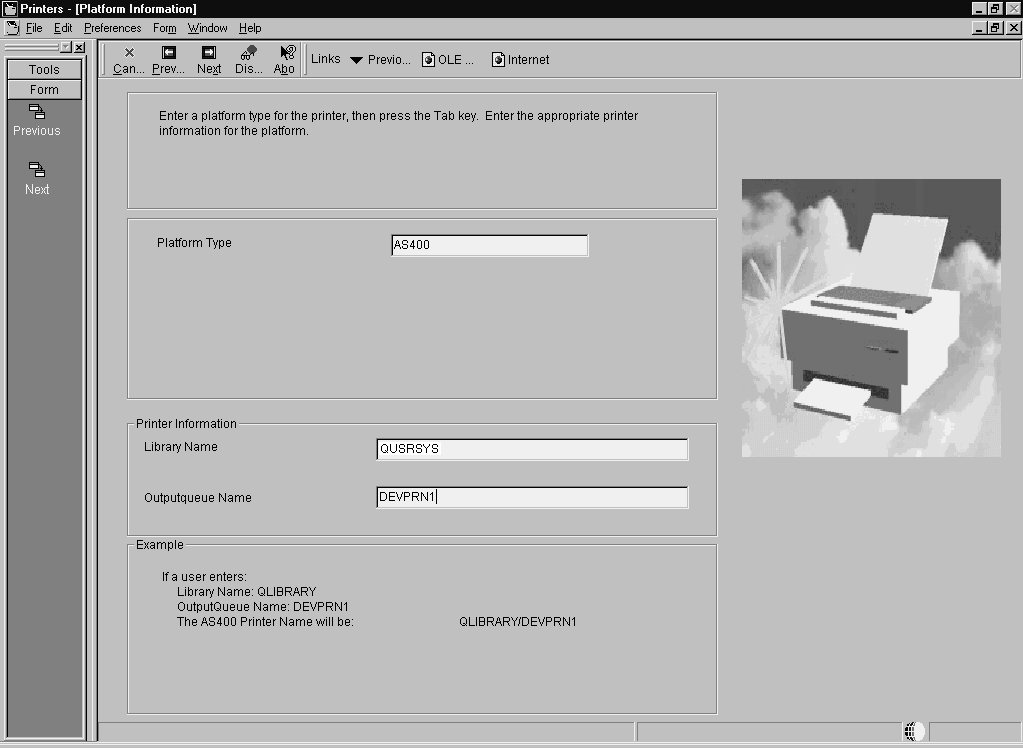

    The Platform Information form appears. The platform type may appear by default, depending on the operating system on which Release 9.2 is running.
    This image is described in the surrounding text.
  4. On Platform Information, complete these fields:
    Field
    Description
    Platform Type
    Enter the platform type on which you are installing or use the visual assist button to select a platform type.
    Library Name
    The physical printer name must be the same as the outqueue name. If you use the default QGPL library to store your outqueues, you need only enter the outqueue name in this field. Valid characters are all alpha (A-z), numeric (0-9), at ( @ ), and underscore ( _ ).
    Ouputqueue Name
    If your outqueues reside in a library other than the default QGPL library, you need to enter the library name and the outqueue name in this field. For example, QUSRSYS\DEVDES3A. Valid characters are all alpha (A-z), numeric (0-9), at ( @ ), and underscore ( _ ).
  5. After you complete the requisite fields, click Next to access the Printer Setup form.

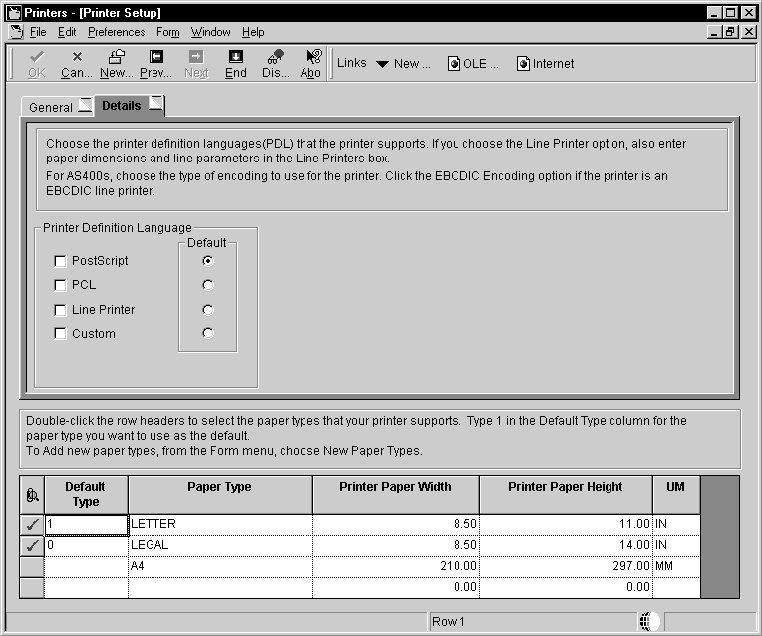

    Use this form to set information for the printer such as the printer model, physical location of the printer, printer definition language (PDL), and paper types.
  6. On the General tab, complete these fields:
    • Printer Model
    • Printer Location
  7. On the Details tab, in the box labeled Printer Definition Language, select one of these options:
    • PostScript
    • PCL
    • Line Printer
    • Custom
  8. In the Default box, specify one of the Printer Definition Language options as the default value.
    You can select multiple PDLs, but only one default PDL. A user can override this default PDL at the time a batch process is submitted.
    Choosing PostScript or Printer Command Language (PCL), Release 9.2 disables the Line Printer option. Choosing Line Printer, Release 9.2 disables the PostScript and PCL options.
    When choosing the Line Printer option, this logic occurs:
    • Release 9.2 disables the grid at the bottom of the form and any paper types you have chosen are cleared.
      JD Edwards EnterpriseOne automatically provides a printer type of *JDE LINE PAPER for the printer.
    • The Fields in the box labeled Line Printers are used to set the paper dimensions and line parameters.
      This procedure is explained in later steps in this section.
    The custom option uses advanced features of the printers application, which are explained in the later steps in this procedure.

  16. In the grid at the bottom of the Printer Setup form, double-click the row header for each paper type that your printer supports. A checkmark appears in the row header for each paper type that you select.
    You can add new paper types as necessary. Instructions are included later in this task.
  17. In the Default Type column, enter the numeral 1 in the row for the paper type you want to use as the default.
    select only one paper type as the default. A user can override the default paper type when a batch process is submitted.

  18. To add a new paper type, continue with these steps:
  19. From the Form menu, select New Paper Type.
    The Work With Paper Types form appears.
  20. Click Add.
    The Paper Type Revisions form appears.
  21. Complete these fields:
    • Paper Type
    • Paper Height
    • Paper Width
    • Unit of Measure
    The software saves the new paper type.
  22. Click OK to return to the Work With Paper Types form, and then click Close to return to Printer Setup.
    The new paper type is available in the grid on the Printer Setup form. All previous paper type selections are cleared and must be reselected if you want to use them again.
  23. When finished entering information for the printer on the Printer Setup form, click End.
