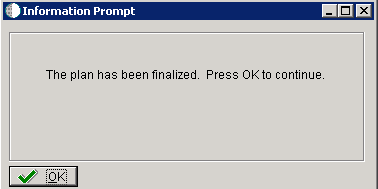

When you click No on the Location dialog, the Planner begins to finalize the plan, as indicated by a status message in the lower left-hand portion of the screen:
Installation Planner displays a message to let you know that the installation plan has been finalized.
On the Information Prompt that indicates Installation Planner has concluded, click the OK button to exit the message box and initiate the Planner Validation Report.
If the processing option default was selected, Planner Validation Report automatically prompts you to run this report.
If the processing option default was not selected, click the Validate node on the tree view of your plan to initiate the Planner Validation Report.
