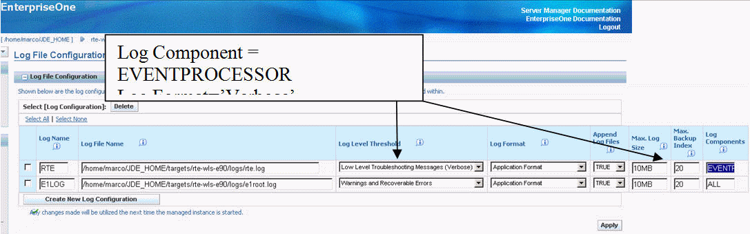

Tip: To obtain a more detailed set of logs, you can use Server Manager to enable enhanced logging. For the Log Name with a value RTE, change the Log Components value to EVENTPROCESSOR as shown below.
Once the additional jdelog.properties definition is added as described in the preceding step, stop the Transaction Server, clear the RTE logs and produce the logs generated after going through the steps outlined in Testing and Validating the JMSQUEUE Configuration.
