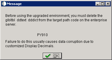

Note: In order to
avoid issues with the JD Edwards EnterpriseOne Data Dictionary after an Upgrade, if
you are running Table Conversions on the Enterprise Server, the Installation
Workbench displays the following Message: This message warns that before using the upgraded environment, you must delete
the glbltbl, ddtext, and dddict spec files from the target path code on the
Enterprise Server. Failure to do this usually causes data corruption due to
customized Display Decimals. At this point you should delete these spec files
as instructed, and then click the OK button in the Message to
continue.
