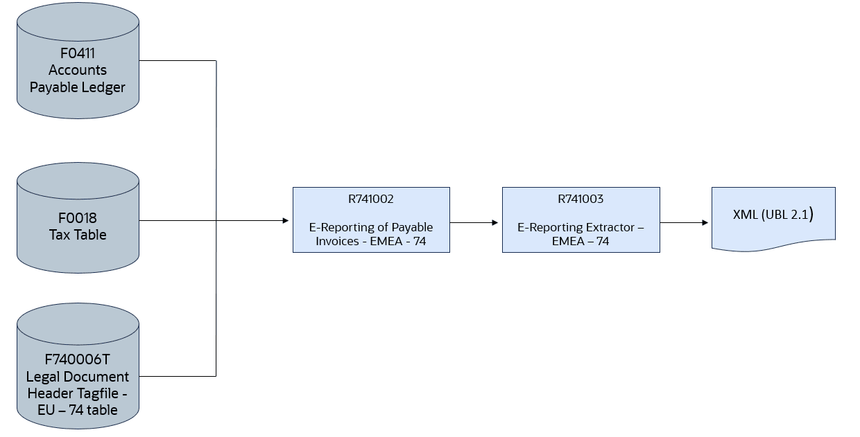

This image shows the basic process flow of the extraction and reporting of Accounts Payable invoice data in JD Edwards EnterpriseOne solution.
Basic Process flow for EU Inbound Electronic Invoice

Run the E-Reporting of Payable Invoices - EMEA - 74 (R741002) batch version program. These programs identify all Accounts Payable vouchers that are eligible for E- reporting based on the parameters you set in the processing options.

The system processes the voucher records, retrieves the invoice and tax details, and automatically calls the extraction program E-Reporting Extractor – EMEA – 74 (R741003) to generate the final XML file for each voucher.
