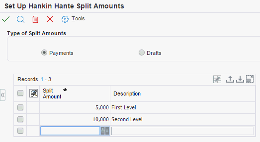

Setting Up Payment Split and Draft Split Amounts
Access the Set Up Hankin Hante Split Amounts form.
Payments
Select to specify that the split amount is for payments.
Drafts
Select to specify that the split amount is for drafts.
Split Amount
Enter the amount at which the system splits payments or drafts in the Hankin Hante process. The system stores split amounts for payments and drafts in the F75J04SA table.
