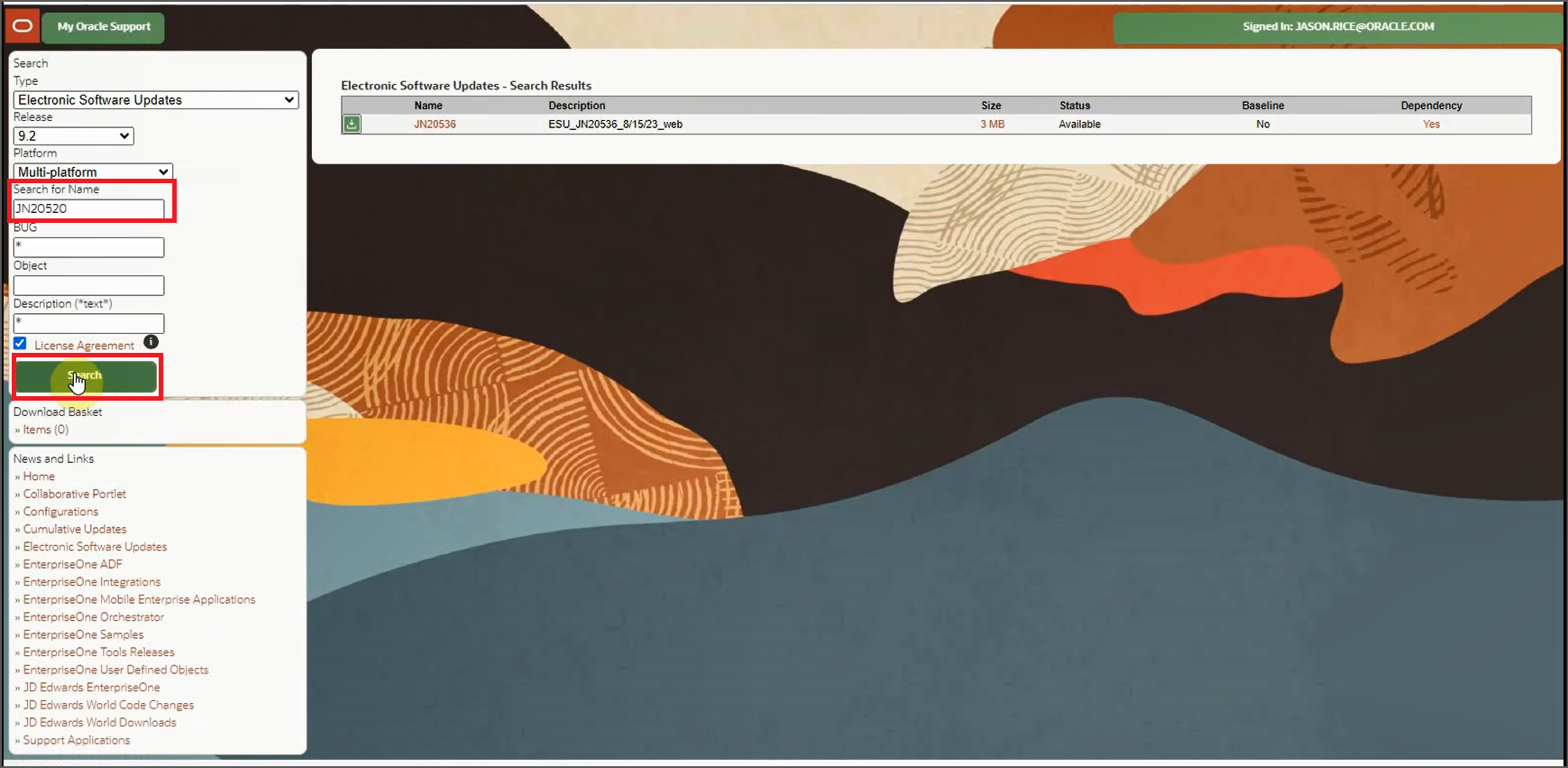

To download an Electronic Software Update file (ESU) from the Update Center:
- Access the Oracle JD Edwards Update Center.
- In the Search section, enter the ESU name in the Search
for Name field and click Search.
Oracle JD Edwards Update Center - ESU Search OR
Set these criteria:- In the Type field, select Electronic Software Updates.
- In the Release field, select 9.2.
- In the Platform field, select Multi-platform.
- Click Search.
Oracle JD Edwards Update Center - ESU Search Criteria - Review the search results.

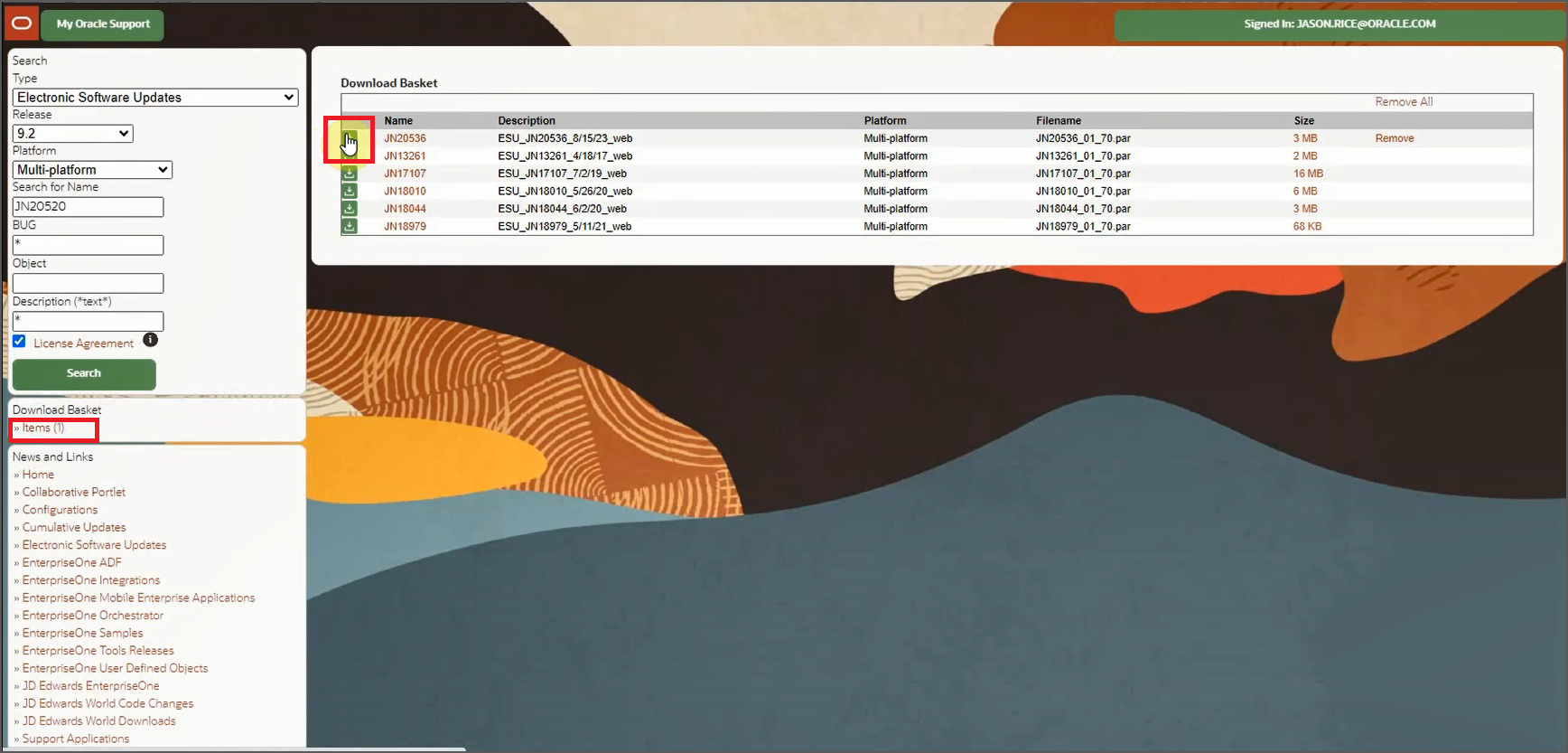

- Click the download icon to download the ESU with special
instructions to your Download Basket.
ESU Download Basket on the Oracle JD Edwards Update Center - Click Items link in the Download
Basket section and click the download icon
corresponding to the ESU you downloaded.
Update Center - Download Basket Items Link

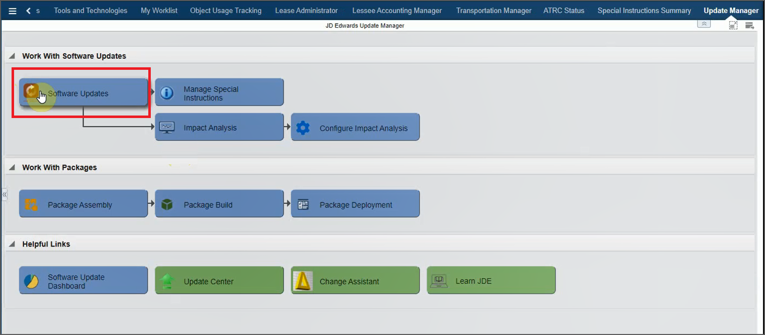

- Sign in to EnterpriseOne on the web client.
- From the Software Updates menu (GH9612), select the Work
with Software Update application (P96470W) OR click
Software Updates on the Update Manager
process page.

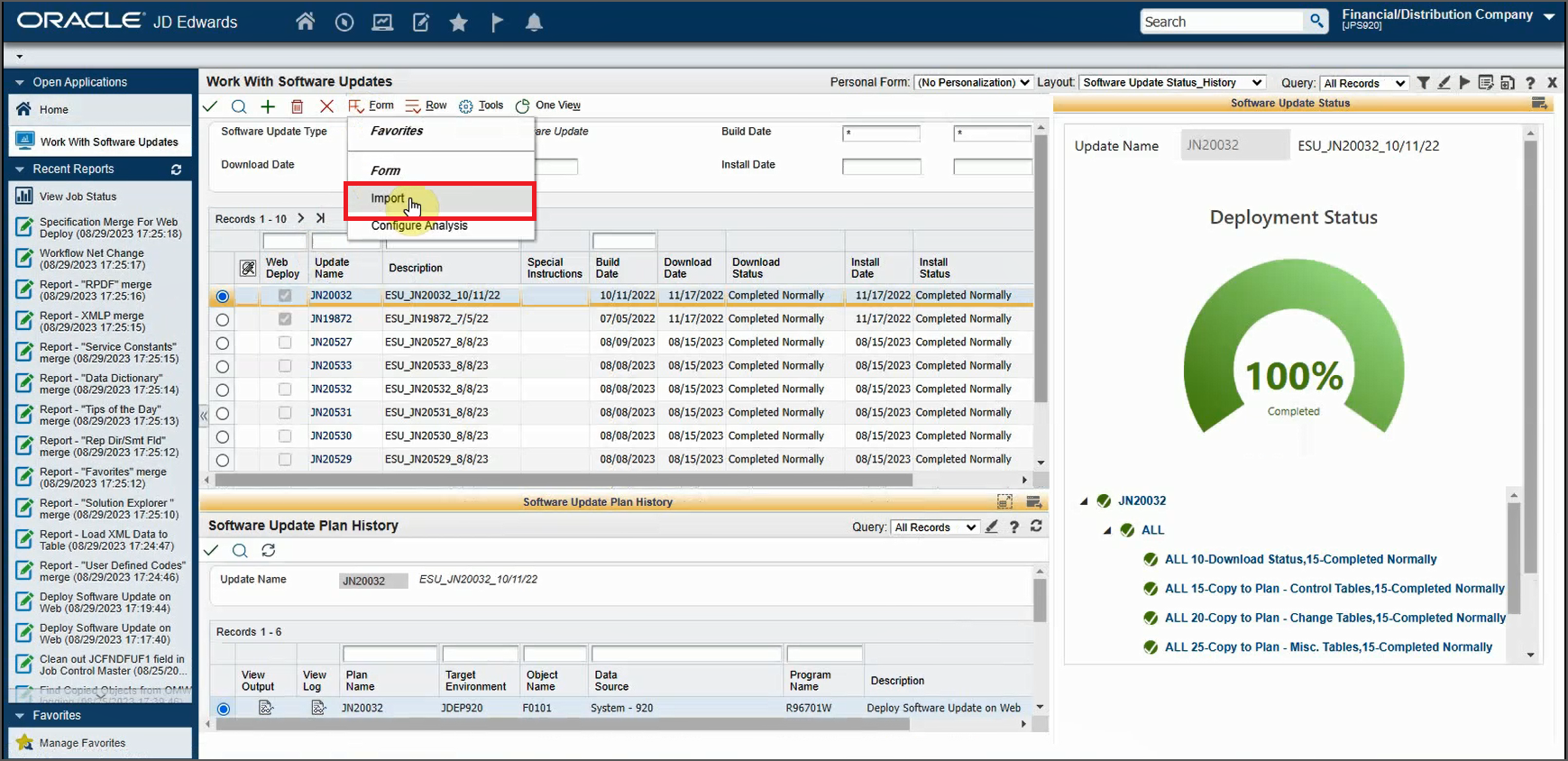

Update Manager Process Page - Select the Form exit and click Import.

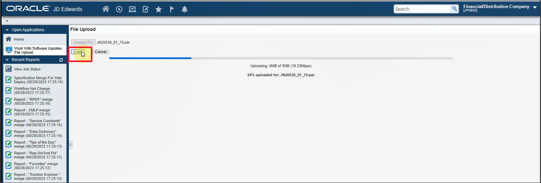

Work With Software Updates Form - Import ESU Option - Click Choose File and access the
downloaded file. Only one ESU can be imported at a time.
Work With Software Updates Form - File Upload - Click Load. The file is uploaded to the
system. The Work with Software Update
(P96470W) form refreshes with the new ESU in the grid and the
deployment process is initiated.
Work With Software Updates Form - File Upload Process

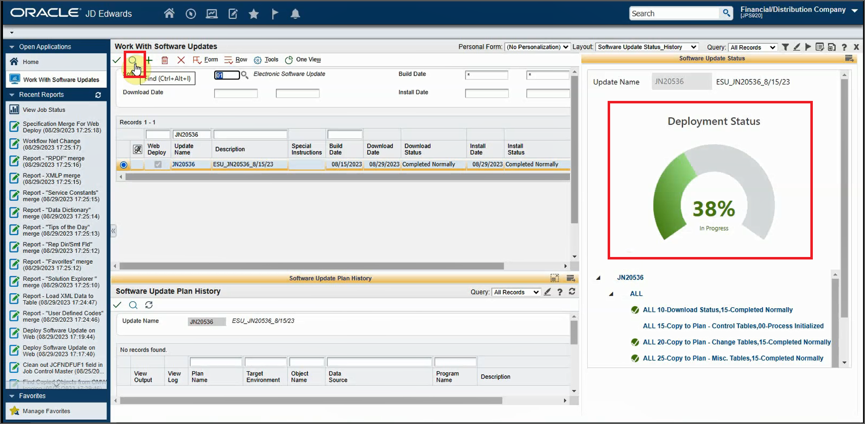

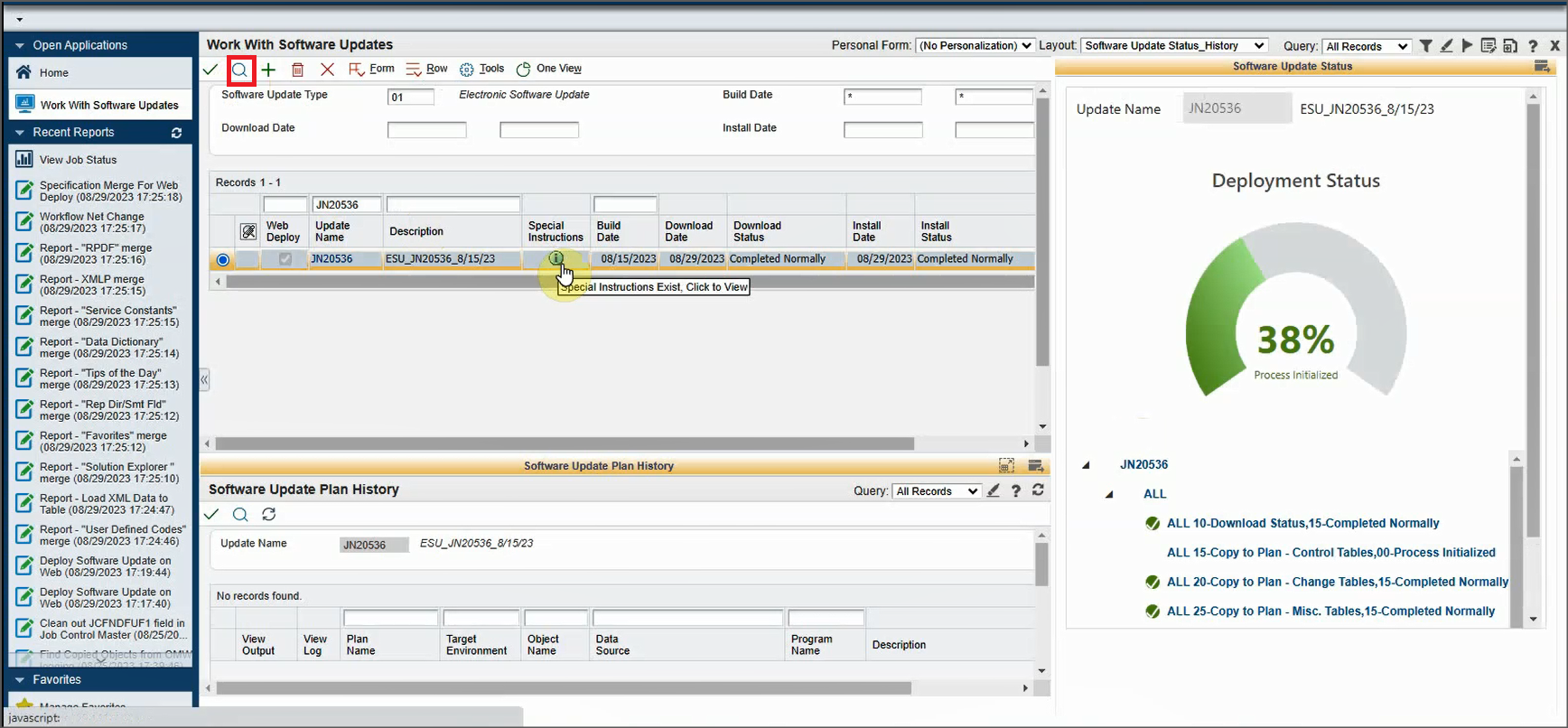

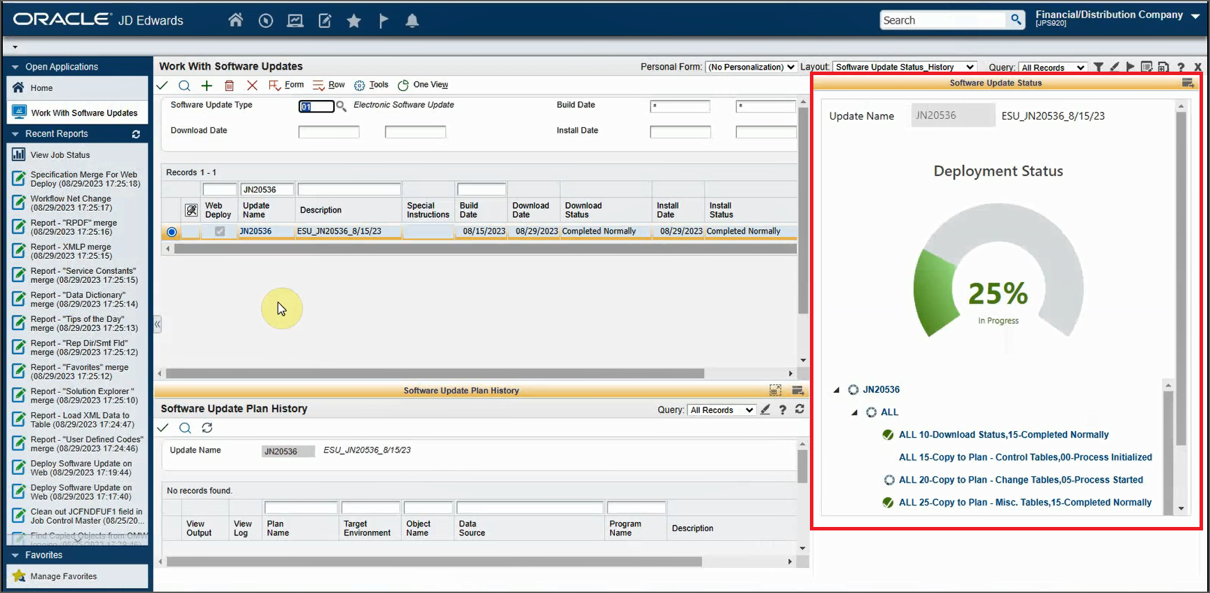

Work With Software Updates Form - Deployment Process Initiation - The system then populates the Software Update Status
window on the screen which displays a visual of the deployment
status highlighting the current deployment step and the
percentage of update remaining. When the deployment process is
38% complete, the ESU is loaded and is ready for deployment.

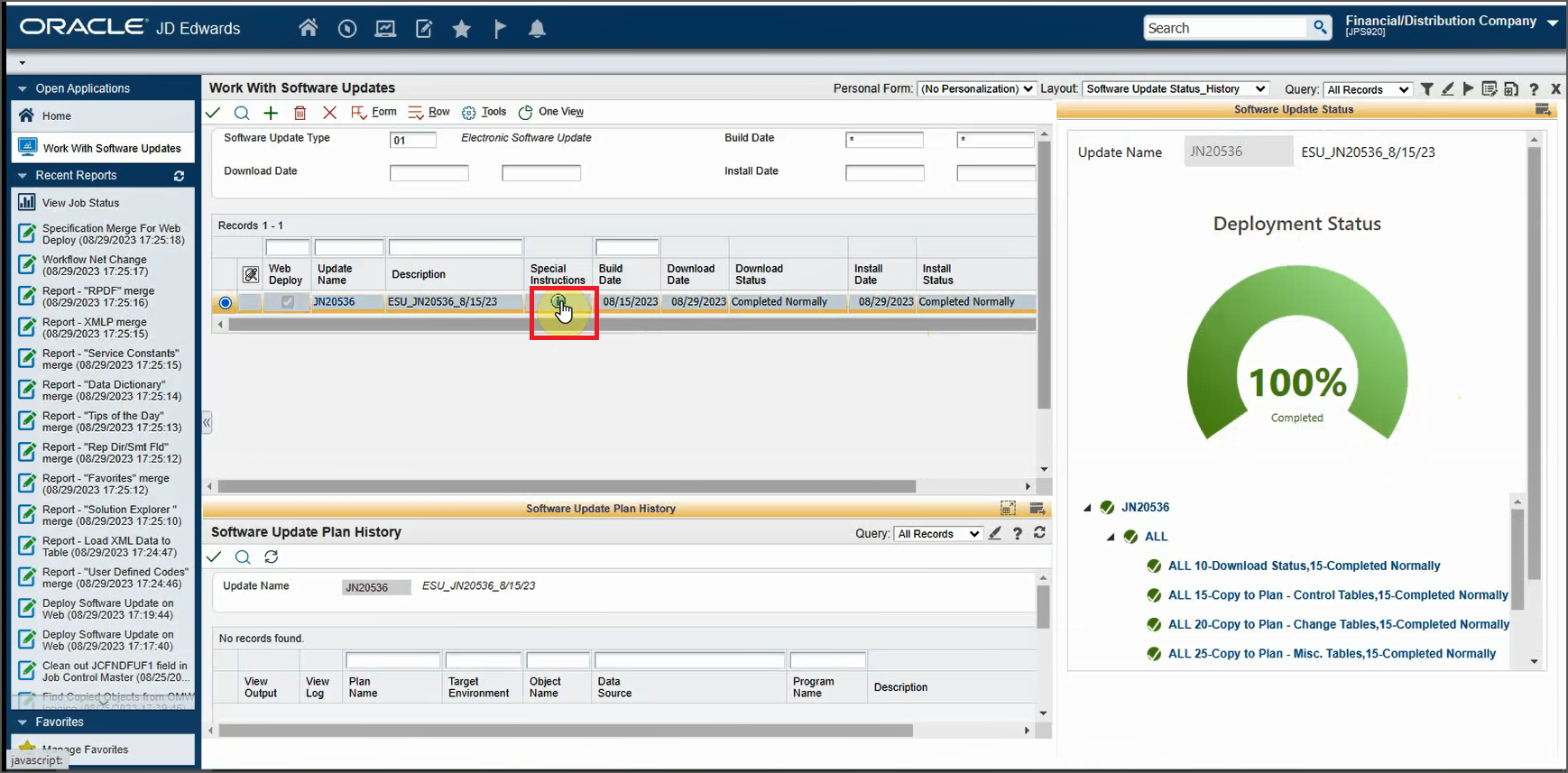

Work With Software Updates Form - Software Deployment Status Note: If the Software Update Status window does not appear, select Software Update Status History from the Layout drop-down menu.
- When the deployment process in 38% complete, click Find.
Work With Software Updates Form - Find Record - The Special Instructions icon appears in the grid for the
corresponding ESU. Click the Special Instructions icon to
access the Manage Special Instructions form.
Work With Software Updates Form - Special Instructions icon

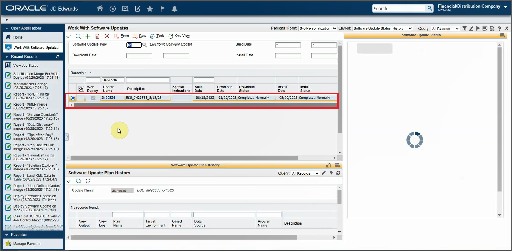

- From the Software Updates menu (GH9612), select Work with Software Update application (P96470W). The Work with Software Updates form is displayed.
- Click Find.

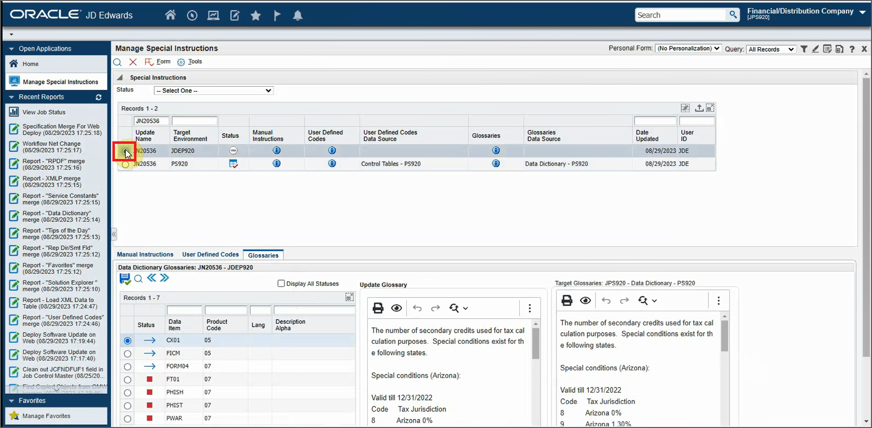

Work With Software Updates Form - Find Record - In the records grid, click the Special Instructions
icon in the row corresponding to the ESU that you imported.

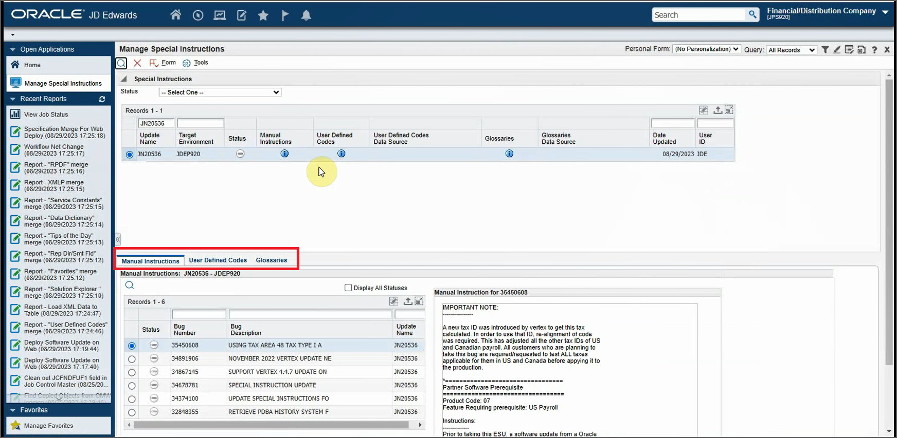

Work With Software Updates Form - Special Instructions Icon The Manage Special Instructions form is displayed. The
JDEP920staging environment is created with the record of the ESU. The Manual Instructions, User Defined Codes, and Glossaries from the selected ESU package are displayed in the corresponding tabs, in the lower pane of the Manage Special Instructions form.

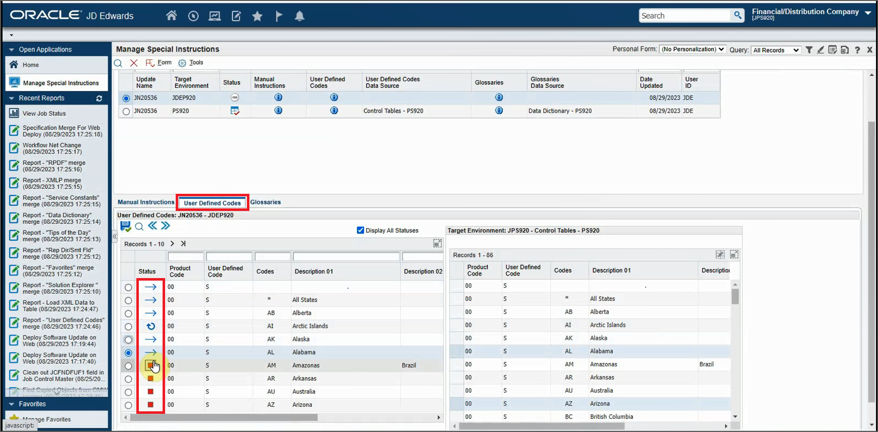

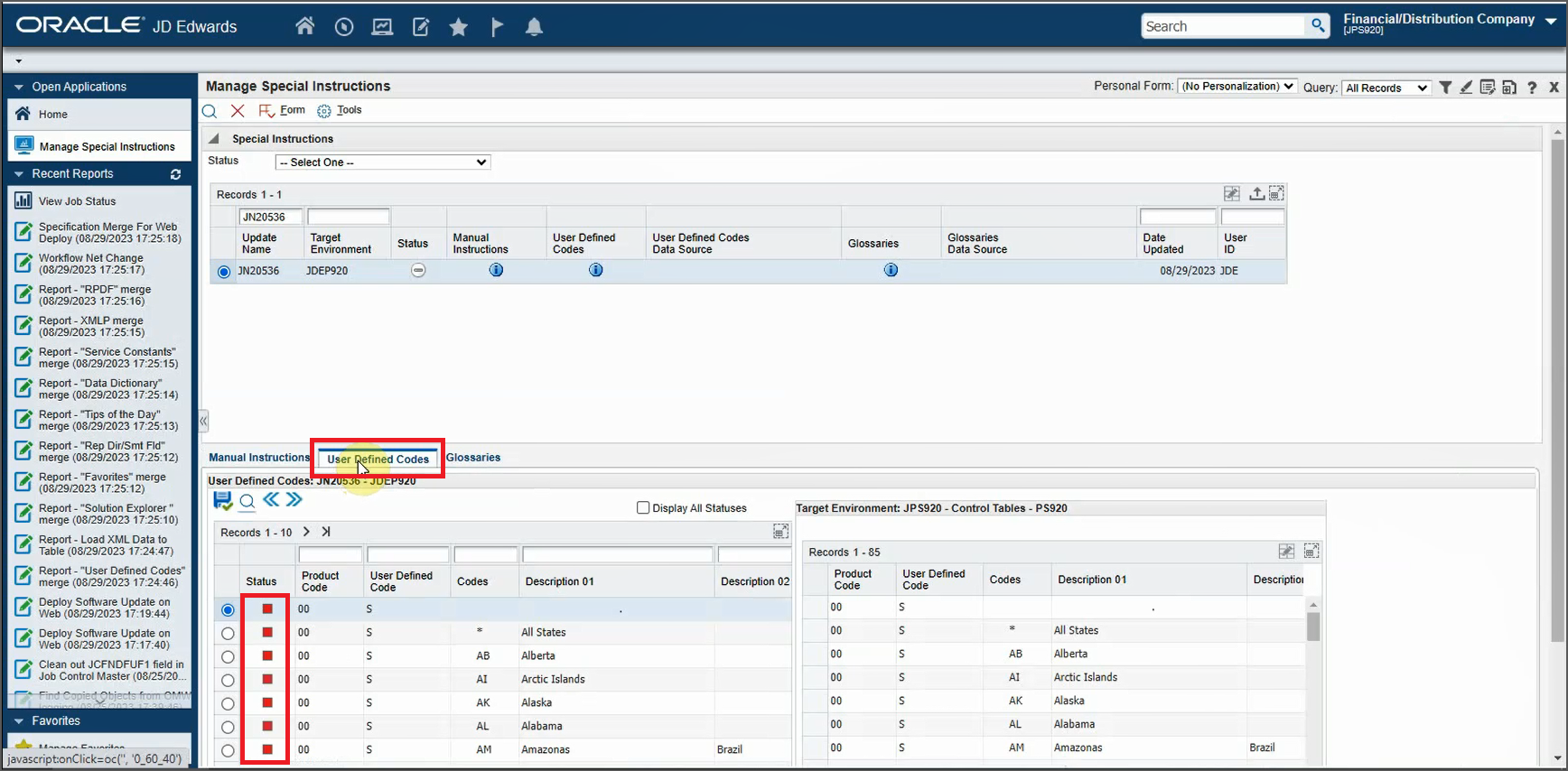

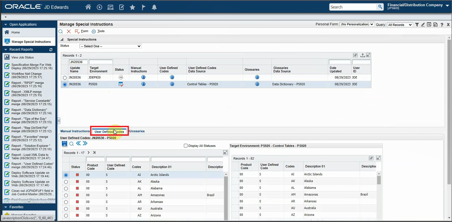

Manage Special Instructions Form - Staging Environment Record - To make staged edits for UDCs in the staging
environment (
JDEP920): - Click
the User Defined Codes tab.
The available UDCs are listed by product code in the grid
with their status set to Not Applied
Manage Special Instructions Form - User-Defined Codes Tab - Review
and set the Status of each of the required UDCs to Applied
. These changes will be
applied automatically during the deployment process.
Note: To skip applying a UDC, set the status of the UDC to Skipped.

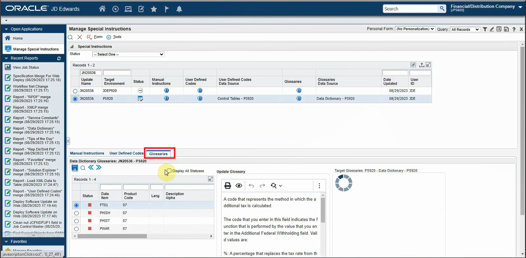

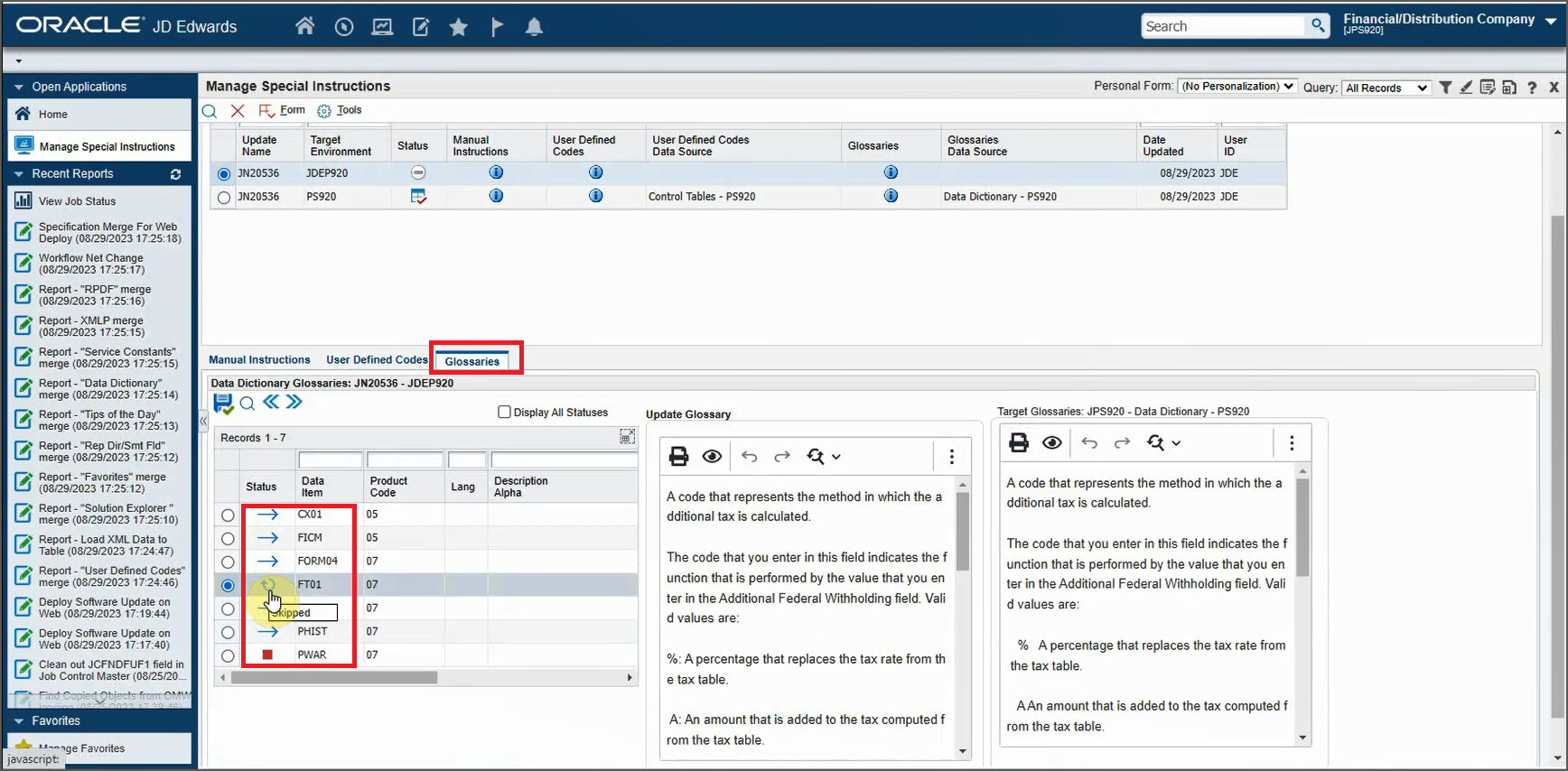

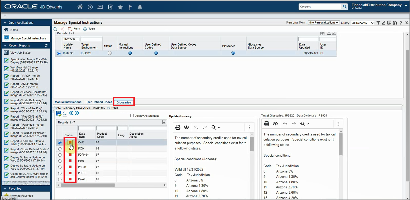

Manage Special Instructions Form - User-Defined Codes Status Update - To make staged edits for glossaries in the
staging environment (
JDEP920): - Click
the Glossaries tab. The available
glossaries are listed by product code in the grid with their

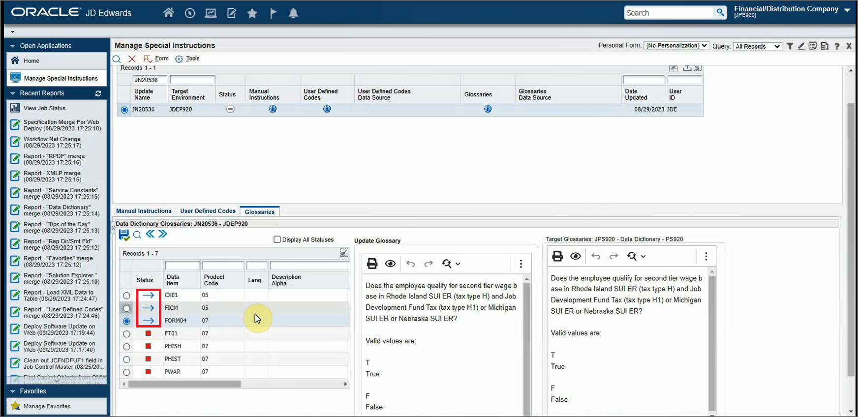

Manage Special Instructions Form - Glossaries Tab - Review
and set the Status of each of the required glossaries to Applied
. These changes
will be applied automatically during the deployment process.
Manage Special Instructions Form - Glossaries Status Update Note: To skip applying a UDC, set the status of the UDC to Skipped.

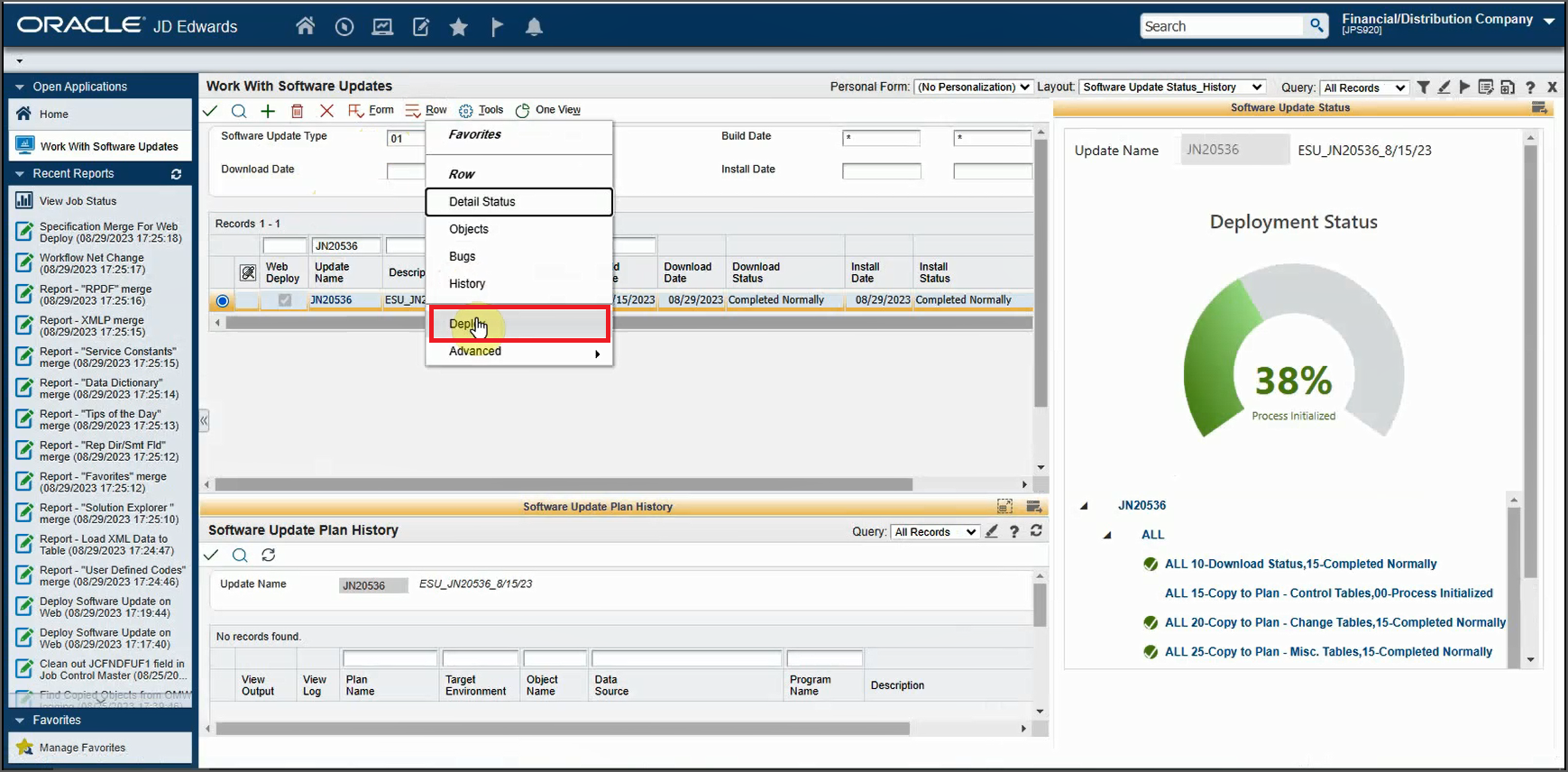

- In the Work With Software Updates form
(P96470W), select the ESU and click Row Exit,
Deploy.

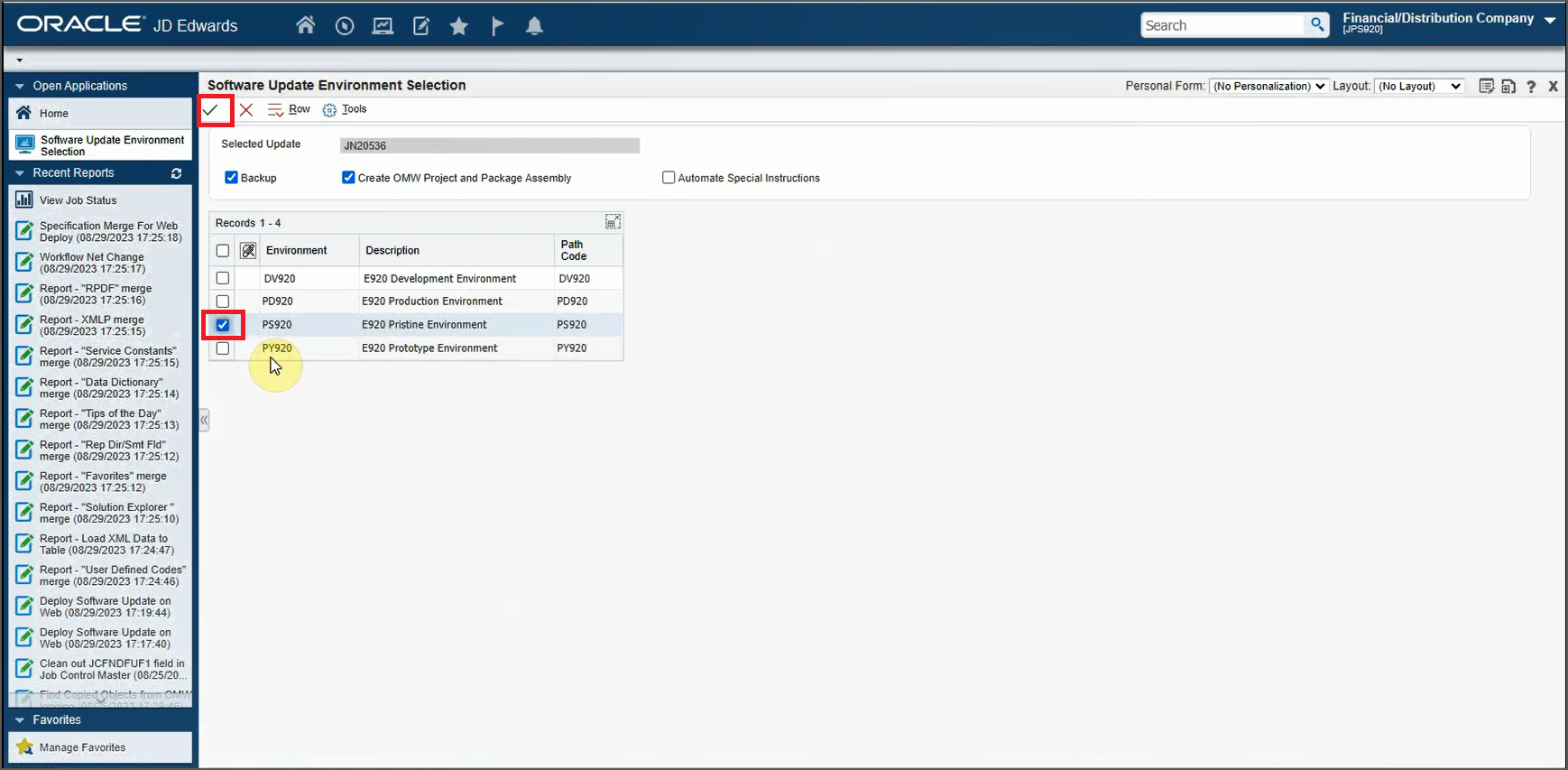

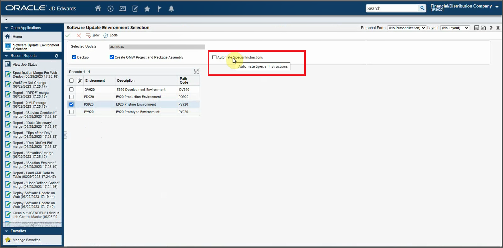

Work With Software Updates Form - Deploy Option - In the Software Update Environment Selection
form, select the target environment.
Software Update Environment Selection Form - If you have made staging edits detailed in the Applying
UDC and DD Glossary Changes to the Environment
section above and only want those changes to be deployed,
deselect the Automate Special Instructions
option.
Note: To apply all the special instructions from JD Edwards, select the Automate Special Instructions option.

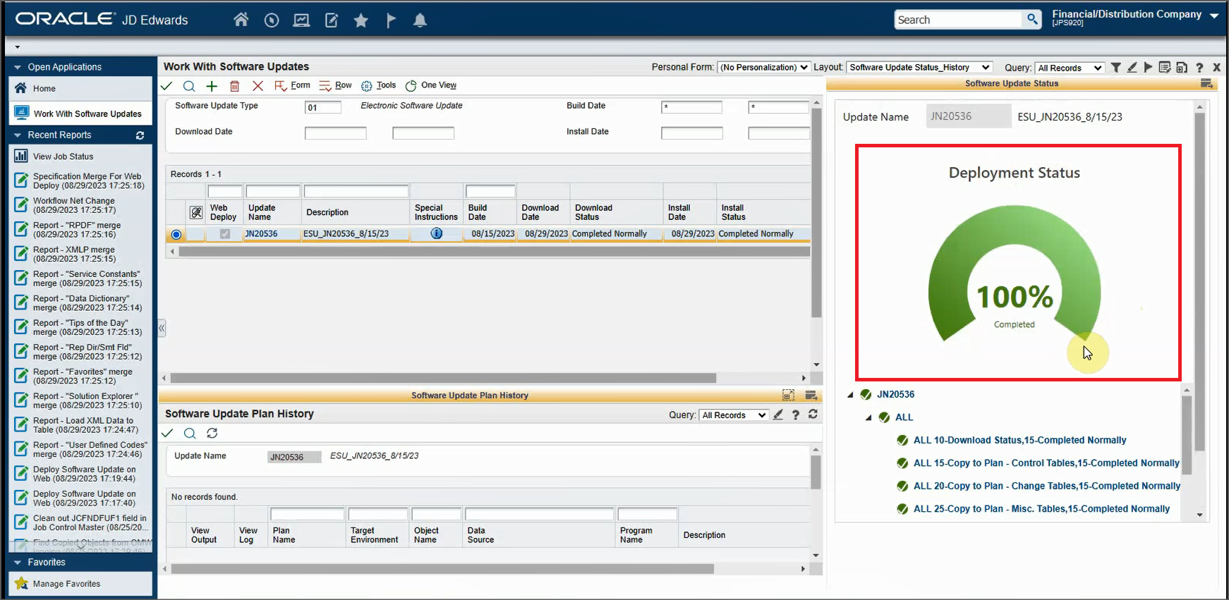

Software Update Environment Selection Form -Automate Special Instructions Option - Click OK. The system initiates the
deployment process. The Software Updates Status
pane on the Work With Software Updates form
shows the percentage of progress. On completion of deployment,
the 100% completion status is displayed.

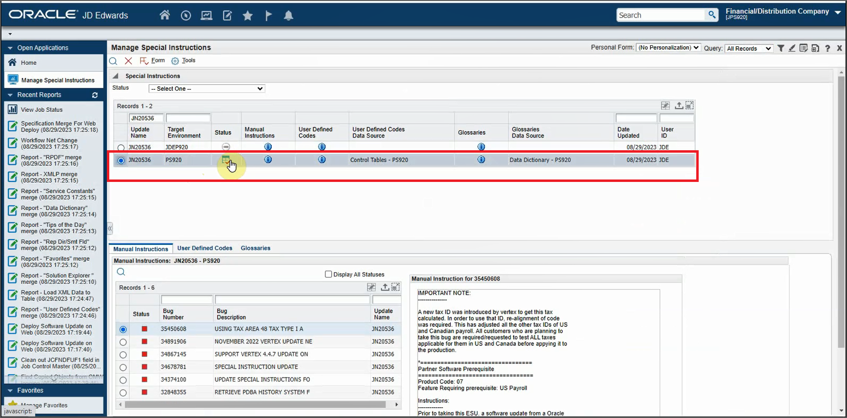

Work With Software Updates Form - Deployment Completion Status - After the deployment is completed, click the Special
Instruction icon corresponding to the staging environment
JDEP920, in the records grid.

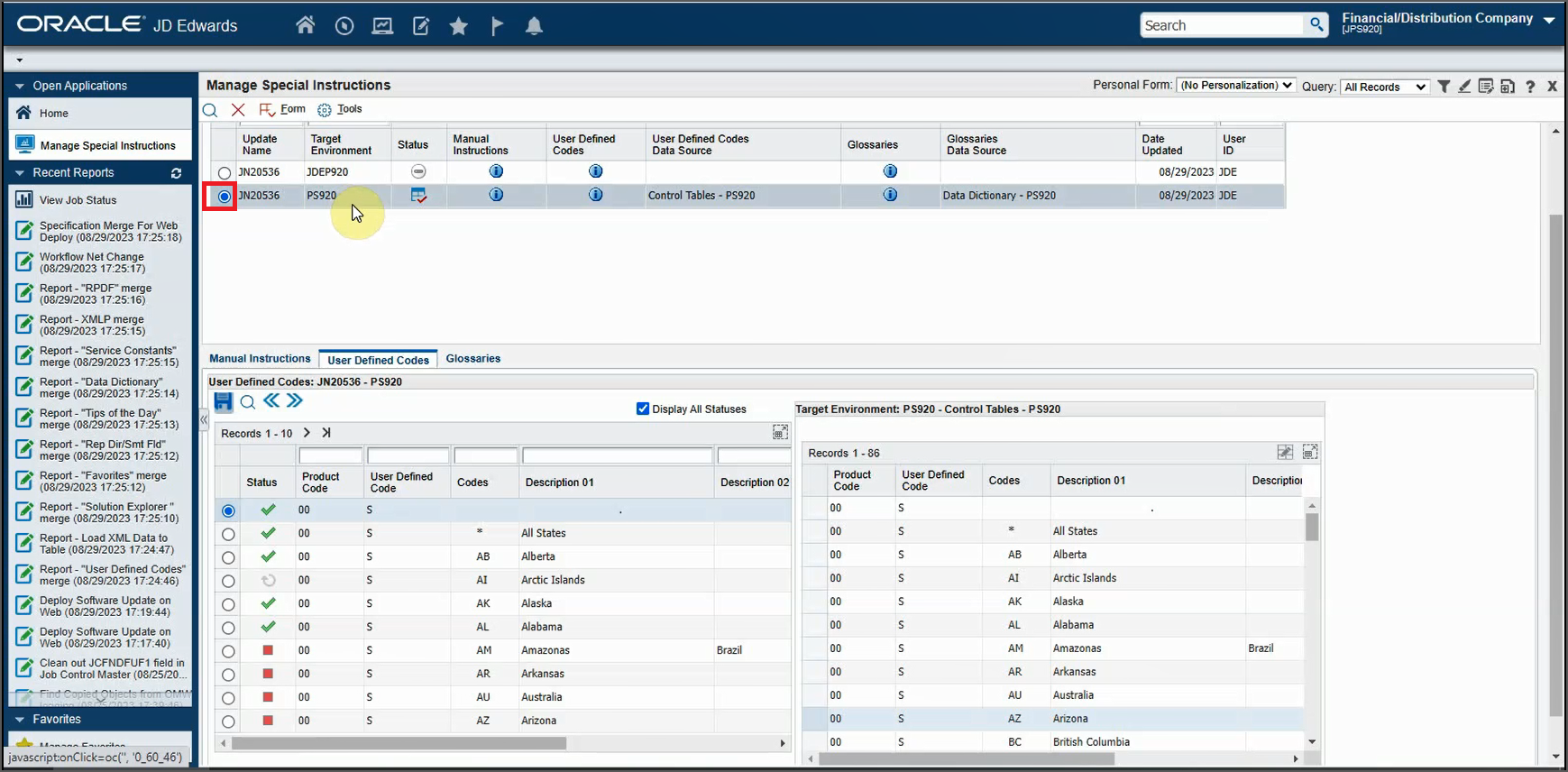

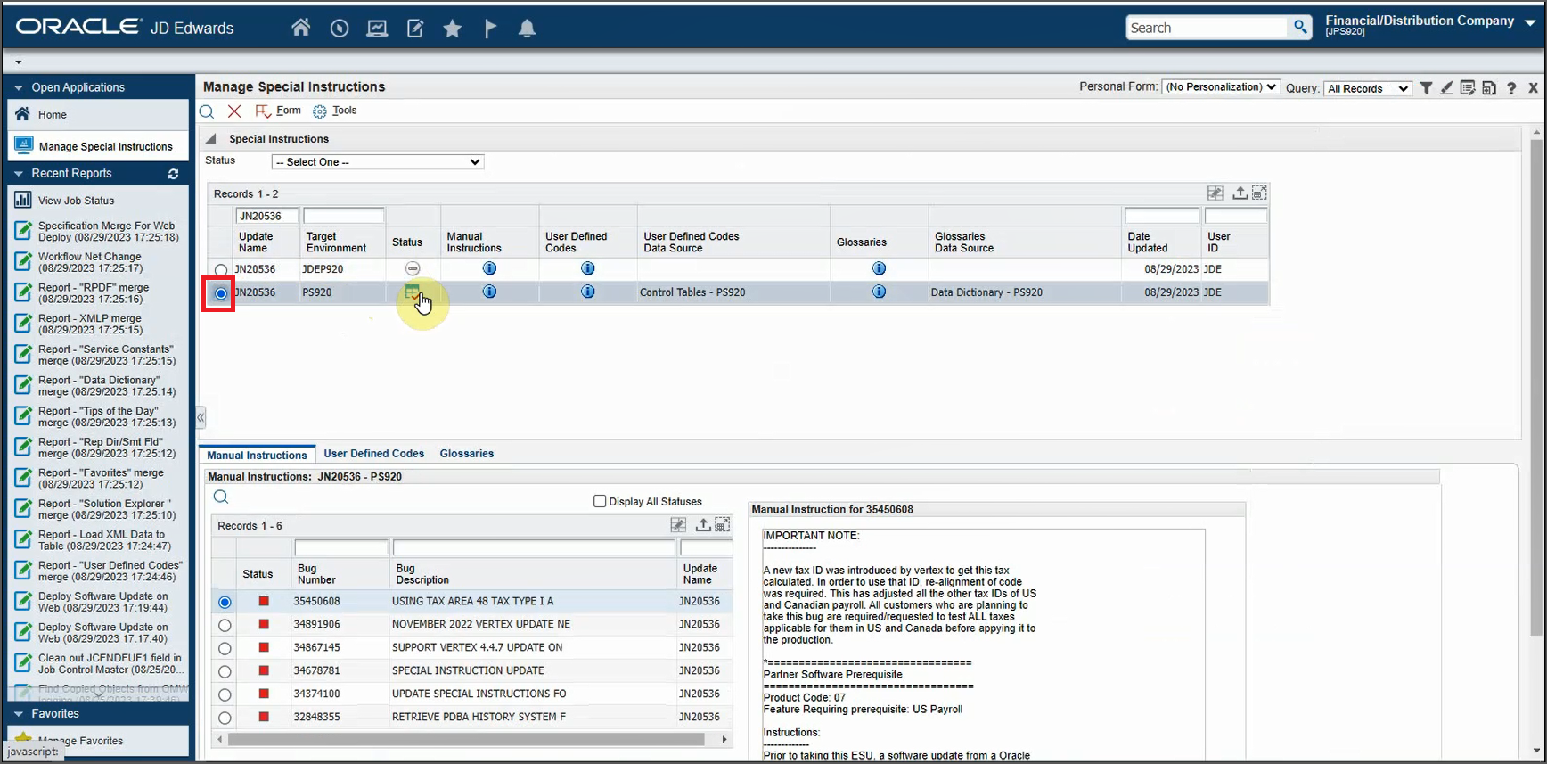

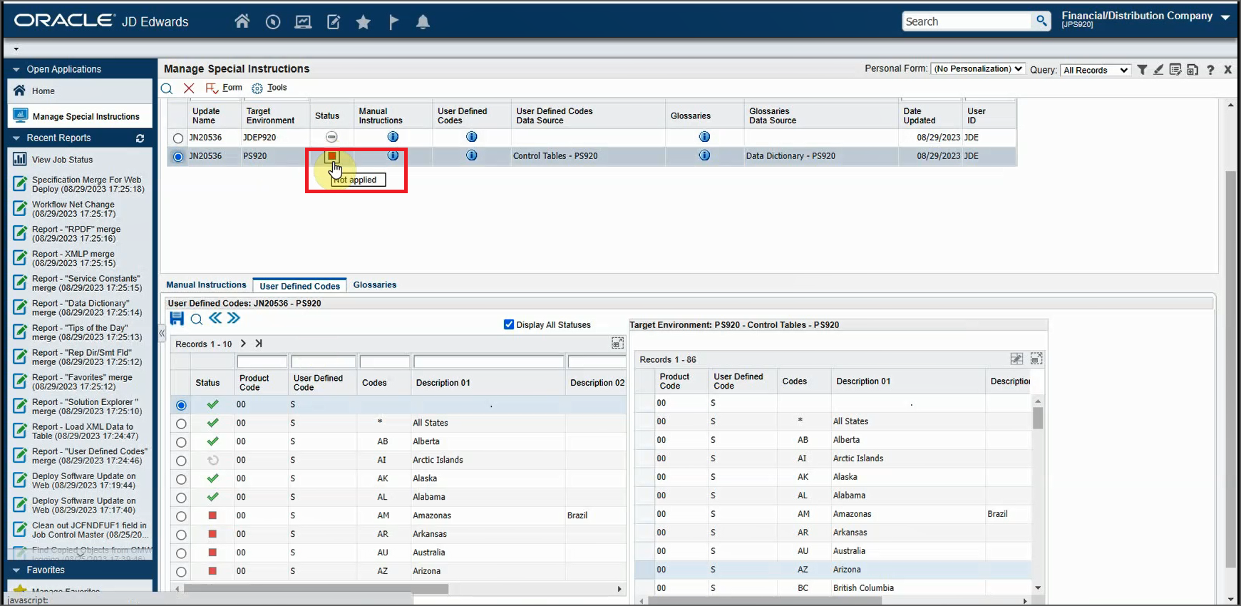

Work With Software Updates Form - Special Instructions Icon - The Manage Special Instruction form displays the ESU with
PS920in the Records grid. The Status of the target environment is set to Applied

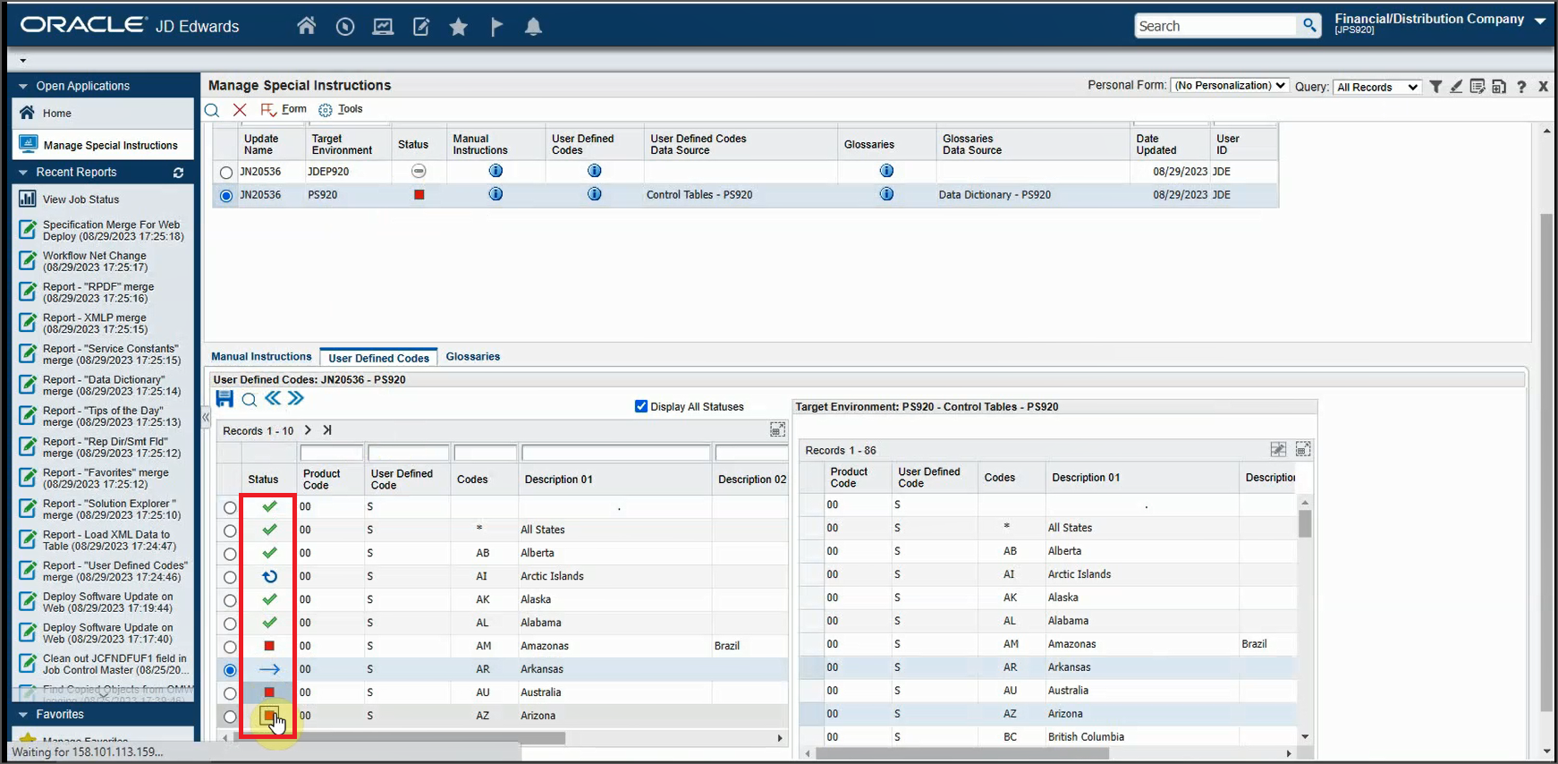

Manage Special Instructions Form - Target Environment Record - Select the target environment (example
PS920) in the grid and review the UDC and DD Glossary changes in the lower pane of the form.
Manage Special Instructions Form - Target Environment Selection - To
review the applied UDCs, click the User Defined
Codes tab.
Manage Special Instructions Form - User-Defined Codes Tab - Select
Display All Statuses option to view all the
UDCs. The status of the applied UDCs is replaced with a
check mark in the grid.

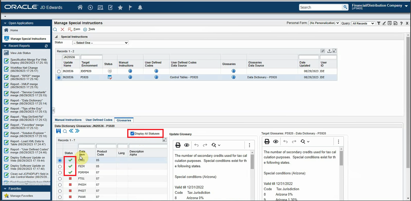

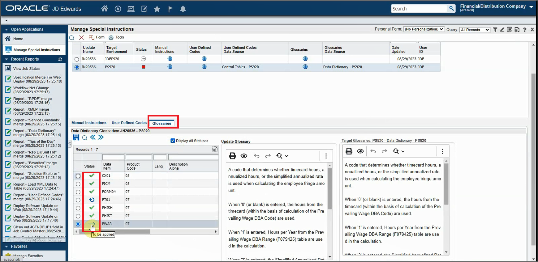

Manage Special Instructions Form - User-Defined Codes Tab Display All Statuses Option - To
review the applied DD glossaries, click the Glossaries
tab.
Manage Special Instructions Form - Glossaries Tab - Select
glossaries. The status of the applied glossaries is replaced
with a check mark in the grid.

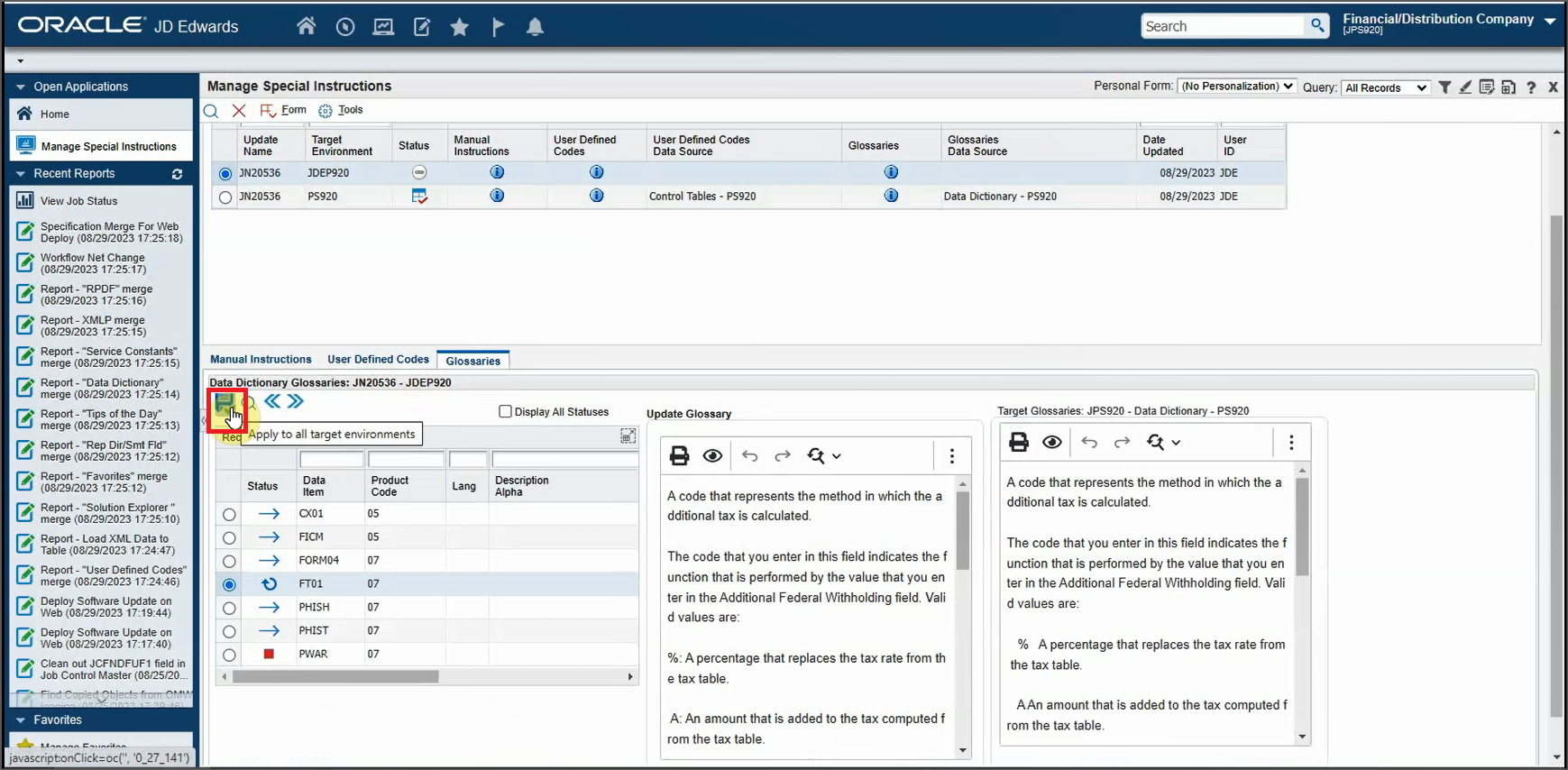

the Glossaries tab, edit the status of
the DD glossary items as required.
Manage Special Instructions Form - Glossaries Tab - Click
Apply to all target environments (Save
icon) in the Glossaries tab.
Manage Special Instructions Form - Glossaries Tab (Apply to all target environments Option) - The status set for the UDC and DD Glossary items in the staging environment.

- To apply special instructions edits to a deployed target environment:
- Select
PS920) in the Manage Special Instructions records grid.
Manage Special Instructions Form - Target Deployed Environment - Click
the Status of the selected target environment to unlock the
editing status from Applied to Not Applied.

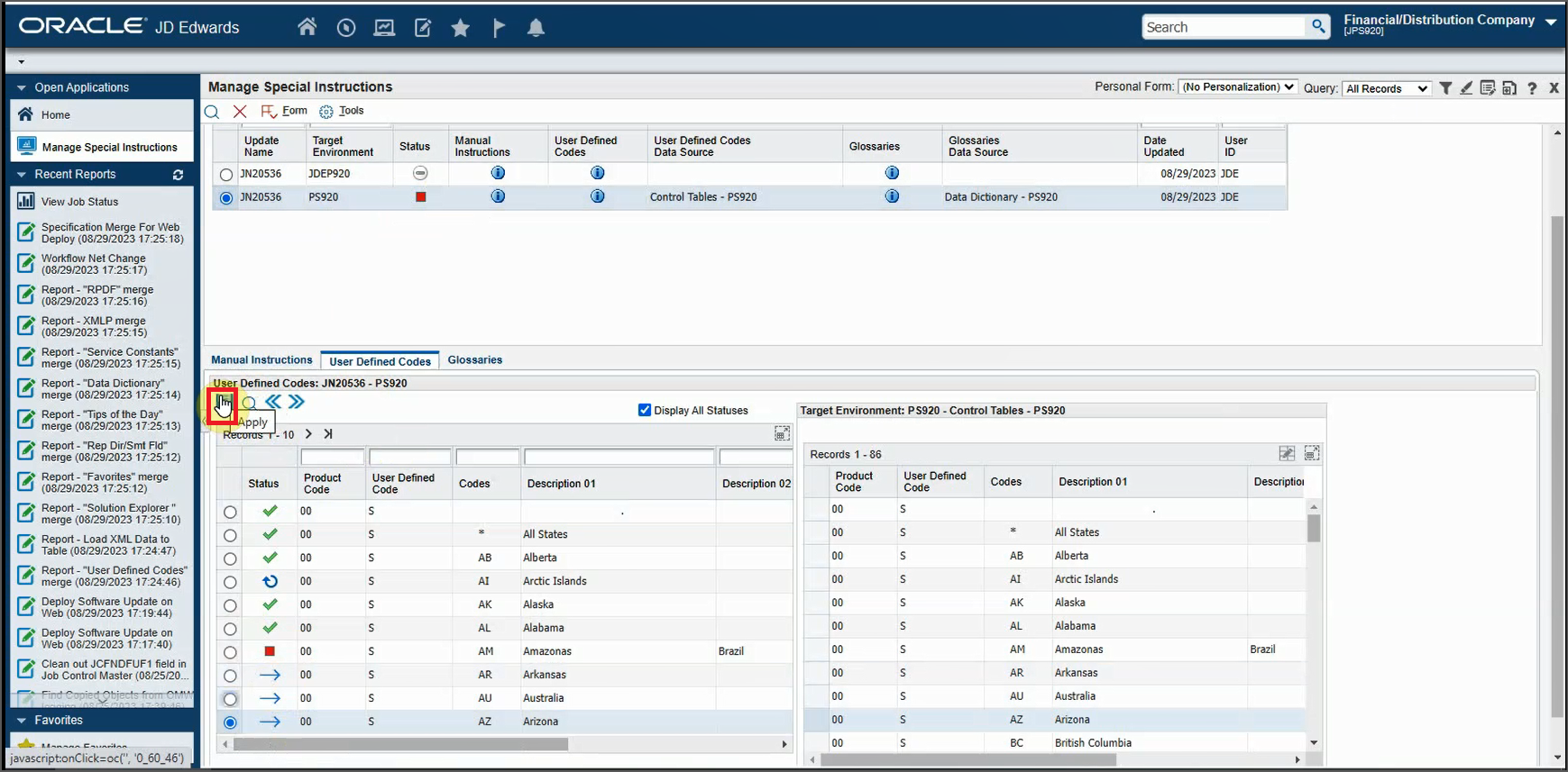

Manage Special Instructions Form - Target Deployed Environment Status Unlock Option - In
the User Defined Codes tab, click the
Status of the UDCs to make changes as required.
Manage Special Instructions Form - UDC Status Update in User-Defined Codes Tab - Click
Apply (Save icon) in the User
Defined Codes tab to apply the UDC changes to the
selected target environment (
PS920).
Manage Special Instructions Form - User-Defined Codes Tab (Apply to Selected Target Environment) - In
