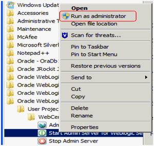

Alternatively, you also can start the WebLogic Admin Console from Windows Start > All Programs Menu.
  1. Select your domain from this directory:
    ORACLE_HOME\user_projects\<your_domain>\
  2. Locate the WebLogic Admin Console and execute it with Run as Administrator option.
    A sample screen is shown below:
    This image is described in surrounding text.
