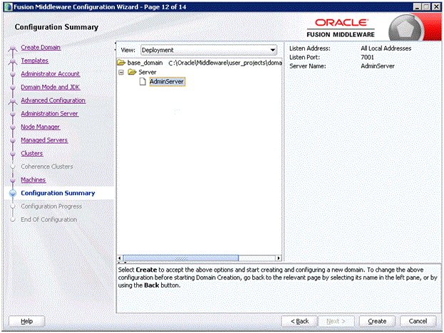

  21. On Configuration Summary, review your selections.
  22. Click the Create button.
