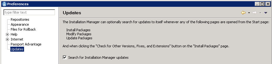

IBMIMexecutable..Open the Preferences of the IBM Installation Manager.
                Highlight the Updates node and select this checkbox:
Search for Installation Manager Updates

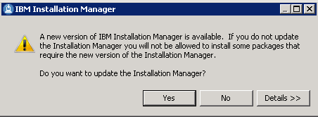

Log in to the Installation Manager and you will be prompted if a new version of Installation Manager is available.
                On IBM Installation Manager, click the Yes button and follow the installation wizard to complete the upgrade.
