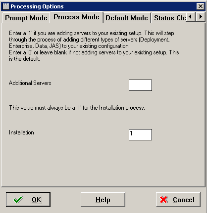

Specifying the Process Mode
To specify the process mode:
Select the Process Mode tab.
On the Process Mode tab, select the options for the processes that you want to run when you create your plan:
Additional Servers
Enter 1 to add servers to your existing setup (Deployment Server, Enterprise Server, Database Server, HTML Web Server). Enter 0 or leave blank for regular plans.
Installation
Enter 1 to run the JD Edwards EnterpriseOne installation automatically.
